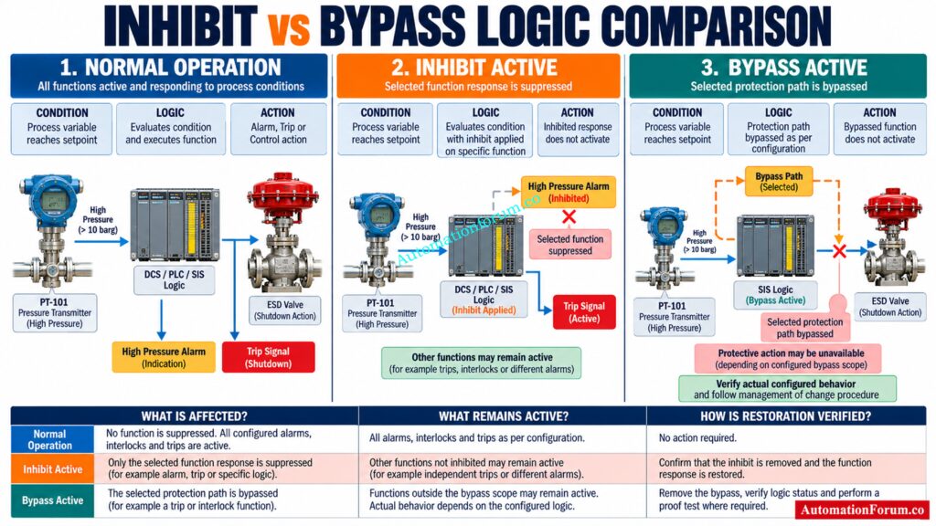

How Inhibit and Bypass Work in Control Logic
A pressure transmitter detects high high pressure. The configured logic evaluates the signal and initiates the required shutdown when the defined trip conditions are met.
Master Voting Decisions That Can Make or Break Plant Safety: 2oo3 Voting Logic Explained: How it Works, Why it is Used and Where it Applies
A startup condition can turn off a specific low flow warning as the pump is accelerating. The engineer must ensure that the inhibit is for the desired alarm and duration of operation only. Any independent trip or protection function will continue to perform as intended unless otherwise changed by a separately evaluated and approved change.
Build a Strong Shutdown Strategy Before Costly Engineering Mistakes: Shutdown Philosophy: Engineering Documentation for Process Safety and Emergency Shutdown Systems
A selected shutdown input is bypassed during an approved test. The associated shutdown action may no longer occur when that input demands it. The affected function must be clearly identified, monitored and managed under the applicable impairment procedure.
