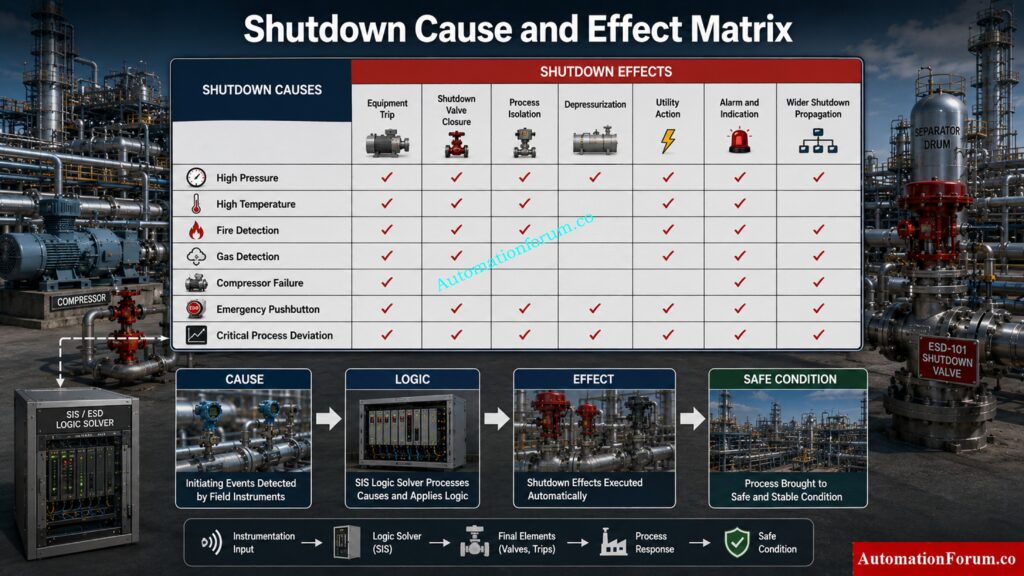

Shutdown Philosophy and Cause and Effect Matrix
The Shutdown Philosophy establishes the overall engineering intent for protecting the process, while the Cause and Effect Matrix converts that intent into specific initiating causes and resulting actions. Together, they provide the foundation for developing shutdown logic and verifying the required response.
From Shutdown Philosophy to Cause and Effect
Engineers identify the hazardous event, determine its potential consequence and select the appropriate shutdown level. The required protective action is then documented in the Cause and Effect Matrix.
Shutdown Causes and Shutdown Effects
Each cause is linked to defined effects such as equipment trips, process isolation, shutdown valve closure, utility actions or depressurization. This ensures that the intended response is clearly understood across engineering disciplines.
Shutdown Logic Development
The approved Cause and Effect is translated into shutdown logic within the appropriate control or safety system. The logic may include voting arrangements, time delays, permissives, startup inhibits, resets and feedback monitoring.
Shutdown Valve Actions
Shutdown valves provide important final isolation actions during a shutdown. Their required movement, fail safe position, solenoid arrangement and feedback requirements should be consistent with the approved shutdown strategy.
Shutdown Equipment Trips
The Cause and Effect identifies which pumps, compressors, fired equipment and other process equipment must stop for each applicable shutdown condition. Clear definition helps prevent both inadequate protection and unnecessary shutdown propagation.
Shutdown Logic Verification
The implemented logic must be checked against the approved Shutdown Philosophy and Cause and Effect Matrix. During commissioning and validation, engineers verify that the correct initiating signal produces the intended final action.

Develop the Cause and Effect
Document each initiating cause and its corresponding effects so that all disciplines have a common engineering reference.
Develop Shutdown Logic
Translate the approved Cause and Effect into control or safety system logic, including required voting, delays, permissives and resets.

What is a shutdown Cause and Effect Matrix?
A shutdown Cause and Effect Matrix defines the relationship between initiating conditions and the actions that must occur. It converts the engineering intent established in the Shutdown Philosophy into specific shutdown actions for detailed system design.
