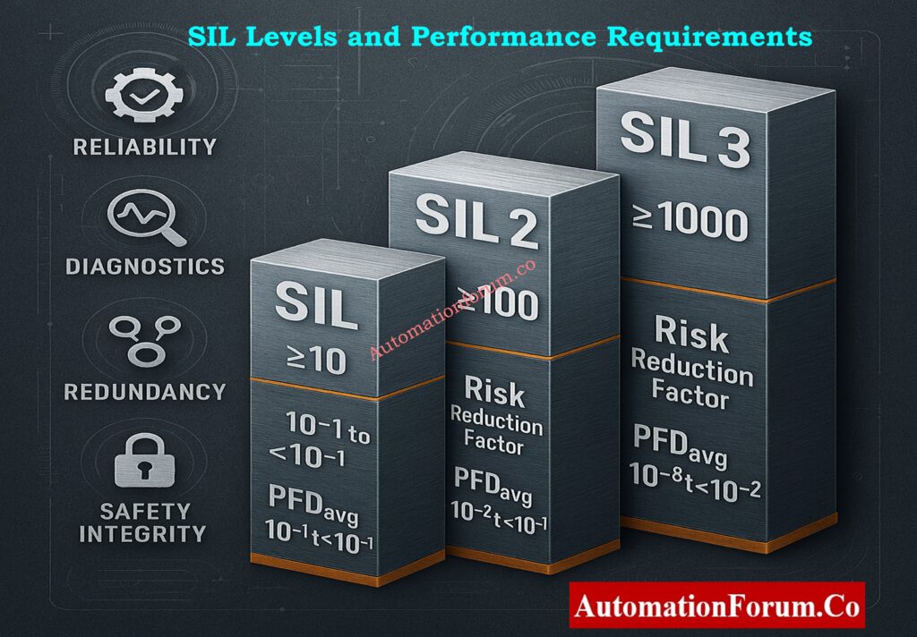

Safety Integrity Level (SIL)
The Safety Integrity Level quantifies how reliably a SIF must perform to reduce process risk.
SIL is categorized into four levels: SIL 1, SIL 2, SIL 3, and SIL 4. In the process industry, SIL 1 to SIL 3 are most common, while SIL 4 is extremely rare and applies mainly to nuclear installations.
Why SIL Matters
SIL tells you how well a safety feature needs to work. A higher SIL level suggests that the chance of a dangerous failure is lower and therefore diagnostics, redundancy, design, and proof testing must be done more strictly.
SIL Levels and Performance Requirements
| SIL Level | Risk Reduction Factor (RRF) | PFDavg Range (Low Demand) |
| SIL 1 | 10 to 100 | 10⁻¹ to 10⁻² |
| SIL 2 | 100 to 1,000 | 10⁻² to 10⁻³ |
| SIL 3 | 1,000 to 10,000 | 10⁻³ to 10⁻⁴ |
| SIL 4 | 10,000 to 100,000 | 10⁻⁴ to 10⁻⁵ |
Factors Considered in Assigning SIL
- Severity of failure consequences
- Frequency of initiating events
- How well the current protective layers work
- Average Probability of Failure on Demand (PFDavg)
- Coverage for diagnostics
- Requirements for hardware fault tolerance
- Times for maintenance and proof-testing
- Conditions in the environment and in the workplace
- Human factors and accessibility
SIL assignment makes sure that each SIF offers a level of protection that can be measured and is good enough.

What are the three types of SIL?
In the process industry, three SIL levels are used:
SIL 1 – Basic risk reduction
SIL 2 – Moderate risk reduction
SIL 3 – High risk reduction
(SIL 4 exists in IEC 61508 but is rarely applied outside nuclear or extreme-risk domains.)
