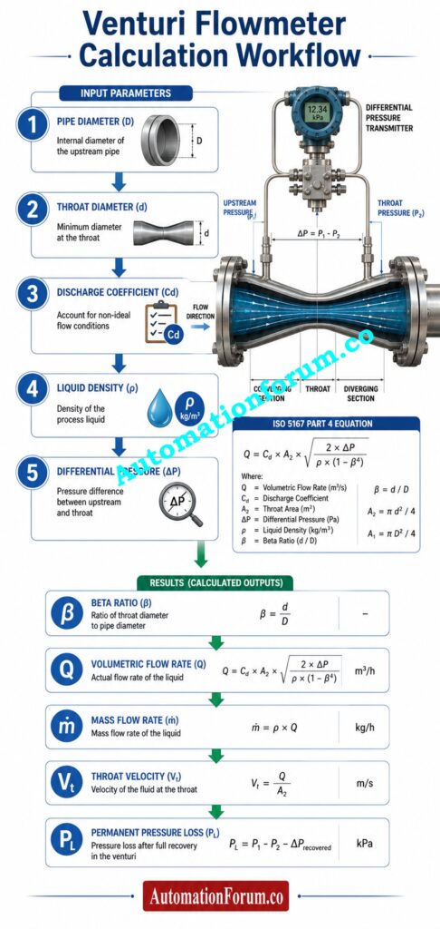

How the Venturi Flowmeter Calculator Works

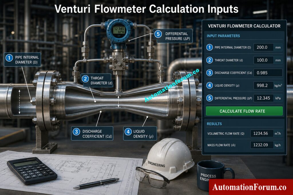

The Venturi Flowmeter Calculator performs a series of engineering calculations using five user supplied process parameters. These values are combined using the calculation principles defined in ISO 5167 Part 4 to estimate the hydraulic performance of the Venturi tube.
Rather than simply producing a flow value, the calculator evaluates several important operating characteristics that help engineers understand whether the selected Venturi tube is suitable for the application.
Step 1 Enter Pipe Internal Diameter
The first figure you enter in the calculator is the Pipe Internal Diameter.
This measurement is the actual interior diameter of the pipeline in which the Venturi tube is fitted. It also specifies the upstream flow region and is the basis for all further computations.

Step 2 Enter the Venturi Throat Diameter
The second input is the Venturi Throat Diameter .

Step 3 Enter the Discharge Coefficient
The Discharge Coefficient corrects the theoretical flow calculation to real fluid behaviour.

Step 4 Enter the Liquid Density
The next input is the Liquid Density expressed in kilograms per cubic metre.

Step 5 Enter the Differential Pressure
The last input is the Differential Pressure between the upstream pressure tapping, and the throat pressure tapping.

Based on the calculation principles of ISO 5167 Part 4, the Venturi Flowmeter Calculator provides engineers with the ability to input precise process data, and to generate reliable preliminary sizing findings that can support equipment selection, commissioning and process evaluation.
Understanding Every Result Produced by the Venturi Flowmeter Calculator
By entering all the essential process inputs, the Venturi Flowmeter Calculator automatically produces five important engineering characteristics which help to evaluate both the hydraulic performance of the Venturi tube and its suitability for the application. The results give useful data in equipment sizing, process design, commissioning, troubleshooting and normal plant operation. The calculator calculates these numbers in accordance with the mathematical principles defined in ISO 5167 Part 4.
Beta Ratio
The first computed value is the Beta Ratio (β), which is the ratio between the Venturi throat diameter and the pipe internal diameter.
Formula
β = d ÷ D

- The calculation begins with the Continuity Equation, which says that the flow into the Venturi tube must match the flow out of the Venturi tube.
- Inside the throat the flow area is reduced and so the liquid velocity is increased.
- The calculator then uses the Bernoulli Equation to relate the velocity and pressure .
- Static pressure falls as velocity rises.
