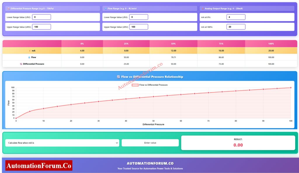

📊 Calculating flow based on values of differential pressure
The following calculator assumes that the flow is in linear with the output mA signal and non-linear with differential pressure. The results are in the same units as is your data input in the following fields.
| 0% | 25% | 50% | 75% | 100% | |
| ⚡ mA | 4.00 | 8.00 | 12.00 | 16.00 | 20.00 |
| 💧 Flow | 0.00 | 50.00 | 70.71 | 86.60 | 100.00 |
| 📉 Differential Pressure | 0.00 | 25.00 | 50.00 | 75.00 | 100.00 |
📈 Flow vs Differential Pressure Relationship

Dynamic Flow vs Differential Pressure Chart
The Chart that is all together.The JavaScript graph shows a real-time curve that shows how the square root of the difference between pressure and flow changes.
The curve clearly shows that flow grows quickly toward the upper range when DP is between 0 and 100%. This helps engineers understand how sensitive a control loop is and how accurate scaling is.

Comprehensive Output and Conversion Modes
After you put in the right numbers, the calculator makes a table that shows the calculated results for important percentages (0%, 25%, 50%, 75%, 100%) for
- Differential Pressure (DP)
- Flow Rate
- Analog Signal (mA)
The quick table lets engineers check transmitter calibration, DCS scaling, or control valve characterization in seconds, so they don’t have to do square-root calculations by hand or use spreadsheet templates.
