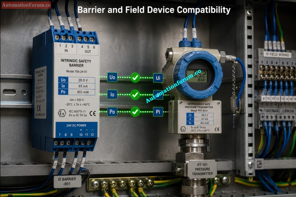

Intrinsic Safety Entity Parameter Verification for Hazardous Area Instrumentation
Designing an intrinsically safe instrumentation loop involves much more than selecting a certified field instrument and connecting it to a safety barrier.All parts of the loop, including the accompanying equipment, field device, and interconnecting cable, must operate in unison without contributing enough electrical energy to create a hazardous environment. This verification process is one of the most important engineering activities during the design, installation, and commissioning of hazardous area instrumentation systems.
An Intrinsic Safety Entity Parameter Calculator simplifies this verification by comparing the electrical characteristics of the safety barrier or galvanic isolator with those of the connected field device while also considering the effect of cable capacitance and inductance. This enables engineers to quickly assess whether the suggested loop is consistent with the entity concept criteria, without having to perform several manual computations, prior to installation. The calculator you uploaded will do these comparisons automatically . Voltage , current , power , capacitance and inductance checks . It will give you a compatibility judgment depending on the values you entered .
Engineering calculators reduce computation time, human errors and increase design consistency.
What is an Intrinsic Safety Entity Parameter Calculator?
An Intrinsic Safety Entity Parameter Calculator is an engineering design tool used to verify whether a hazardous area field device can be safely connected to an intrinsically safe barrier or galvanic isolator using the Entity Concept defined by international intrinsic safety standards.
The Entity Concept is based on a simple engineering principle. Every associated apparatus has maximum electrical output limits, while every intrinsically safe field device has maximum electrical input limits. A safe installation exists only when the output capability of the associated apparatus never exceeds what the field device can safely withstand.
The verification process does not stop with voltage, current, and power. Engineers must also evaluate the total capacitance and inductance of the complete loop because stored electrical energy in cables and field devices can become an ignition source under fault conditions. Even when the barrier and transmitter appear individually compatible, excessive cable capacitance or inductance can invalidate the installation.
Modern engineering calculators automate these comparisons translating engineering units, calculating cable reactance, aggregating cable and field device characteristics and evaluating each of the entity requirements against the permitted limits before delivering a compatible or not compatible answer. This approach significantly reduces engineering effort while improving calculation accuracy.

Entity Parameter Compatibility Checks
After the calculations, the calculator checks the five entity parameter criteria that are required.
Voltage Compatibility
Uo ≤ Ui
If this condition is violated, the field device could receive more voltage than its certified safe limit.
Current Compatibility
The maximum short circuit current supplied by the associated apparatus must remain below the maximum input current of the field device.
Io ≤ Ii
This ensures that excessive fault current cannot reach the hazardous area equipment.
Power Compatibility
The maximum available output power of the barrier or galvanic isolator must not exceed the certified input power of the field device.
Po ≤ Pi
Power verification is an additional safety check on top of voltage and current.
