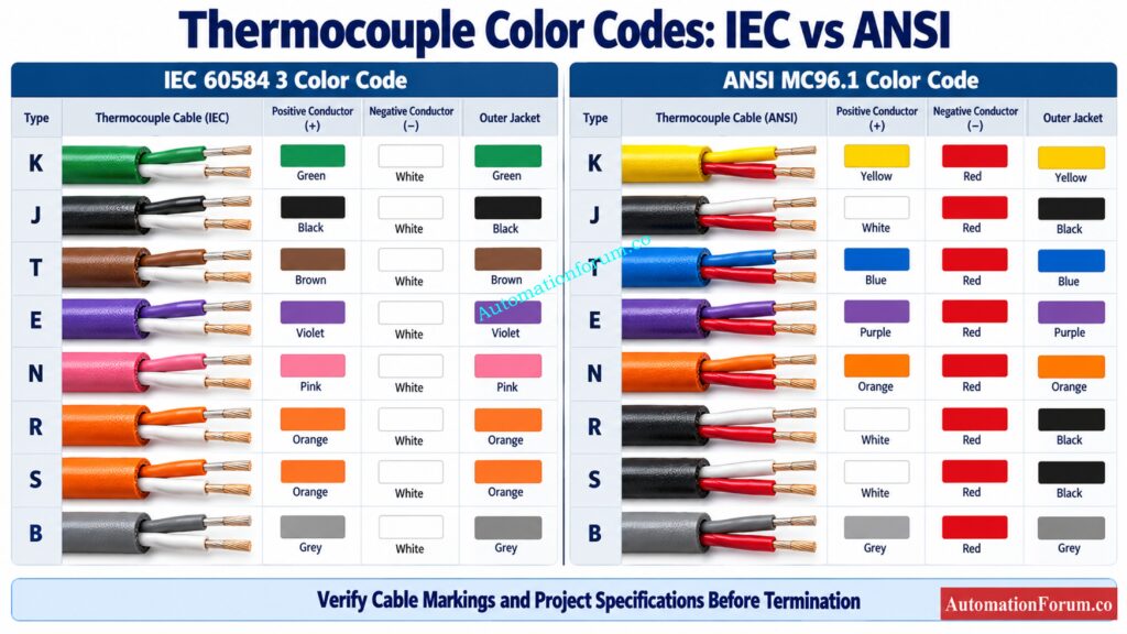

Why Thermocouple Wire Color and Polarity Matter
Thermocouple extension cables use specific conductor materials and identification systems. Correct identification helps prevent wiring errors during installation, junction box termination, panel wiring, and instrument replacement.
Prevent Commissioning Delays With This Essential Thermocouple Checklist: Thermocouple Commissioning Checklist
The calculator provides two color reference options.
- Under the IEC color convention represented by the calculator, the negative conductor is white. The positive conductor and outer jacket use the identifying color associated with the thermocouple type.
- Under the ANSI color convention represented by the calculator, the negative conductor is red. The positive conductor and outer jacket colors depend on the selected type.
For example, the calculator displays a green positive conductor and white negative conductor for Type K under its IEC selection. Under its ANSI selection, Type K uses yellow for positive and red for negative.
Color conventions can vary according to the applicable standard, cable construction, manufacturer, and installation requirements. Always verify the cable markings and project specifications before making a termination. Never identify an unknown thermocouple solely by its insulation color.

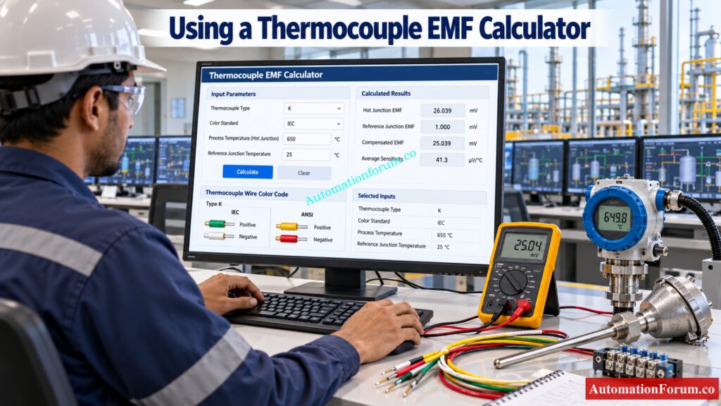

How to Use the Thermocouple EMF Calculator
The calculator requires a thermocouple type, a color standard, a process temperature, and a reference junction temperature.
Step 1: Select the thermocouple type
Choose type K, J, T, E, N, R, S or B according to the configuration of the sensor and transmitter installed. Each thermocouple has various voltage vs temperature characteristics and the suitable type must be selected.
Improve Measurement Accuracy With Proper Transmitter Calibration Techniques: How to calibrate Thermocouple Transmitter?
Step 2: Select the color standard
International color reference: IEC 60584 3 North American color reference: ANSI MC96.1 Refer to the real cable documentation for the colors to use when terminating fields.
Step 3: Enter the process temperature
Enter the temperature of the measuring junction (in °C). This is the hot junction temperature the calculator uses.
Step 4: Enter the reference junction temperature
Follow These Eight Calibration Steps For Reliable Temperature Measurements: 8 Steps Calibration Procedure for Thermocouple
Step 5: Calculate the EMF
Choose Calculate EMF. The calculator shows the estimated compensated EMF, hot junction EMF, reference junction EMF, average sensitivity, and the steps of the computation.
Master Safe Thermocouple Replacement With This Proven Field Procedure: Faulty Thermocouple Replacement Procedure in Process Area: Complete Step-by-Step Field Guide for Instrumentation Engineers

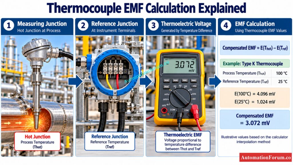

Thermocouple EMF Calculation Formula
The calculator uses the following relationship to predict the thermocouple EMF:
Compensated EMF = E(Thot) − E(Tref)
Where:
- E(Thot) is the thermoelectric voltage predicted at the process temperature.
- E(Tref) is the thermoelectric voltage at the reference junction temperature.
- Thot is the temperature of the process in °C.
- Tref is the reference junction temperature in degrees Celsius.
The calculator uses representative temperature and EMF reference points with linear interpolation between adjacent points. This method provides a quick estimate, but it is not equivalent to evaluating the complete official NIST ITS 90 reference functions.
Average sensitivity is calculated as:
Average sensitivity = [E(Thot) − E(Tref)] ÷ (Thot − Tref)
The result is expressed in microvolts per degree Celsius. Sensitivity is not calculated when the temperature difference is zero.
Avoid Costly Wiring Mistakes With These Thermocouple Cable Selection Rules: Thermocouple Wire vs. Thermocouple Extension Wire: The Complete Guide for Instrumentation Engineers
Type K Thermocouple EMF Calculation Example
Consider a Type K thermocouple connected to a temperature transmitter in an industrial process.
- Process temperature = 100°C
- Reference junction temperature = 25°C
From the representative values used by the calculator, the estimated Type K EMF at 100°C is 4.096 mV.
At 25°C, linear interpolation between the 0°C and 100°C reference points gives an estimated EMF of 1.024 mV.
Therefore:
- Compensated EMF = 4.096 − 1.024
- Estimated compensated EMF = 3.072 mV
- The temperature difference is 75°C.
- Average sensitivity = 3.072 ÷ 75 × 1000
- Average sensitivity = 40.96 µV/°C
These values illustrate the calculator’s implemented interpolation method. They are estimates rather than certified calibration values.
