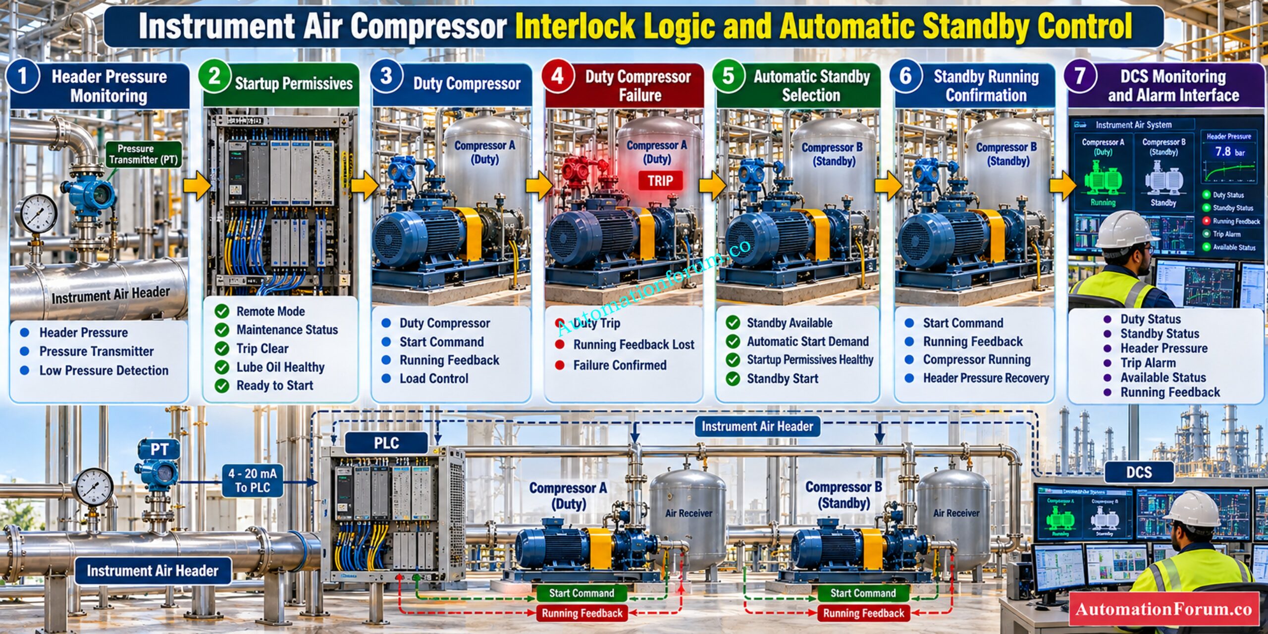

Instrument air compressors are critical utility equipment controlled through PLC based sequencing, pressure instrumentation, permissives, alarms, trips and automatic standby selection. For automation and instrumentation professionals, understanding this logic is essential for DCS configuration, PLC programming, control panel integration, FAT, SAT, commissioning and troubleshooting. A well designed instrument air compressor control system must correctly interpret header pressure, compressor availability, running feedback, protective trips and operating modes. This quiz focuses on practical automation situations involving duty and standby selection, pressure control, startup permissives, compressor package interfaces, timers, signal failures, sequence logic and DCS indication. The questions are designed to test engineering judgement rather than simple definitions.
Advanced Instrument Air Compressor Interlock Logic and Control Quiz for Automation and Instrumentation Professionals
This advanced Instrument Air Compressor Interlock Logic Quiz challenges automation, instrumentation and control professionals to interpret compressor logic as it behaves in an actual plant automation system. Analyze pressure signals, permissives, interlocks, trips, timers, latches, running feedback, package PLC interfaces, DCS commands and automatic changeover conditions before selecting an answer. The scenarios reflect design review, PLC configuration, FAT, SAT, commissioning and troubleshooting activities. Focus on the actual control response rather than the equipment description. Each question is designed to test how effectively you can trace a control signal from field instrumentation through PLC logic and finally to compressor operation.
