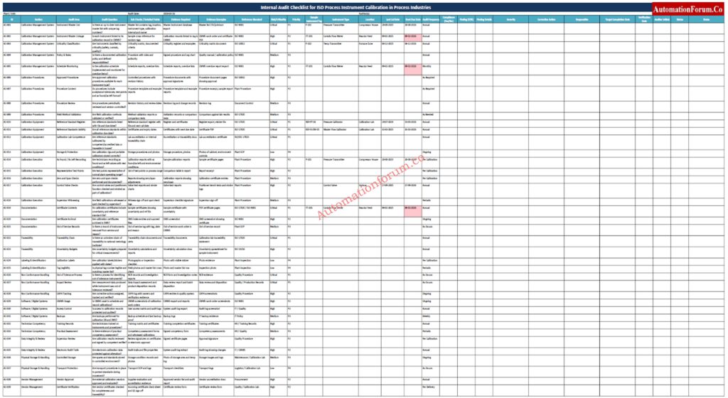

- Internal Audit Checklist for Instrument Calibration in Process Industries
- Download Internal Audit Checklist for ISO Process Instrument Calibration (Excel)

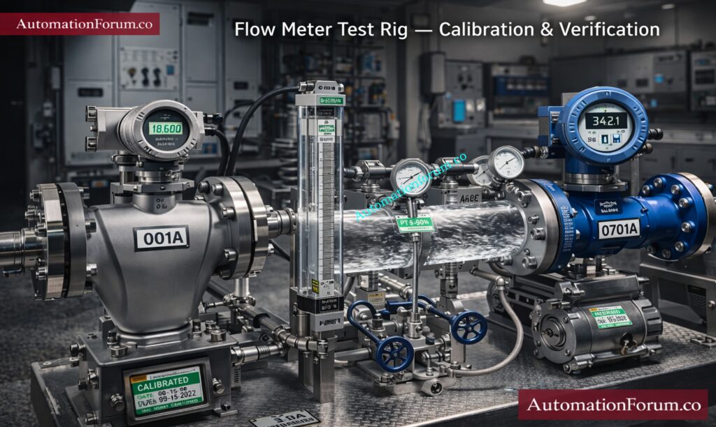

Flow measurement instruments
- Orifice flow meters
- Magnetic flow meters
- Coriolis flow meters
- Ultrasonic flow meters

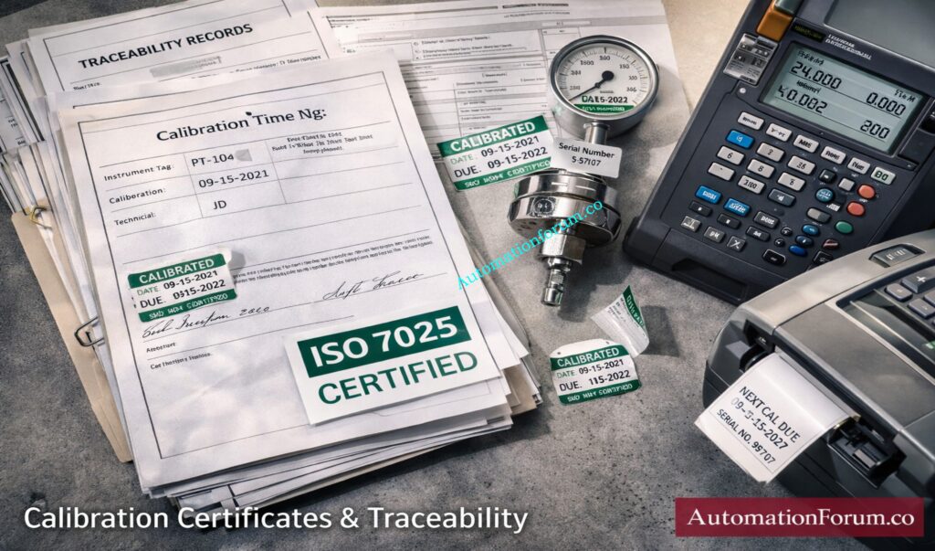

Calibration Records and Documentation Review
Checking whether calibration reports contain required details such as test points, tolerances, and technician identification.
Measurement Traceability Verification
Verification that calibration standards are traceable to national metrology institutes.

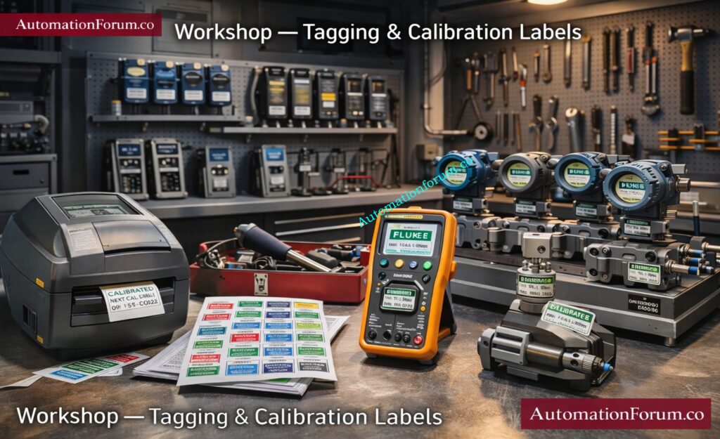

Instrument Tagging and Identification Verification
Making sure that each instrument has a unique tag number that is connected to its calibration records.
Calibration Labeling and Due Date Marking
Check that the calibration labels show the last calibration date and the next required date.

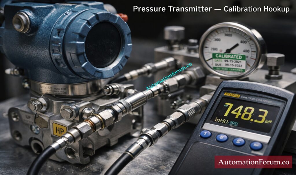

Verification of Calibration Reference Standards
Calibration tools that technicians use must also be calibrated.
Some common instruments for calibrating are:
- Pressure calibrators
- Temperature dry block calibrators
- Multifunction calibrators
- Loop calibrators
Auditors need to check that these standards have valid calibration certifications and paperwork that shows where they came from.
For the plant to run safely and reliably, it is important to keep the process instrumentation correct. In the oil and gas, petrochemical, power generation, pharmaceutical manufacturing, and water treatment industries, thousands of instruments are always measuring things like pressure, temperature, flow, level, and analytical data. If these tools aren’t set up appropriately, the facility could have problems with process stability, product quality, not following the rules, or even safety.
Engineers can use an instrument calibration internal audit checklist to make sure that calibration activities are always in line with ISO standards and factory procedures.
An instrument calibration internal audit checklist helps engineers systematically verify whether calibration activities meet ISO requirements and plant procedures. This checklist supports ISO 9001 calibration compliance, ensures measurement traceability, and helps auditors evaluate calibration procedures, records, technician competency, and calibration equipment traceability.
The following detailed ISO calibration audit checklist is designed for:
- Instrumentation engineers
- Calibration technicians
- Maintenance engineers
- Quality assurance engineers
- ISO internal auditors
- Reliability engineers in process industries
It provides a structured method to audit calibration management systems, calibration procedures, calibration equipment, documentation, traceability, and non-conformance handling.
Pressure Instruments Calibrate This Way: Calibration Procedures for Various Pressure Measuring Instruments
Use the comprehensive Excel checklist below to perform structured internal audits for process instrument calibration systems.
Download the Excel Checklist:
