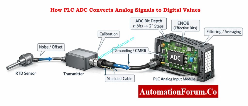

How PLC ADC Converts Analog Signals to Digital Values
Impact of PLC Resolution on PID Control Performance
When you connect a physical sensor (RTD, thermocouple with transmitter, 4–20 mA loop, or 0–10 V) the ADC inside the PLC converts that voltage/current into discrete digital counts.
Factors Affecting ADC Resolution Beyond Bit Depth
- ADC architecture (SAR, delta-sigma, successive approximation)
- Input range and any front-end scaling (resistors, op-amps)
- Input noise and signal-to-noise ratio (SNR)
- Filtering and averaging (digital or analog)
- Grounding and common-mode rejection
- Calibration offsets and gain errors
- Nonlinearity and hysteresis of sensors
Effective Number of Bits (ENOB) in PLC Analog Inputs
Even a 16-bit ADC can be effectively fewer bits of usable resolution if noise or poor wiring degrade the SNR. In practice, 16-bit resolution often delivers 12–14 bits of effective bits (ENOB) in noisy industrial environments unless you manage wiring and filtering carefully.
