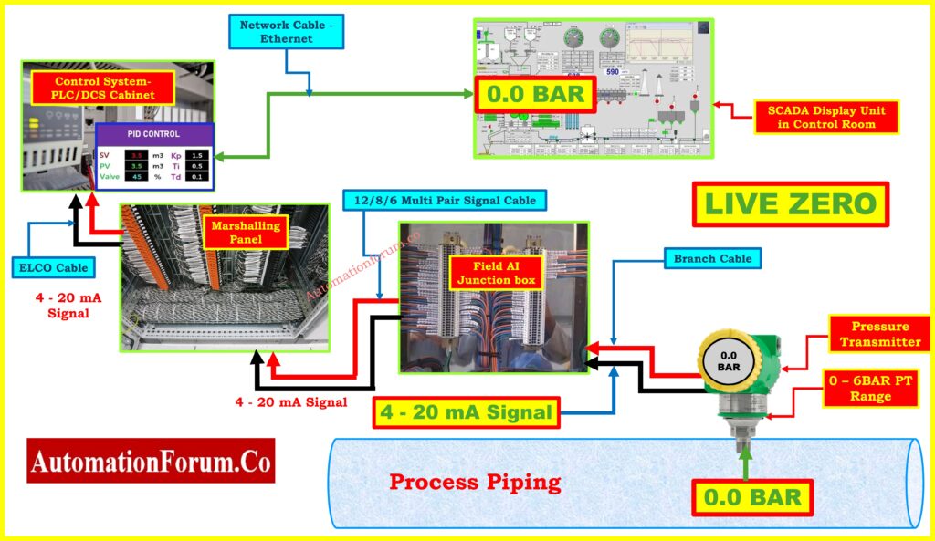

Live Zero 4 to 20 mA Loop Concept and Wiring Overview
Refer the above figure Figure for a clear field level wiring layout that demonstrates how a live zero 4 to 20 mA loop is wired from the transmitter through junction box and marshalling to the PLC and SCADA, enabling immediate fault detection when the loop opens.
Figure Explanation – Live zero field wiring and loop flow diagram
This diagram illustrates a properly functioning live zero 4 to 20 mA instrumentation loop from field transmitter to control and SCADA. The image shows the pressure transmitter mounted on the process piping, a short branch cable to the field analog input junction box, multi pair signal cable from the junction box back to a marshalling panel or terminal cabinet, ELCO wiring into the PLC or DCS cabinet, and the network connection to the SCADA display. The key message is that at zero process value the transmitter produces a non zero signal value, typically 4 mA, so the control system sees a live healthy loop even when the measured parameter is zero. From an operational perspective this arrangement provides immediate loop health visibility. If the transmitter loses power or the wiring opens the loop current falls to 0 mA and the DCS can immediately flag a bad PV alarm instead of interpreting the reading as a true zero. This wiring chain also supports two wire loop powering, long cable runs and HART diagnostics where available. Use this figure when explaining live zero concept, loop integrity checks and commissioning procedures. Emphasize how marshalling panels and junction boxes are used for neat wiring and isolation and how PLC input modules interpret under range values.

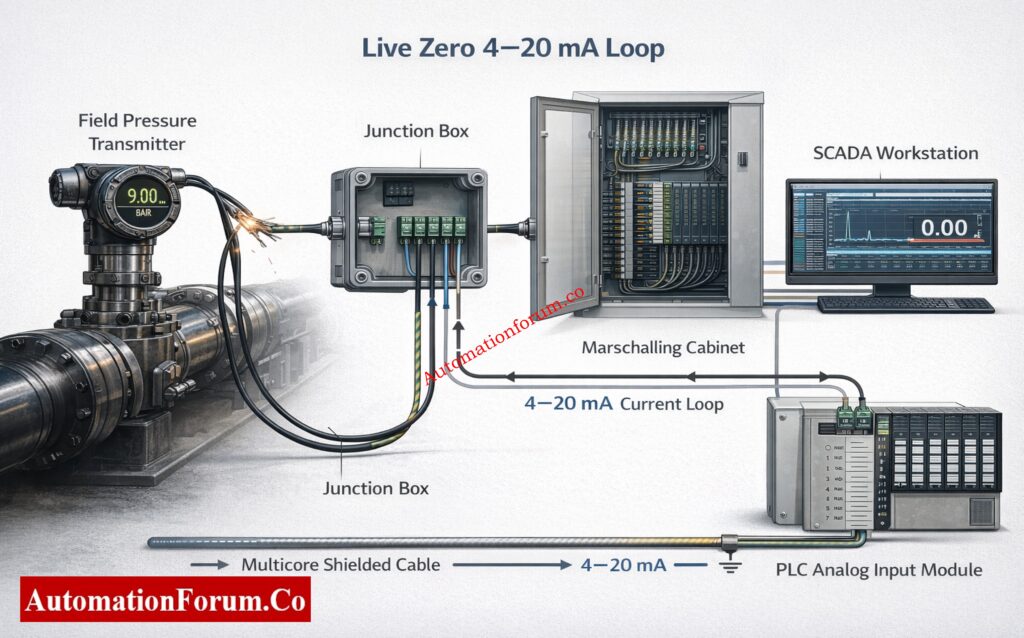

Dead Zero Issues in Voltage Based Analog Signals
The above figure shows a real dead zero failure where cable damage or a loose connection causes the loop to go open and the DCS to display zero while the field transmitter measures a non zero value.
Figure Explanation – Dead zero scenario showing open loop and false zero reading
