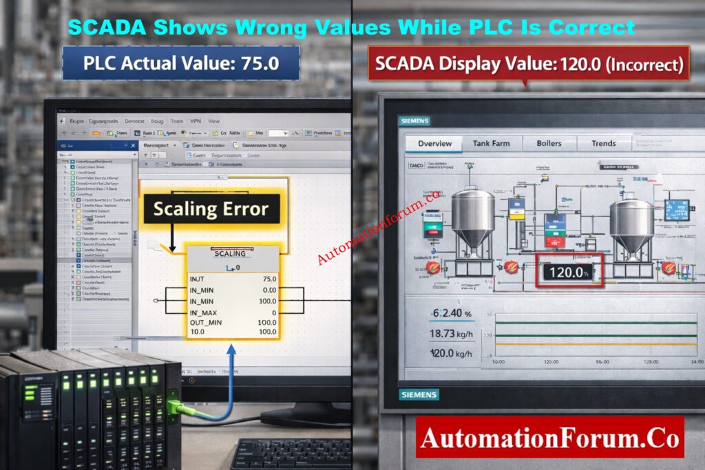

SCADA Shows Wrong Values While PLC Is Correct
Symptoms
- PLC monitoring verifies the accuracy and stability of the process value.
- For the same measurement, SCADA shows a different numerical value.
- Operators start depending more on local indicators and lose faith in SCADA data.
- The PLC reading is verified by manual devices or transmitters.
Common Causes
- incorrect conversion factors or scaling equations set up in the SCADA tag.
- PLC logic and SCADA configuration are different engineering units.
- The SCADA tag is mapped to the wrong memory location or PLC register.
- Inaccurate numerical interpretation results from data type mismatches.
How to Fix
- Check for accurate tag mapping in SCADA and PLC memory addresses.
- Verify that engineering limits correspond with PLC configuration by reviewing scaling parameters.
- Before applying any scaling, compare the raw PLC and raw SCADA values.
- Verify that the word alignment, byte order, and data type settings are correct.
Field Tip
Scaling is nearly always the problem when engineering values differ but raw values match.

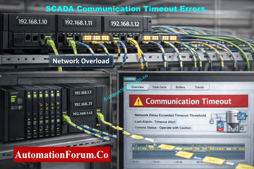

SCADA Communication Timeout Errors
Symptoms
- Timeout or poor communication alarms are frequently reported by SCADA.
- The screen refreshes slowly and irregularly.
- Sometimes alarms are missed or delayed.
- There is a lag between process change and visualization for operators.
Common Causes
- Automation communication is in competition with high background traffic.
- Polling rates are set up more quickly than the PLC or network can handle.
- Communication processing tasks consume PLC scan time.
How to Fix
- To account for network latency, increase the communication timeout settings.
- Instead of using defaults, optimize polling intervals based on process criticality.
- Use VLANs or physically distinct networks to divide automation traffic.
- Cut back on pointless communication blocks and tag polling.
Field Tip
Maximum polling speed does not equal better performance; stability is more important.

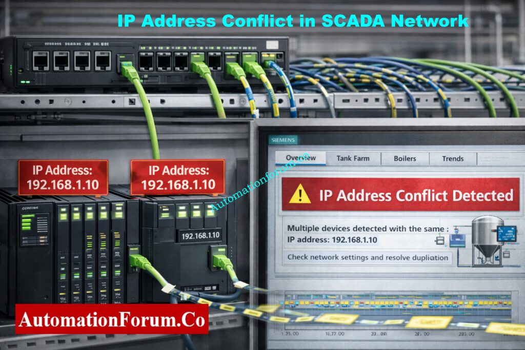

IP Address Conflict in SCADA Network
Symptoms
- Unpredictably, PLCs or SCADA nodes disconnect and reconnect.
- Communication breakdowns happen without any configuration adjustments.
- The devices that are active affect the stability of the network.
Common Causes
- Several automation devices are given duplicate static IP addresses.
- On control networks, DHCP servers are inadvertently active.
- outdated or insufficient network documentation.
How to Fix
- Look for duplicate IP addresses by scanning the network.
- Give all PLCs, SCADA servers, and HMIs fixed, documented IP addresses.
- On networks used for industrial automation, disable DHCP.
- Keep a centralized IP address registry up to date.
Field Tip
One of the SCADA problems that takes the longest to diagnose is IP conflicts.

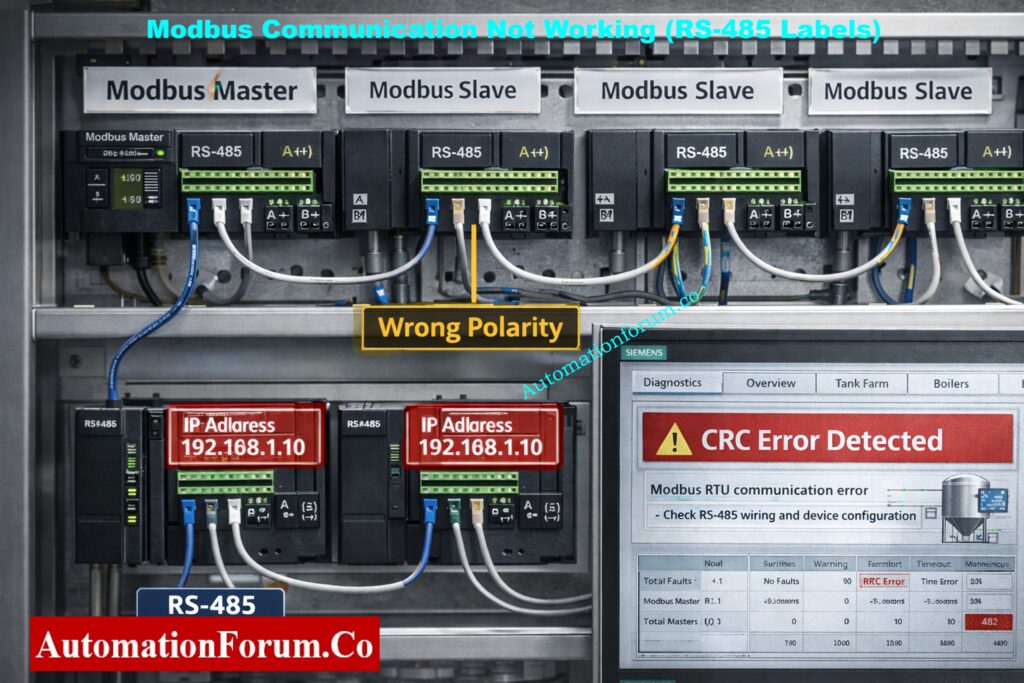

Modbus Communication Not Working in SCADA
Particularly in utilities, water treatment facilities, energy systems, and legacy installations where Modbus RTU or Modbus TCP are extensively utilized, Modbus communication problems are very prevalent.
Symptoms
- For Modbus devices, SCADA displays “No Response” or “Communication Failure.”
- Every Modbus tag shows erratic, maximum, or zero values.
- The quality of communication fluctuates between good and bad.
- CRC, framing, or timeout errors are displayed in diagnostic logs.
Common Causes
- Inaccurate slave ID set up in SCADA or repeated on several devices.
- mismatch between the master and slave devices in terms of Baud rate, parity, or stop bit.
- Incorrect termination or reversal of RS-485 A/B polarity.
- Electrical noise or poor grounding can interfere with serial communication.
How to Fix
- Make sure that all devices have the same slave ID, baud rate, parity, and stop bits.
- Verify the polarity of all RS-485 wiring, including junction boxes.
- At both ends of the RS-485 network, install termination resistors.
- Prior to SCADA, test communication using independent Modbus diagnostic tools.
Field Tip
Every parameter in Modbus networks needs to match precisely. The entire link is broken by a single incorrect setting.

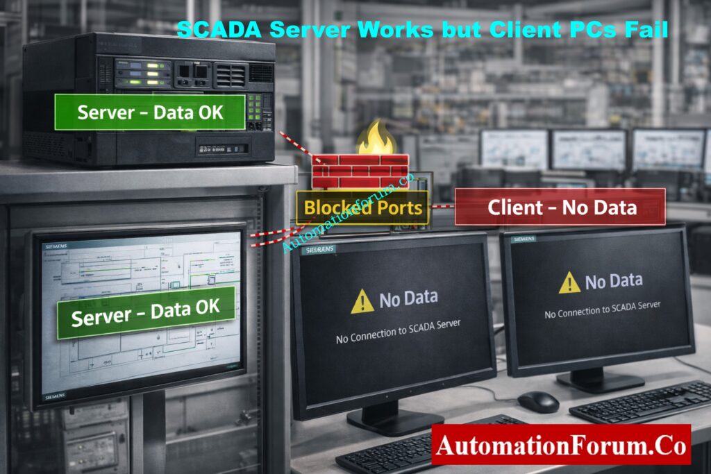

SCADA Works on Server but Not on Client PCs
This issue frequently arises in client-server or thin-client distributed SCADA architectures.
Symptoms
- The SCADA server shows accurate, real-time data without any problems.
- Operator client stations display no data, frozen values, or poor quality.
- Only on client computers do alarms, trends, or controls malfunction.
- Restarting clients won’t fix the problem.
Common Causes
- Required ports between clients and servers are blocked by firewall rules.
- Remote access is limited by OPC, DCOM, or SCADA security permissions.
- Licensing restrictions or client connection limits are surpassed.
- problems with DNS resolution or network routing between clients and servers.
How to Fix
- Check the firewall rules on the client and server systems.
- Verify the permissions for remote access in the OPC or SCADA security settings.
- Verify client licenses and the maximum number of connections permitted.
- Use localhost access, hostname, and server IP to test communication.
Field Tip
Usually, network security or IT policy rather than SCADA logic is the problem when the server functions but the clients don’t.

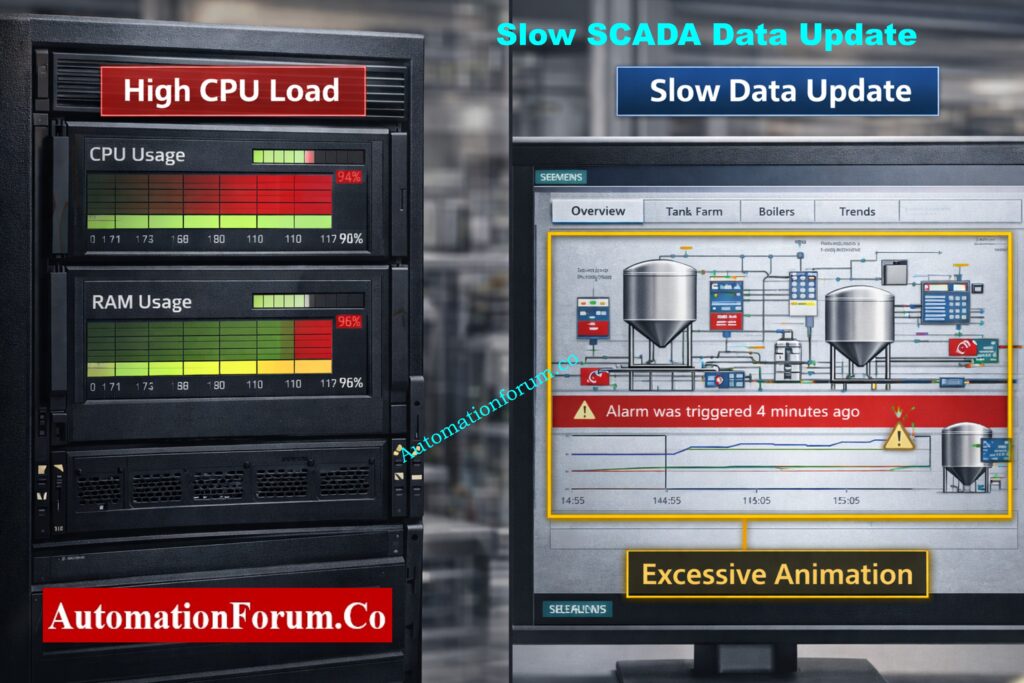

SCADA Data Update is Very Slow
Slow data updates raise operational risk and lower operator awareness.
Symptoms
- Values are updated several seconds after changes in the actual process.
- Real-time process behavior is faster than trend displays.
- Alarms are either out of order or arrive late.
- The system feels “heavy” or unresponsive, according to operators.
Common Causes
- screens that are overflowing with scripts, animations, and graphics.
- inadequate SCADA server CPU, RAM, or disk performance.
- Excessive data loading is a result of a poor project structure.
How to Fix
- Eliminate superfluous animations and simplify graphics.
- Instead of using defaults, modify scan rates according to the significance of the process.
- Upgrade your hardware, particularly your SSD and memory.
- Projects should be arranged so that only necessary data loads on each screen.
Field Tip
SCADA performance is more than just a hardware problem; it is an engineering responsibility.

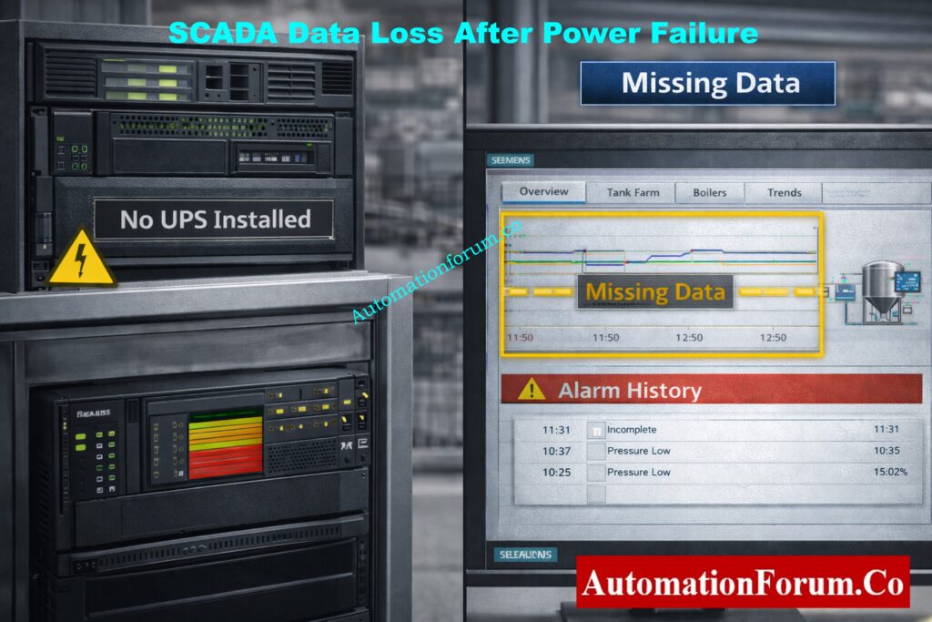

SCADA Loses Data During Power Failure
Reporting, compliance, and root-cause analysis are all directly impacted by this problem.
Symptoms
- After power is restored, trend gaps manifest as symptoms.
- The alarm history is either missing or insufficient.
- Reports display data that is corrupted or missing.
- Operators no longer have access to historical data.
Common Causes
- Uninterruptible power supplies are not used to protect SCADA servers.
- When there is a power outage, databases suddenly shut down.
- No historian configuration or automatic backup.
How to Fix
- Install UPS systems sized for controlled shutdown or ride-through.
- Configure automatic database backup and recovery.
- Use a dedicated historian for long-term data retention.
- Periodically test backup and restore procedures.
Field Tip
No matter how good the software is, SCADA cannot ensure data integrity without UPS protection.
