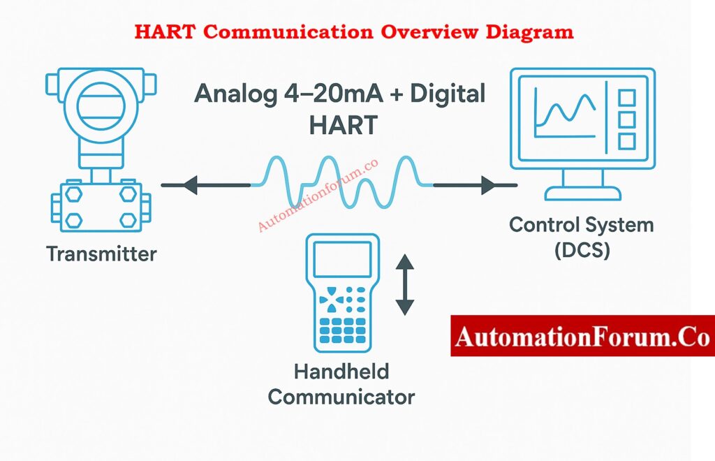

How HART Commands Carry Diagnostic Data
The HART protocol operates on a query–response model. The host delivers a command, and the device sends back data and information about its status.
There are three types of HART commands:
- Universal Commands (0–30, 38, 48):
All HART devices support this, which lets you read PVs, device info, and extended status. - Common Practice Commands (32–121):
These are used by all device families for trimming, damping, or resetting. - Device-Specific Commands (128–253):
These are set by the makers for their own diagnostic purposes.
All responses include the two status bytes described earlier, meaning every command is both a data exchange and a health report.

FAQ on HART Transmitter Diagnostics
1. What are the benefits of HART communication?
HART communication mixes analog 4–20 mA signals with digital data. This lets you set up devices, troubleshoot them, and calibrate them from a distance. It improves accuracy, cuts down on maintenance time, and works with current wiring, making upgrades simple and cheap.
2. What is the main function of HART?
The basic purpose of HART is to provide two-way digital communication over typical 4-20 mA loops. This lets users get process, configuration, and diagnostic data from smart field equipment without stopping work.
3. Which of the following is a benefit of using the HART protocol?
One of the best things about using the HART protocol is that it lets you access instrument data and health diagnostics from a distance without having to run extra wires. This combines the durability of analog signals with the intelligence of digital signals to make plants run more efficiently.
4. What is the application of HART?
In process industries, HART is used to set up, keep an eye on, and fix problems with transmitters and smart instruments. It works with software used in oil and gas, power, chemicals, and water treatment industries.
