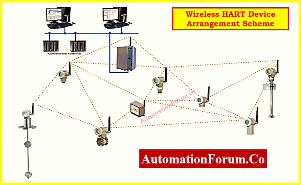

Best Practices for WirelessHART Device Placement
Mesh Network Optimization
WirelessHART runs on a self-healing mesh topology. Devices do not have to directly link to the gateway; rather, they must interact with nearby instruments. Keep these suggestions in mind:
- Use site drawings and scaled plant layouts: Before actual installation, find possible signal blind areas and assist in visualizing ideal device positions. Layout plans should have structural elements such towers, walls, vessels, and pathways.
- Place repeaters in low-signal areas: These improve network dependability by functioning as communication relays in dead zones or between separated clusters. Mains-powered devices can act as permanent repeaters. For temporary installations or low-traffic areas, think about battery-operated repeaters exclusively.
- Employ directional or external antennas: Select antenna kinds appropriate for certain installation requirements. While remote antennas assist in tight or metal enclosures, directional antennas are beneficial for concentrated transmission over great distances. During installation, verify antenna gain and orientation.
- Position devices based on process segmentation: Group devices logically by process units or operational domains. This enables segmenting of networks for troubleshooting or maintenance. Use device naming conventions to indicate segment sites.
- Use elevation for better RF visibility: Install equipment above ground level and away from barriers like walkways, platforms, or pipelines to improve RF visibility using height. Antennas raised above ground level improve network stability and line-of-sight connection. Avoid areas that are shadowed or thermally unstable.
Recommended Placement Criteria
- Mount antennas >0.5 m from vertical surfaces: Mount antennas >0.5 m from vertical surfaces to lower signal reflections and enhance direct line-of-sight connection. Do not put antennas right next to steel structures.
- Install devices at least 1.5 m above ground level: Devices should be installed at least 1.5 m above ground level to reduce interference from metal objects or human traffic and improve mesh dependability.
- Ensure each device has 3+ neighbors: Creates backup routes for dependable communication and network self-healing features. During commissioning, use network visualisation tools to confirm neighbour counts.
- Gateways should maintain at least 5 direct connections: Gateways should keep at least five direct connections; this offers several communication routes for data routing and improves network resilience. Direct connections increase data throughput and lower retransmission delays.
- In large networks, aim for 25% of devices to connect directly to the gateway: This will help to balance network traffic, lower communication delays, and guarantee enough path diversity. Add fixed infrastructure devices if required.

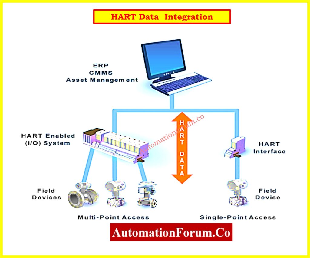

HART Data Integration Approaches
Levels of HART Integration
There are several methods for using HART data:
1. Point-to-Point HART Integration
- The most basic kind uses a handheld or modem for setup
- Gives diagnostics and status without altering infrastructure
2. HART-to-Analog Signal Conversion
- Pull digital HART data and transform it into analog for application in outdated systems
- Allows for incremental updates without complete system overhauls
3. Hybrid HART-plus-Analog Integration
- Maintain analog signals to control systems while using HART multiplexers to receive digital data.
- Perfect for condition monitoring and device diagnostics
Explained Simply: What is HART and HART Multiplexer?
4. Full HART Integration
- Use HART enabled Remote or Field I/O modules
- Provides real-time access to device diagnostics and PVs in control system
- By identifying process or device problems early, it facilitates predictive maintenance.
5. HART-to-Plant Network Integration
- Use an OPC server or HART-IP bridge to route HART data to enterprise-level systems.
- Enables process improvement, inventory control, and sophisticated analytics.
