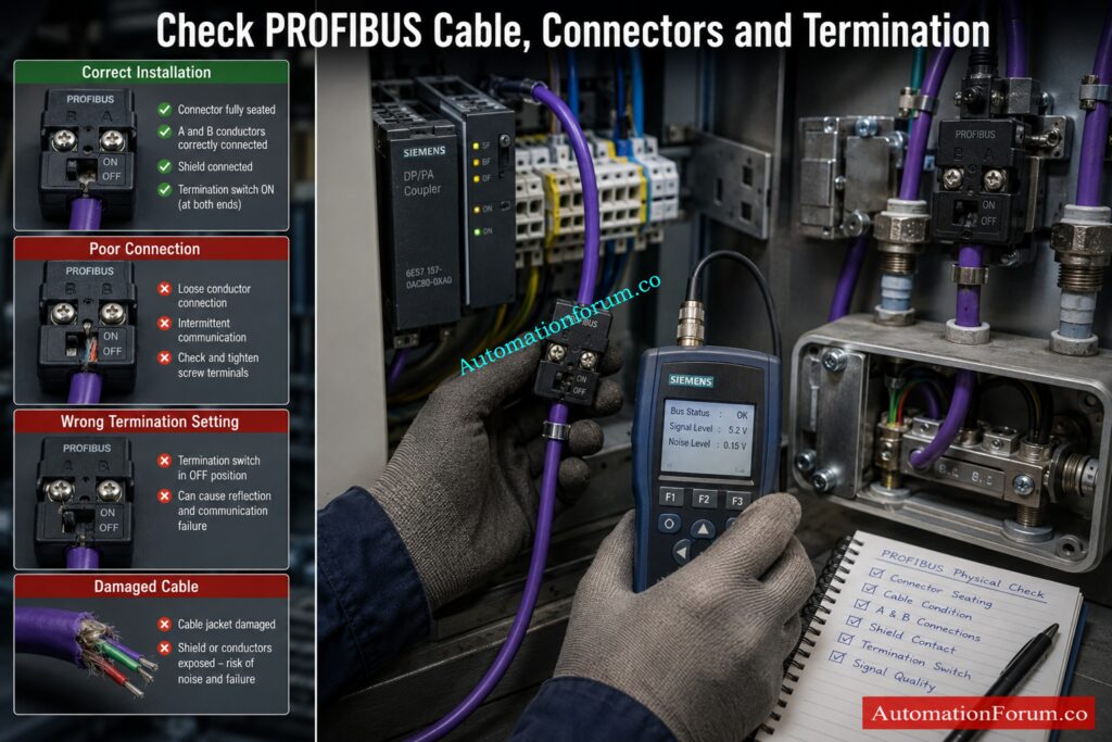

Step 3 Inspect PROFIBUS Cable and Connectors
- Physical inspection should be performed carefully.
- Verify loose connectors, broken connector bodies, bad conductor connections, wrong A and B connections, damaged insulation, crushed cable, overbending, corrosion, and poor shield contact.
- Pay particular attention to the connector near the first failed station and the section between the last healthy station and the first failed station.
- A connector can appear normal externally while having a poor internal connection. PROFIBUS installation guidance specifically recommends checking connector seating, fastening, pins, cable assembly, and termination switch settings.
- Intermittent faults are especially suspicious when the problem changes after vibration, maintenance activity, or movement of the cable.
Decode Modbus Registers Without Making Costly Configuration Errors: Understanding the Four Types of Registers in Modbus Protocol
Step 4 Check PROFIBUS Termination
- Termination is one of the first physical layer checks to make.
- Each copper PROFIBUS segment requires proper termination at its two physical ends. An intermediate connector should not normally have its termination enabled. The termination arrangement must also remain valid for the actual operating condition of the segment.
- Check:
- Is termination enabled at both segment ends?
- Is termination accidentally enabled at an intermediate station?
- Is a required termination missing?
- Is the terminating device correctly powered?
- Has a connector been replaced with a unit having a different switch position?
- Incorrect termination can produce reflections and unstable communication. This often appears as intermittent errors rather than a simple permanent failure.
- Repeaters and separate segments must be checked according to the actual network architecture.

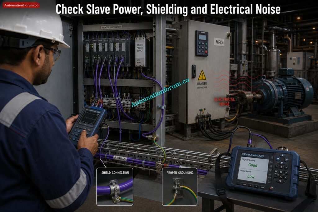

Step 8 Check Slave Power Supply and Device Health
- A communication failure can actually be a power problem.
- Measure and verify the supply to the affected slave, communication module, and associated equipment. Look for loose power terminals, unstable voltage, supply interruption, repeated device restart, hardware initialization problems, and internal device faults.
- Observe the device status indications during the failure. If the device repeatedly restarts, the PROFIBUS communication failure may simply be the consequence of unstable device power.
- This is particularly important for remote I/O stations and drives where control power and communication electronics may have separate supply arrangements.
Step 9 Check PROFIBUS Shielding, Grounding and Electrical Noise
- Industrial electrical equipment can create conditions that disturb communication.
- Investigate the area around variable speed drives, large motors, contactors, switching equipment, and high current power cables.
- Check shield continuity, cable routing, grounding connections, and potential equalization according to the network design and plant earthing philosophy. There is no single grounding arrangement that should be applied blindly to every installation.
- If communication becomes unstable only when a large motor or drive starts, investigate electromagnetic interference and signal quality rather than immediately replacing the slave.

Check PROFIBUS Cable and Connectors
Check the cable and connectors around the afflicted station and the boundary between healthy and failing stations. Check for loose connectors, damaged cable, poor conductor connections, incorrect A and B connections, corrosion, and poor shield contact.
Intermittent faults require particular attention because vibration, maintenance activity, or cable movement can temporarily change the communication condition.
Check PROFIBUS Termination and Signal Quality
Verify that termination is correctly applied at the physical ends of the PROFIBUS segment and that an intermediate station does not have termination enabled incorrectly. Also check the condition and power arrangement of the terminating connections.
If the problem remains intermittent, use suitable PROFIBUS diagnostic equipment to investigate signal quality, reflections, noise, telegram errors, and communication retries.

- Inspect connectors and PROFIBUS cable.
- Check the section between the last healthy and first failed station.
- Verify termination at the actual segment ends.

- Check slave power supply and device health.
- Investigate shielding, grounding, and electrical noise.

How do I troubleshoot a PROFIBUS termination problem?
Ensure that termination is enabled only at the extreme ends of each PROFIBUS segment.
Also check termination power, connection condition, cable continuity and actual network layout.
