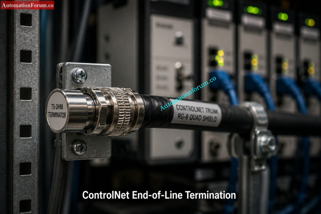

A ControlNet termination resistor is a specially designed 75 ohm resistor installed at both physical ends of the ControlNet trunk cable.
Its main purpose is to absorb the communication signal when it reaches the cable end so the signal does not reflect back into the network.

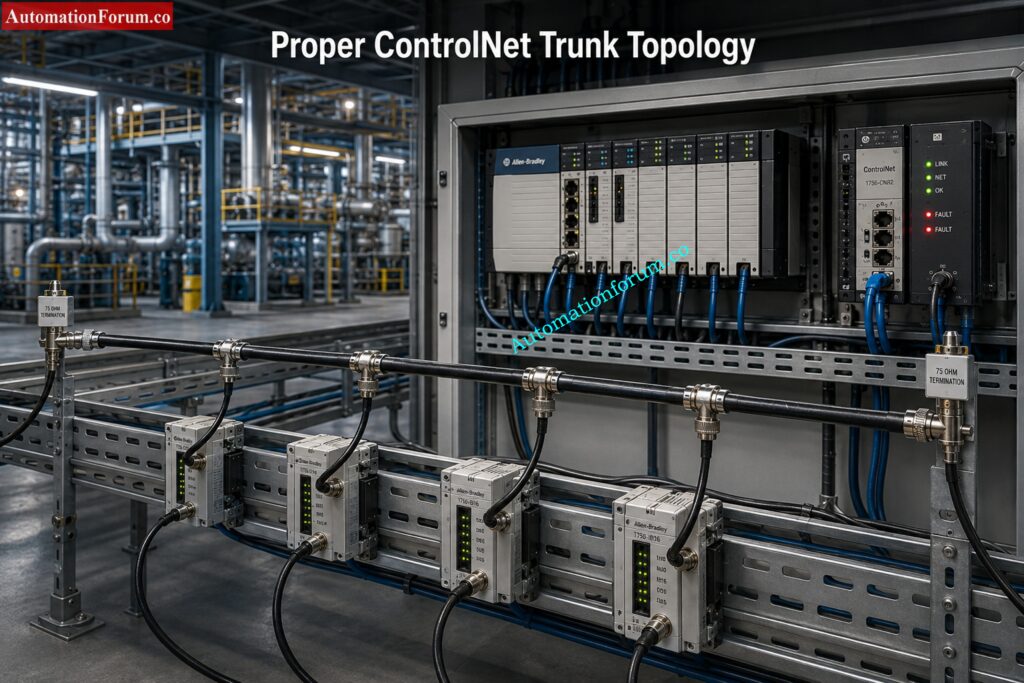

Where are ControlNet Terminators Installed?
ControlNet Trunk Cable Termination Points
ControlNet terminators are installed at the two physical ends of the trunk cable using BNC connectors. Their job is to absorb the communication signal at the cable end and prevent reflections from returning into the network.
End of Line Termination in ControlNet Networks
Proper termination is required at both ends of the ControlNet trunk. This helps make the network stable and predictable, as well as maintain the integrity of the signals and lower the number of communication failures.
Common Locations for ControlNet Terminators
Typical terminator installation points include the following:
- Main PLC rack end
- Final remote I/O rack
- Fiber repeater segment ends
- Last tap on the trunk cable
- Redundant media segment ends
Both ends of the trunk cable must always be terminated correctly.

Correct Method to Install ControlNet 75 Ohm Termination Resistors
Correct Installation Rules for ControlNet Terminators
- Install one terminator at each physical end of the trunk cable.
- Never install a terminator in the middle of the trunk.
- Use approved ControlNet taps and proper BNC connectors.
- Maintain the correct trunk topology.
- Verify shielding continuity during installation.
Proper ControlNet Trunk Topology
- A standard ControlNet network includes:
- One trunk cable
- Multiple taps
- Two end terminators
- Both ends of the trunk must always be terminated correctly.
Approved ControlNet Taps and BNC Connectors
- ControlNet taps that have been approved are made to keep the impedance across the network the same.
- Using third-party connectors or the wrong hardware might cause impedance discontinuities and make reflections worse.
Importance of Shielding Continuity
- Proper shielding helps protect the network from electrical noise.
- Shielding continuity is essential for maintaining stable communication in industrial environments.

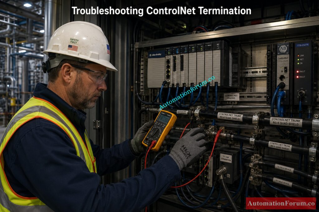

How to Troubleshoot ControlNet Termination Problems
Visual Inspection of ControlNet NetworksWhere are ControlNet Terminators
- Check for missing terminators at both ends of the trunk cable.
- Inspect all connectors for looseness or poor contact.
- Look for damaged taps, broken shielding, corroded connectors, and cable cuts.
Measuring Resistance Across the Trunk Cable
- Turn the power OFF before testing.
- Measure resistance across the trunk cable to verify termination.
- A correctly terminated ControlNet network should read approximately 37.5 ohm.
Expected 37.5 Ohm Reading Explained
- Two 75 ohm terminators connected in parallel will measure about 37.5 ohm.
- This reading confirms that both end terminators are installed correctly.
Using ControlNet Diagnostic Tools
- Use Rockwell diagnostic tools such as:
- ControlNet Media Checker
- RSNetWorx diagnostics
- These tools help identify:
- Signal quality problems
- Cable faults
- Impedance mismatch
- Noise issues
LED Diagnostics for ControlNet Faults
- Observe module LEDs carefully.
- Common warning signs include:
- Flashing red network LED
- Media fault LED
- Communication fault LED
Oscilloscope Testing for Signal Reflection
- Advanced troubleshooting may use an oscilloscope.
- This helps check for:
- Reflections
- Waveform distortion
- Noise levels
- Standing waves
Modbus TCP/IP vs Profinet: Which One Dominates Industry: Modbus TCP/IP vs Profinet: Which Protocol Suits your Industrial Network Best?
How to Measure ControlNet Termination Resistance
Step by Step Resistance Measurement Procedure
- Power down the network.
- Measure resistance across the trunk cable.
- Compare the reading to what you expect, which is 37.5 ohm.
- Check that both terminators are there and in the right place.
Why Power Must Be OFF During Measurement
- You have to turn off the power before testing resistance to get reliable data.
- This also keeps test tools and equipment from getting broken.
Interpreting Different Resistance Readings
- 37.5 ohm: normal, both ends are there.
- 75 ohm: one terminator missing.
- Infinite resistance: both terminators missing.
- Very low resistance: short circuit or extra terminator.
Detecting Missing Terminators and Short Circuits
- A resistance check is one of the fastest ways to identify termination problems.
- It helps detect missing terminators, shorts, and incorrect network loading.

- Whenever there are problems with communication, troubleshoot termination in a methodical way.
