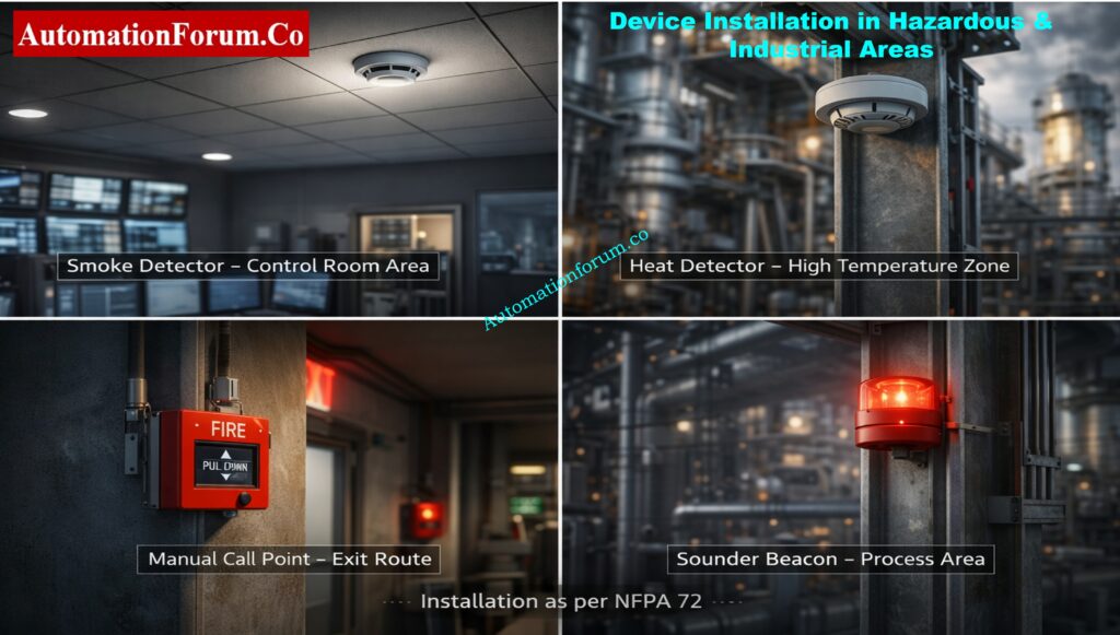

Fire detectors must be put in exactly as shown on the authorized designs and according to NFPA 72 spacing standards.
  • Height and structure of the ceiling
  • How air flows via HVAC systems
  • Dust, steam, or process fumes are present.
  • The temperature and conditions in the environment
To cut down on false alarms, heat detectors or covered detector housings should be utilized in regions with aggressive processes.
Along escape routes, manual call locations should be placed at heights that are comfortable for people. Notification devices must be set up to make sure:
  • Sound pressure levels that are high enough in all populated areas
  • Clear voice announcements for evacuation when needed
  • Extra coverage and backup in loud factories
