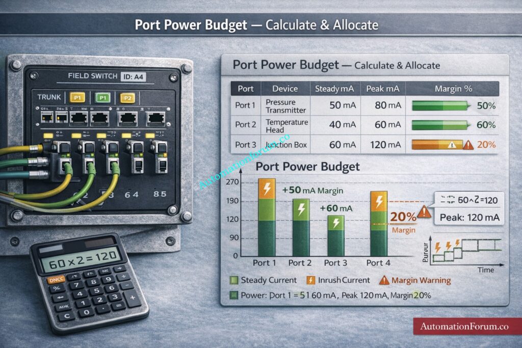

Power Delivery and Port Class Engineering
APL enables power over the same pair in a controlled manner via port power classes. For EPC design follow these rules
Port Power Budget Calculation Method
For every field switch maintain a power budget sheet that lists the available trunk power per switch and allocates per port. Include steady state draw and peak draw and keep a design margin typically twenty percent for growth and inrush.
Device Selection Criteria for Spur Powering
Small transmitters and smart sensors can be powered by APL spurs. Heavy devices such as motorized actuators and large valve positioners normally require local mains or local DC and must be excluded from spur powering unless explicitly supported by the port class.
Managing Inrush Current and Startup Sequencing
Account for device inrush currents at boot. Implement sequential connection of spurs during commissioning so multiple devices do not draw peak current simultaneously and trigger power limiting.

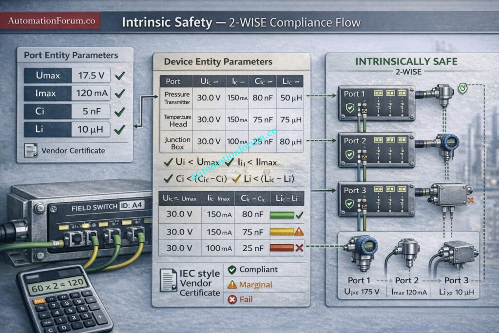

Intrinsic Safety Design Procedure (2-WISE Implementation)
To implement the two wire IS model on projects follow these repeatable steps
- Define port class and power class per segment in the instrument specification.
- Require vendor entity parameters U max I max Ci Li and declared power for each device.
- Compare vendor entity values with port parameters to prove compliance.
- Design surge protection and earthing so protective devices do not invalidate the IS proof.
- Record IS mapping on schematic drawings and include the mapping in FAT and SAT deliverables.
Maintain an IS calculation workbook that traces each port to its attached devices and shows margin compliance.

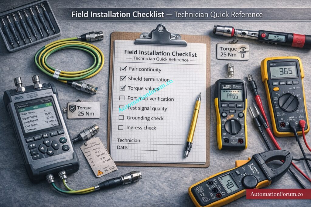

Installation, Commissioning, FAT and SAT Procedures
Follow a structured commissioning flow and capture signed deliverables
Key commissioning checks
- Check cable labeling and routing against as built drawings.
- Measure pair continuity pair resistance and insulation where permitted.
- Verify shield continuity and earth connection at the designated point.
- Torque terminations to vendor values.
- Power up the field switch trunk and verify upstream link.
- Connect spurs sequentially and check LLDP neighbor entries and device identity.
- Capture device power draw and confirm within budget.
- Execute FAT test cases and capture logs for SAT.
Recommended Test Equipment for APL Projects
- Single pair cable tester for continuity and pair characteristic checks
- Portable link analyzer able to read PHY status and LLDP for single pair Ethernet
- Clamp meter and multimeter for local power checks
- Packet capture via managed switch or dedicated capture tool for application level verification

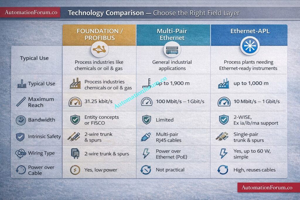

FOUNDATION/PROFIBUS vs Multi-Pair Ethernet vs Ethernet-APL Comparison
| Parameter | FOUNDATION / PROFIBUS | Multi Pair Ethernet | Single Pair Ethernet Ethernet APL 10BASE T1L |
| Typical use | Legacy analog and fieldbus sensors, transmitters, valve positioners | Plant backbone, control room switches, servers, DCS interconnections | Field devices in hazardous areas, smart transmitters, edge instrumentation |
| Maximum reach | Trunk and spur several kilometers depending on segment design | 100 m per copper segment | Trunks up to around 1000 m, spurs around 200 m |
| Bandwidth | Low, typically in kbps range | High, 100 Mbps to 1 Gbps common | 10 Mbps |
| Intrinsic safety | Proven and widely implemented | Limited support in field environments | Supported via two wire intrinsic safety concept 2 WISE |
| Wiring type | Two wire trunk and spur | Four pair copper cable | Two wire trunk and spur |
| Power over cable | Supported in bus powered segments | Supported via PoE but not suitable for Zone 0 1 field devices | Supported via defined APL port power classes |
| Retrofit potential | High in existing fieldbus plants | Moderate, often requires new cabling | High potential, reuse of Type A fieldbus cable possible |
| Typical environment | Field instrument level in process plants | Control room and plant network backbone | Field level including hazardous Zone 1 and Zone 2 areas |
| Engineering complexity | Well understood, mature tooling | Standard IT network practices | Requires port class, power budget and IS mapping discipline |
| Future scalability | Limited by bandwidth | Very high but short reach | Balanced reach and bandwidth for field digitalization |
Practical Interpretation for EPC Engineers
- FOUNDATION and PROFIBUS remain reliable for legacy brownfield environments but are bandwidth limited.
- Multi pair Ethernet is ideal for control room and backbone infrastructure but not suitable for long hazardous field runs.
- Ethernet APL bridges the gap by bringing native Ethernet to the field with long reach and intrinsic safety support.

Field Installation Checklist – Technician Quick Reference
Use this checklist at the point of termination and commissioning.
| Done | Item |
| ☐ | Cables labeled and matched to drawings |
| ☐ | Pair continuity and resistance verified |
| ☐ | Shield continuity and earth lug installed |
| ☐ | Terminations torqued to vendor spec |
| ☐ | Spur length checked against allowed limit |
| ☐ | Connector seals and ingress checks completed |
| ☐ | Field switch earthing and surge protection installed |
| ☐ | Port mapping recorded and LLDP names captured |
| ☐ | Power budget verified per field switch |
| ☐ | Commissioning capture started and logs saved |
| ☐ | FAT test cases executed and signed |
| ☐ | As built updates filed to project document system |
