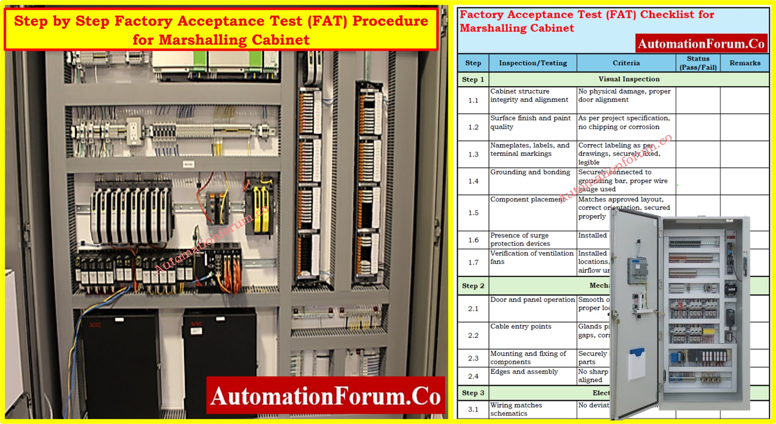

Step by Step Factory Acceptance Test (FAT) Procedure for Marshalling Cabinet
Step 1: Visual Inspection
- Check that the cabinet has proper structure integrity along with correct door alignment and appropriate ventilation openings.
- The project requirements must be satisfied by the selected paint and its surface finish.
- Confirm that all nameplates and identification labels as well as terminal markings remain in place.
- All components need to have their correct grounding and bonding connections verified.
- Check that internal components match the specifications of approved drawings.
- Verify that installed converters contain all required signal elements including current to voltage converters and voltage to current converters as well as temperature signal converters.
- Technical team members must establish the physical existence and correct placement of temperature transmitters alongside PLC modules together with power supply units, interface modules and communication gateways.
- Check that ventilation fans remain in correct positions with working functionality.
- Perform a check to verify both the presence of surge protection devices and their functional status.
- Signal wires should be clearly separated from power cables through correct wiring practices.

Factory Acceptance Test (FAT) Excel – Checklist for Marshalling Cabinet
This checklist ensures marshalling cabinets meet design, operational, and safety requirements before installation, reducing commissioning issues.
