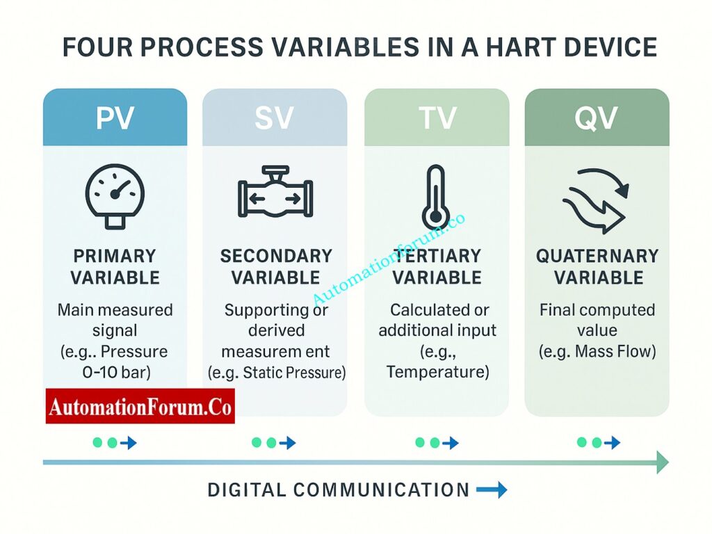

What are Process Variables in HART Devices?
Conventional analog transmitters were limited to transmitting a singular data point, specifically the principal measured variable, by transforming it into a 4-20 mA signal. For instance, a pressure transmitter sends out 4–20 mA for a pressure range of 0–10 bar.
Hands-On Field Guide: Step-by-Step Guide for Installing and Commissioning HART and WirelessHART Devices for Engineers and Technicians
List of Four HART Process Variables
HART communication, on the other hand, adds a digital layer to the analog signal. This means that one transmitter can send up to four process variables (PVs) at the same time:
- PV – Primary Variable
- SV – Secondary Variable
- TV – Tertiary Variable
- QV – Quaternary Variable
Depending on the type of transmitter, these four variables can be measured, derived, or calculated. They let operators and control systems get to rich, multidimensional data without needing extra wiring or transmitters.

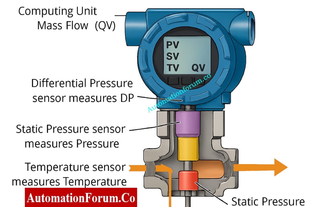

Example – ABB 266MST Smart Multivariable Transmitter
Think about a Multivariable Transmitter, like the ABB 266MST Smart Transmitter, once more.
It measures differential pressure, static pressure, and temperature. From these inputs, the transmitter computes mass flow, which becomes the Quaternary Variable (QV).
| Variable | Description | Unit |
| PV | Differential Pressure | mbar |
| SV | Static Pressure | bar |
| TV | Process Temperature | °C |
| QV | Mass Flow (Calculated) | kg/h |
In this setup:
- The QV = mass flow is derived using DP, static pressure, and temperature, following the compensated flow equation.
- This single HART device thus replaces three separate transmitters making it a compact and efficient solution for process industries.

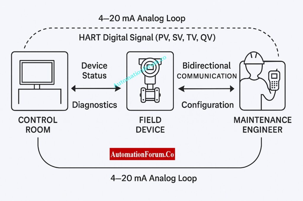

Only PV Is Transmitted via Analog Signal
How HART Combines Analog and Digital Signals
One key principle of HART communication is that only the PV is sent via the traditional 4-20 mA analog output.
However, SV, TV, and QV are transmitted digitally over the same pair of wires using frequency-shift keying (FSK) modulation.
Benefits of Hybrid (4–20 mA + Digital) Communication
This combination allows:
- Backward compatibility with analog control systems
- Enhanced digital communication for smart diagnostics
The analog loop keeps legacy systems running, while digital HART data provides real-time access to additional process and device information.

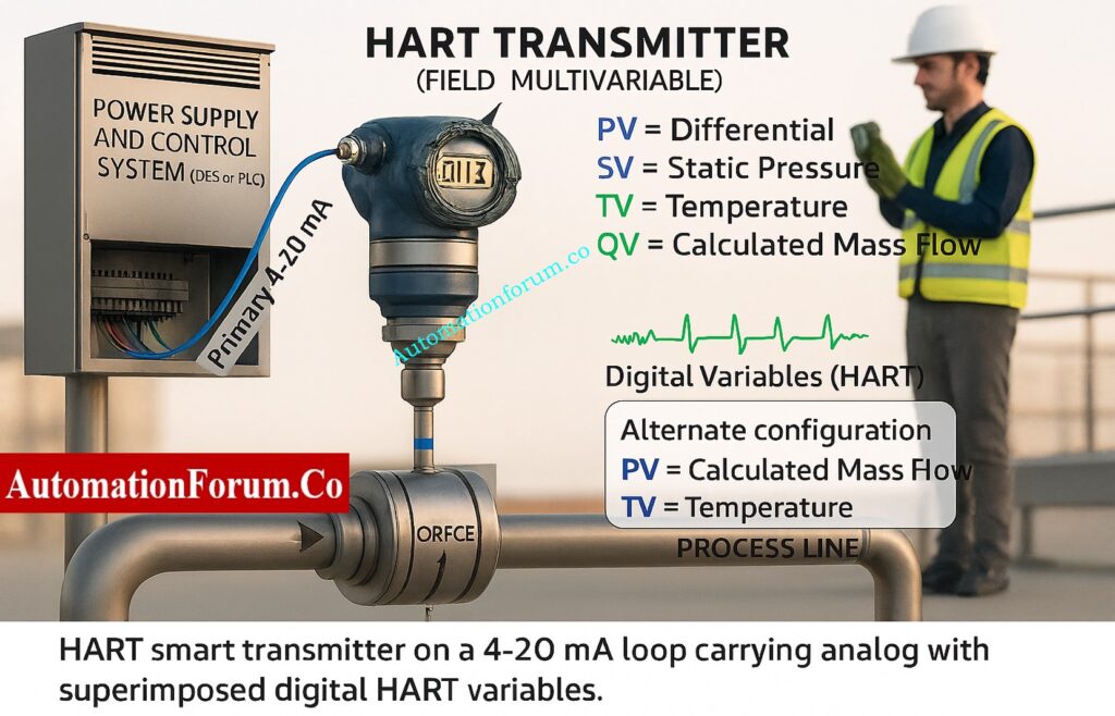

Practical Example – HART Multivariable Flow Transmitter in a Steam Line
Let’s look at how PV, SV, TV, and QV work together in a real-life system for measuring steam flow.
Instrument Setup and Measurement Parameters
How it works: Steam Flow Measurement in Power Plant Variable
| Variable | Description | Function in Measurement |
| PV | Differential Pressure | Used to calculate flow rate |
| SV | Static Pressure | Compensates for steam density |
| TV | Temperature | Provides temperature compensation |
| QV | Mass Flow (Calculated) | Final compensated mass flow output |
How PV, SV, TV, and QV Work Together
- The DP sensor monitors how much the pressure drops over an aperture plate.
- The sensors for static pressure and temperature fix the density of steam.
- The computer inside the transmitter figures out the mass flow (QV).
- The DCS gets the 4-20 mA signal for control (PV) and can check digital variables (SV, TV, QV) to keep an eye on things or report on them.
This method makes steam systems more accurate, cheaper to install, and better at managing energy.
