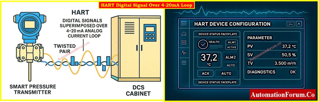

Highway Addressable Remote Transducer (HART) protocol is still a key part of intelligent device communication in current process automation. To get the most out of smart instrumentation, it’s important to set the HART parameters correctly in Distributed Control Systems (DCS). From better diagnostics to multi-variable data access, correct HART configuration ensures dependability, efficiency, and operational insight.
This article shows the best ways to set up HART parameters in DCS platforms as Emerson DeltaV, Yokogawa CENTUM, Honeywell Experion, Siemens PCS 7, and ABB 800xA. It also includes advice from professionals in the field to make sure it works as well as possible.

Set Up the Communication Channels
For HART data to flow smoothly and reliably, the communication channels must be set up correctly.
Two Types of Communication:
- Direct Channel: One HART device for each analog input/output module, like an AI/AO HART card.
- Multiplexed Channel: A HART multiplexer connects many devices, which saves money but makes real-time reliability worse.

In Emerson DeltaV, you can define up to four dynamic HART variables (PV, SV, TV, FV) per device, ideal for multi-variable transmitters.

DCS systems should do more than just connect; they should also accurately show all the important information from the HART devices.
Parameters to Configure:
- PV Range (LRV/URV): For correct scaling in visuals and logic.
- Engineering Units: Make sure that graphics and logic are the same.
- Calibration Settings: Make sure that the DCS readings match the calibrated process signal.
- Tagging Devices: Correctly tagging devices makes it easier to diagnose problems during commissioning.
