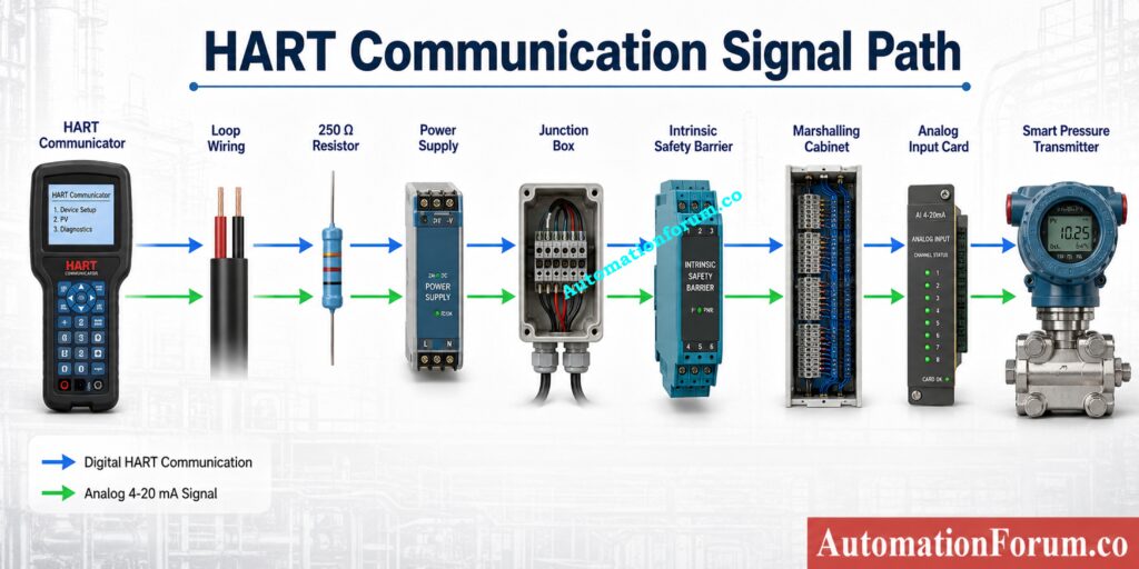

HART Communication Signal Path
Successful communication depends on every component in the loop operating correctly.
Communication path:
HART Communicator → Loop Wiring → Power Supply → Loop Resistor → Junction Box → Intrinsic Safety Barrier or Isolator → Marshalling Cabinet → Analog Input Card → Smart Transmitter
A failure at any point can interrupt digital communication. During troubleshooting, engineers should verify each section individually instead of assuming the transmitter is faulty.
