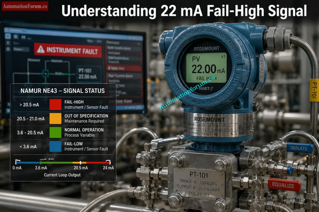

The concept behind this design is called Live Zero.
At 4 mA the transmitter is still powered and operational. If the signal drops to 0 mA, engineers immediately know that a wire break, power failure, or major loop problem exists.
Similarly, when the current rises above 21 mA, the transmitter is often indicating that it has detected a fault condition.
Avoid Costly Calibration Errors With This Proven Method: How to simulate 4-20ma signal with Loop Calibrator ?

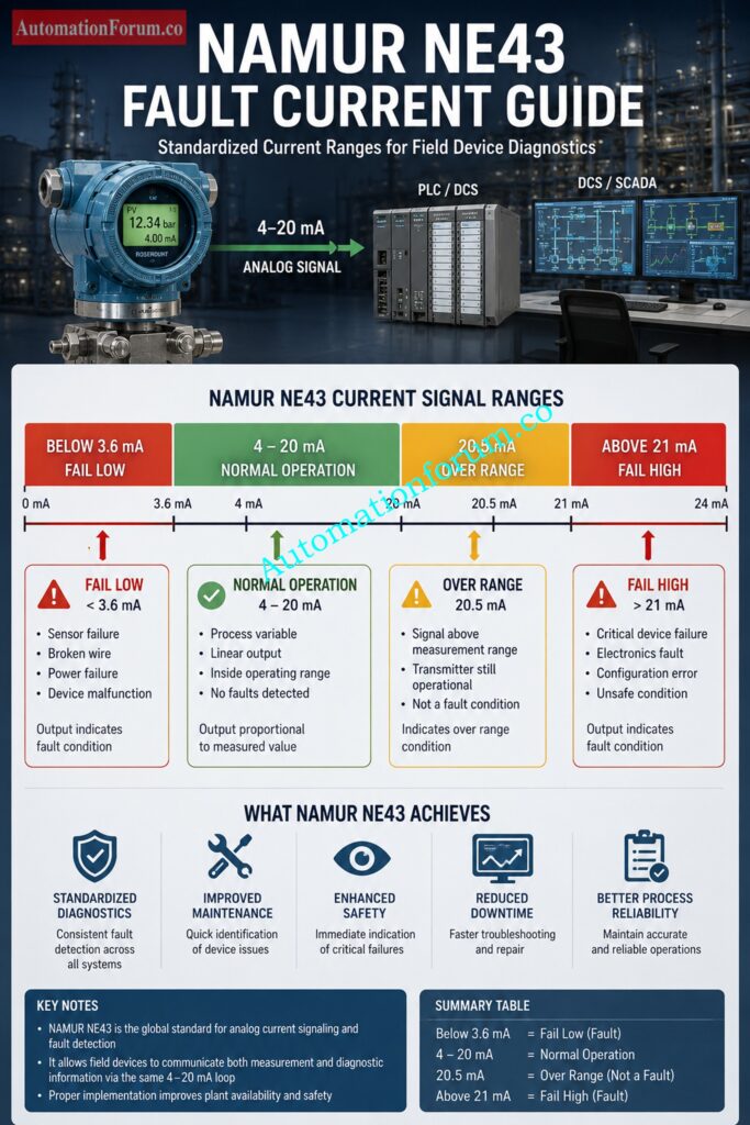

Understanding NAMUR NE43 Fault Signaling
Before standardized diagnostics existed, every transmitter manufacturer used different current values to indicate failures. This created confusion for operators and control system engineers.
NAMUR NE43 Current Signal Ranges
NAMUR NE43 defines specific current levels that represent abnormal conditions.
Current ValueMeaning
Below 3.6 mAFail Low
4 to 20 mANormal Measurement
Up to 20.5 mAOver Range
Above 21 mAFail High Diagnostic
Discover Why Industry Never Abandoned Live Zero: Why not use 0-20mA & 0-15psi instead of 4-20mA & 3-15psi?
When a pressure transmitter enters a fail high condition, it intentionally drives the output to approximately 21 mA to 22 mA.
This is not a measurement.
It is a message.
The transmitter is effectively telling the control system:
“I have detected a problem and my process value can no longer be trusted.”
Many modern DCS, PLC, and SIS systems are configured to recognize these fault currents and generate instrument failure alarms.

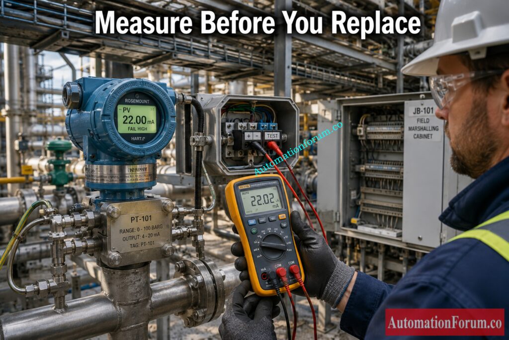

Measure Actual Loop Current
One of the most typical troubleshooting blunders is to trust the DCS display alone. The control system can only show what it understands from the input.
Before going any further , physically measure the loop current using a calibrated milliamp meter .
Measure the current directly at:
  • Transmitter terminals
  • Junction box
  • Marshalling cabinet
  • DCS input terminals
Compare the measured value to the DCS indication.
If the current reads 22 mA it is probably the transmitter or field loop that is the problem.
If the measured current is significantly different from the DCS measurement, check:
  • Analog input card configuration
  • Scaling errors
  • Wiring faults
  • Input channel problems
This simple test rapidly distinguishes field instrument difficulties from control system problems.
Typical Findings
Measured CurrentDCS ReadingEngineering Conclusion
22 mA22 mAField device issue
20 mA22 mADCS scaling issue
4 mA22 mAInput card problem
FluctuatingStableWiring or grounding issue

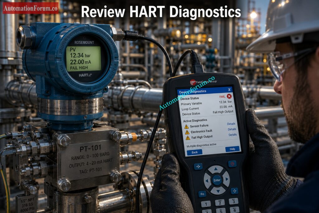

 Review HART Diagnostic Messages
If the local display does not have adequate information, connect a HART communicator and open the transmitter diagnostics.
Today smart transmitters regularly check hundreds of internal parameters and keep crucial failure data.
Review:
  • Device status
  • Sensor diagnostics
  • Electronics diagnostics
  • Output diagnostics
  • Configuration settings
  • Event history
  • Maintenance alerts
  • Fault logs
Keep a close watch on active alerts and events that have been logged recently.
For example:
  • Sensor Saturation might indicate overpressure.
  • Electronics Failure might be a damaged circuit.
  • Configuration Changed can be human error.
  • Maintenance activities can be forced.
Many faults can be diagnosed without removing the transmitter from service.
The event log often indicates the precise time the issue began . This allows engineers to match the fault with events in the process or maintenance actions.

During regular operation, a refinery reactor pressure transmitter suddenly indicated 22 mA.
Normal process pressure was established using a mechanical gauge.
HART diagnostics indicated sensor failure.
The sensing module was replaced and normal operation resumed.
The transmitter was accurately warning operators that its measurement could no longer be trusted.

Some of the errors engineers make are:
  1. Replacing the transmitter immediately
  2. Ignoring HART diagnostics
  3. Failing to measure actual current
  4. Assuming process overpressure
  5. Ignoring impulse line conditions
  6. Skipping calibration checks
  7. Overlooking wiring faults
  8. Ignoring grounding problems
  9. Missing configuration errors
  10. Trusting only the DCS display
Such errors raise downtime and maintenance expenses.

A 22 mA output is a transmitter diagnostic fault or fail-high situation, not a typical process measurement. It is often used to tell the control system that the gadget has identified an internal problem.
Sometimes not. A signal of 22 mA may indicate a transmitter failure, but can also be seen under over-range conditions or in some manufacturer specified diagnostic modes.
Yes.  If the process pressure is greater than the transmitter calibrated range, the device may drive the output above 20 mA or go into a fault state depending on the design.
NAMUR NE43 is an industry standard that defines fault signaling in 4–20 mA loops. A fail-high condition is typically represented by a current above 21 mA to indicate a device fault.
Check the loop current, check the real process pressure, and check HART diagnostics or local display fault warnings. Compare field measurements with DCS results to find anomalies.

Connect a calibrated milliamp meter in series with the loop and measure the actual current output. Readings should correspond to the pressure value according to the transmitter calibration range.

An over-range signal indicates the process value has exceeded the calibrated range, while a fail-high signal indicates a transmitter diagnostic fault. Both may produce currents above 20 mA but have different causes.
Yes. Many smart transmitters can output slightly above 20 mA during over-range conditions and up to approximately 22 mA during diagnostic fault conditions.
