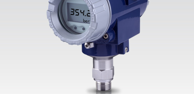

Differential Pressure Transmitter (DPT) are used to measure level in process tanks which compares the pressure measurement between
General Differential Pressure Transmitter Methods:
There is a variety of system arrangements for determining density from measurements of hydrostatic heads using differential pressure (DP) transmitters
DPT transmitter with a Wet Leg:
Applications with fluctuations in level or static pressure require compensation. Under these conditions, there are three basic density measurement arrangements.
