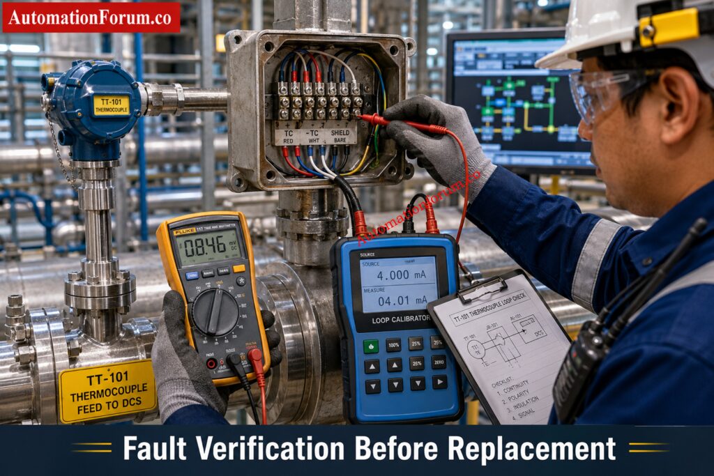

When a Thermocouple Should Be Replaced
A thermocouple should not be replaced just because the indication looks unusual once. The fault must be confirmed by checking the signal, the field wiring, the junction box, the extension cable, and the control system input.
Common Signs of a Faulty Thermocouple
Common signs include:
- Open circuit or faulty sensor
- Temperature reading stuck at one value
- Sporadic Variations
- Apparent drift or slow drift
- Incorrect temperature reading relative to neighboring instruments
- Terminal loose connection
- Ingress of moisture in junction box or head assembly
- Corrosion on terminal or sheath
- Mechanical damage to probe or lead wire
- Burnout from process overheating
- Damaged extension cable or incorrect cable material
How to Confirm the Fault Before Replacement
Check the signal at the transmitter or input card before replacing the sensor; check terminals, continuity, compare with a good reference and determine if the fault is in the sensor or the wiring line. This avoids unnecessary removal of a healthy thermocouple.
Refer the below link for the Testing a Thermocouple With a Multimeter: A Complete Field Guide for Instrumentation Engineers

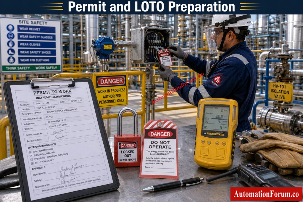

Permit to Work Requirements for Thermocouple Maintenance
No thermocouple replacement in a process area should begin without valid permits. The permit system protects both personnel and the plant.
Required Permits for Process Area Work
Depending on the job, obtain:
- Instrument maintenance permit
- Electrical isolation permit
- Hot work permit, if applicable
- Cold work permit
- Area entry permit
- Confined space permit, if applicable
Permit Checks and Validity Verification
Verify:
- Permit validity period
- Approval hierarchy
- Exact job scope
- Work location
- Identified hazards
- Control measures
- Responsible signatories
If the scope of work changes, cease work and revalidate the permission before starting work.

Isolation and Lockout Tagout Procedure
Thermocouple replacement often involves low-voltage circuits, but low voltage does not mean no hazard. Follow full lockout and tagout discipline.
Electrical Isolation Steps
- Identify the correct power source.
- Open the isolator.
- Remove fuse if applicable.
- Apply lock.
- Apply tag.
- Record the isolation in the permit or lock register.
Verification of Zero Energy
Confirm isolation by:
- Voltage testing
- Loop verification
- Dead testing
Never trust a switch position alone. Prove zero energy before touching wiring.
LOTO Documentation and Records
Maintain:
- Lock register entry
- Isolation certificate

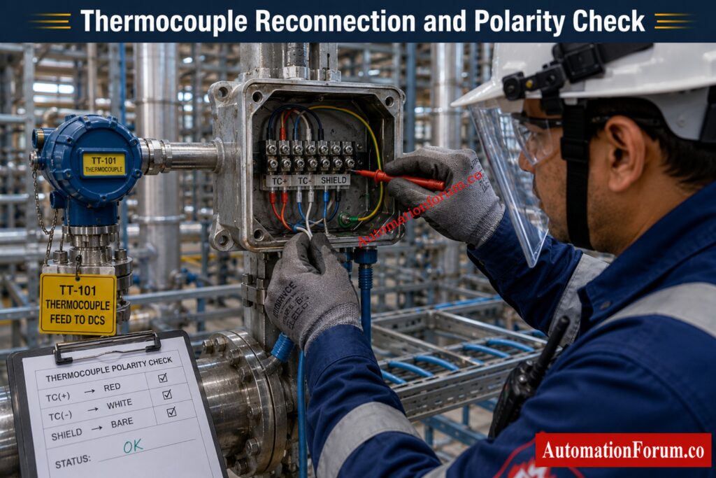

Thermocouple Wiring Disconnection Procedure
Before Disconnecting the Sensor
- Take a clear photograph of the terminal arrangement if possible or make proper marking and keep record of connection data.
- Verify terminal numbers
- Check polarity
- Mark conductors if required
Cable Removal and Terminal Inspection
- Loosen the terminal carefully
- Protect conductor ends from damage
- Inspect the cable condition
- Check for extension cable deterioration
Why Thermocouple Polarity Matters
Thermocouple polarity is critical. Reversed polarity may not always create a complete failure, but it can give unstable or misleading readings. Use the correct extension wire for the thermocouple type.

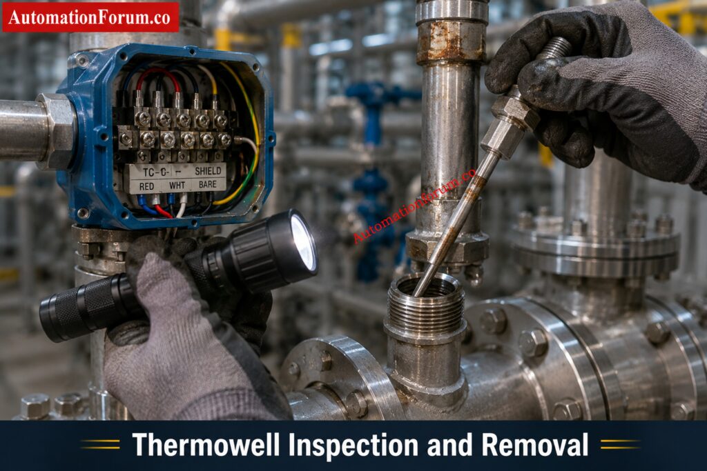

Safe Removal of the Faulty Thermocouple
Removal Steps from Thermowell or Process Connection
- Confirm the process connection is safe to open.
- Gradually loosen fitting.
- Remove the sensor gently.
- Do not bend the probe
- Do not force the sensor if it is stuck.
- Protect the thermowell from mechanical damage.
Key Hazards During Sensor Removal
- Residual heat
- Seized sensor inside thermowell
- Corrosion on threads or fittings
- Mechanical stress during extraction
If the probe does not come out smoothly, stop and inspect. Forcing the sensor may damage the thermowell or break the replacement job into a larger repair.

Thermowell Inspection and Verification
Thermowell inspection is not optional. A new thermocouple installed into a damaged thermowell will still give poor results.
Mechanical Condition of the Thermowell
Inspect for:
- Corrosion
- Erosion
- Pitting
- Cracks
Internal Cleanliness and Obstruction Check
Check for:
- Bore cleanliness
- Obstructions
- Moisture ingress
- Rust or debris inside the well
Dimensional Verification and Insertion Length
Confirm:
- Thermowell insertion length
- Bore diameter
- Sensor fitment
- Thread condition
Insertion length directly affects response time and measurement accuracy. If the sensor tip is not properly located in the well, the reading can lag the real process temperature. A sufficient depth of immersion and correct disposition of the thermowell are necessary for a stable measurement of temperature.
Thermowell Integrity Assessment
Where plant procedures require, inspect the thermowell for signs of thinning, vibration damage, cracking, excessive corrosion, or process erosion. A damaged thermowell can fail mechanically and may become a process safety hazard. Replace the thermowell if its integrity is doubtful.

Reconnection of Thermocouple Wiring
Correct Terminal Connection and Polarity
- Terminate on the correct terminal
- Maintain correct polarity
- Verify shield grounding
- Inspect cable glands
- Check all terminal tightness
Thermocouple polarity and proper extension cable selection are essential for signal integrity and measurement accuracy.
Common Wiring Mistakes to Avoid
- Reversed polarity
- Loose terminal screws
- Wrong extension wire type
- Missing shield termination
- Damaged gland sealing
- Cross-wiring in junction box
Each of these can create noise, drift, or complete loss of indication.
Post-Installation Verification and Loop Testing
Local Verification at the Field Device
- Check terminal voltage
- Confirm continuity
- Measure sensor resistance and millVolt mV where applicable
- Inspect the junction box again
Control System Verification in DCS, PLC, or SCADA
- Confirm DCS indication
- Check PLC signal if applicable
- Verify SCADA display
- Observe trend stability
Functional Verification and Signal Stability Check
- Compare with nearby temperature elements
- Confirm process temperature consistency
- Watch for signal stabilization after installation
The goal is not only to restore indication, but to restore trustworthy indication.
