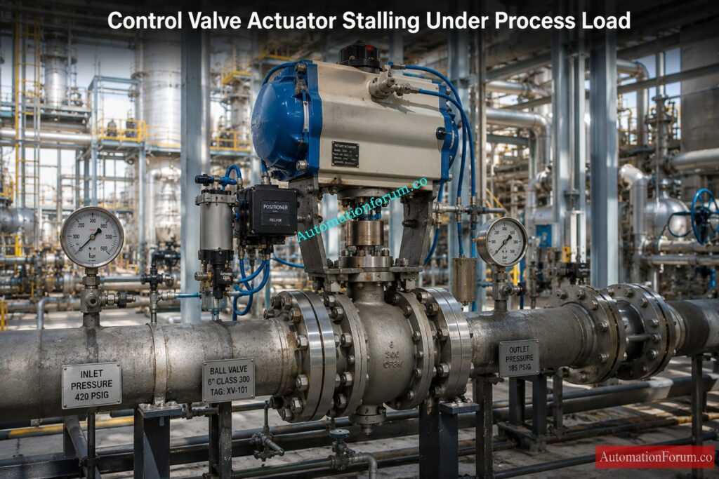

How Valve Torque Causes Control Valve Actuator Failure
An actuator converts energy into mechanical movement. A pneumatic actuator uses air pressure, while an electric actuator uses electrical power and a motor. Regardless of the actuator type, the available output torque must overcome the resistance produced by the valve.
An undersized actuator can appear healthy during a no load test. Once the valve is connected to the process and exposed to actual differential pressure, temperature and fluid conditions, the required torque may increase significantly.
Recover Stuck Control Valves Before Expensive Process Disruptions: How to do maintenance on struck control valve?
Typical symptoms include:
  1. The actuator stalls before reaching the required position.
  2. The valve fails to open from the closed position.
  3. The valve does not close completely.
  4. Valve movement becomes slow or inconsistent.
  5. The actuator experiences excessive loading.
  6. Valve shaft, coupling or internal components experience abnormal stress.
  7. Repeated operation causes premature wear.
  8. Emergency shutdown operation becomes unreliable.

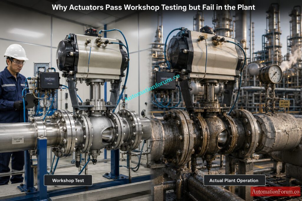

This difference between workshop testing and plant operation is especially important during commissioning. A valve that passes a functional test without process load may still have an actuator sizing problem when placed into service.

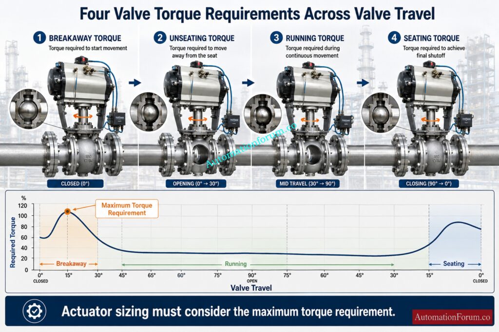

Four Types of Valve Torque Every Engineer Must Understand
Breakaway torque is the torque required to start moving a stationary valve from its closed or resting position.
This can be one of the highest torque requirements because static friction must first be overcome. Seat loading, pressure effects, deposits, corrosion and long periods without movement can increase the required breakaway torque.
An actuator selected using only running torque may therefore fail to move the valve when the plant operator first commands it to open.
Running torque is the torque required while the valve is moving through its operating range.
The required value depends on valve design, process pressure, fluid properties, seat construction and mechanical condition. Running torque may be lower than the torque required to initially break the valve free.
For control valve actuator sizing, engineers should obtain the complete torque data rather than assuming that one torque value represents the entire valve travel.
Uncover Hidden Causes Behind Persistent Control Valve Hunting: What are the main causes of control valve hunting?
Seating torque is the torque required to move the valve into its final closed position and achieve the required shutoff.
This is especially significant when tight shutoff is required. If the actuator cannot generate adequate torque near the final closing position, the valve may stop before reaching the required position and allow unwanted process flow.
Excessive seating torque can also create unnecessary mechanical stress, so the actuator and valve must be selected as a compatible system.
Unseating torque is the torque required to move a closed valve away from its seat.
Pressure differential and seat friction can make this point particularly demanding. A valve may remain closed successfully but require substantially more torque to begin opening.
The actuator therefore needs sufficient output torque at the most demanding point of the complete valve travel.

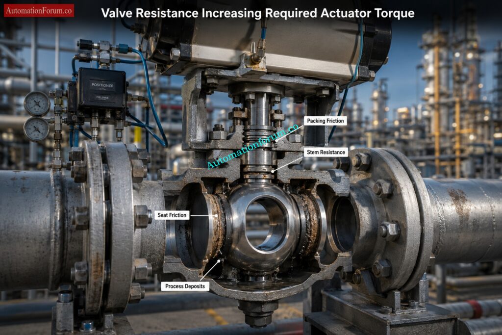

What Causes High Valve Torque?
Valve torque is not a fixed number. Actual requirements can change with operating conditions and valve condition.
Effect of Valve Size on Torque
Larger valves generally have greater mechanical requirements, but size alone does not determine actuator torque. Valve design, pressure, seat construction and service conditions must also be considered.
Find Hidden Causes Behind Post Overhaul Valve Passing: How to Troubleshoot a Control Valve Passing Problem after Overhauling – Complete Root Cause Analysis
Differential pressure across the valve can significantly affect the force acting on internal components. A valve that moves easily with low pressure differential may require much greater torque under full process pressure.
This is one reason why actuator selection based only on workshop conditions can produce failures after commissioning.
Temperature can change material properties, clearances, lubrication conditions and seat friction. High temperature service may therefore change the torque requirement from the original design condition.
Understand Bench Set Errors Before Valve Performance Problems: Why is Control Valve Actuator Bench Set Important ?
Viscous fluids can increase resistance to valve movement. Heavy fluids may create greater resistance compared with low viscosity fluids, depending on valve design and service conditions.
Seat material has a direct influence on friction and operating torque. Different seat designs can produce different torque characteristics even when the valve size and pressure class are similar.
Corrosion, scale, contamination and process deposits can increase friction and restrict valve movement. A valve that originally operated correctly can develop high torque after extended service.
Packing friction around the valve stem and friction at the seat can add significant resistance. During troubleshooting, engineers should not assume that the actuator is always responsible for the failure.

Valve torque can change throughout the complete valve travel.
  • A typical torque profile may show high breakaway torque at the beginning of movement, lower running torque while the valve travels and increased torque again near the final seating position. The exact curve depends on the valve type and operating conditions.
  • This torque curve is extremely useful during actuator selection.
  • Using an average torque value can result in an undersized actuator because the actuator may need to overcome a much higher torque at one particular position.
  • For example, an actuator may have sufficient torque for most of the valve travel but fail when the valve begins opening because the breakaway requirement is higher. Another valve may operate normally during opening but fail to achieve complete closure because the seating requirement is higher.
  • Technical bid evaluations should therefore examine the valve torque requirement across the complete operating range.

Practical Example of Control Valve Actuator Failure Due to High Torque
Consider a quarter turn ball valve that operates correctly during workshop testing. After installation in a process line, the actuator struggles to open the valve.
The control signal reaches the actuator correctly, and the actuator initially begins to move. However, it stops before reaching the required position.
An investigation shows that the valve is operating with a significantly higher differential pressure than during workshop testing. Additional seat friction and process deposits have also increased resistance.
The actuator was originally selected using a lower torque requirement. The actuator therefore has enough torque for part of the operating cycle but not enough to overcome the maximum torque requirement during actual service.
The engineer should first confirm the valve torque requirement under the actual pressure and process conditions. The valve condition should then be inspected for deposits, seat problems and mechanical restriction.
If the valve is mechanically healthy, the actuator should be evaluated against the maximum required torque and an appropriate engineering safety margin. Only then should actuator replacement or modification be considered.
