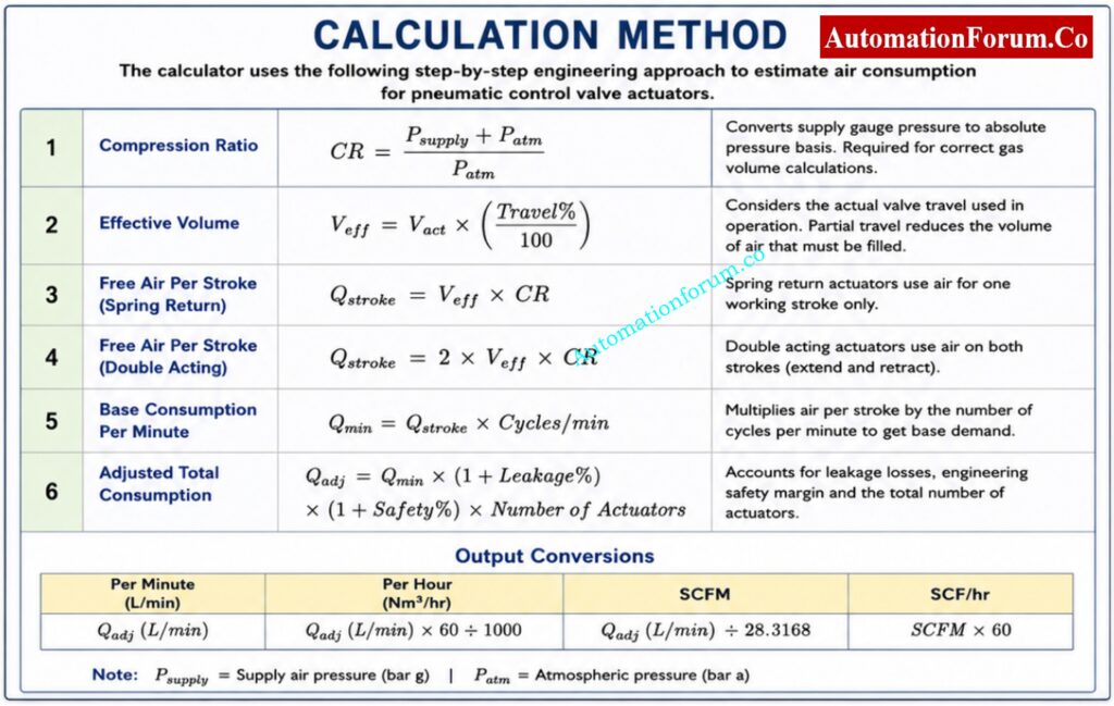

CR = (P_supply + P_atm) / P_atm
Compression Ratio — converts gauge pressure to free air multiplier
V_eff = V_act × (Travel% / 100)
Effective Volume — adjusts for partial valve travel
Q_stroke (SR) = V_eff × CR
Spring Return — free air per stroke (one chamber only)
Q_stroke (DA) = 2 × V_eff × CR
Double Acting — both chambers consume air each cycle
Q_min = Q_stroke × Cycles/min
Base flow per minute (per actuator, before corrections)
Q_adj = Q_min × (1+L%) × (1+S%) × N
Adjusted total — leakage (L%), safety (S%), count (N)

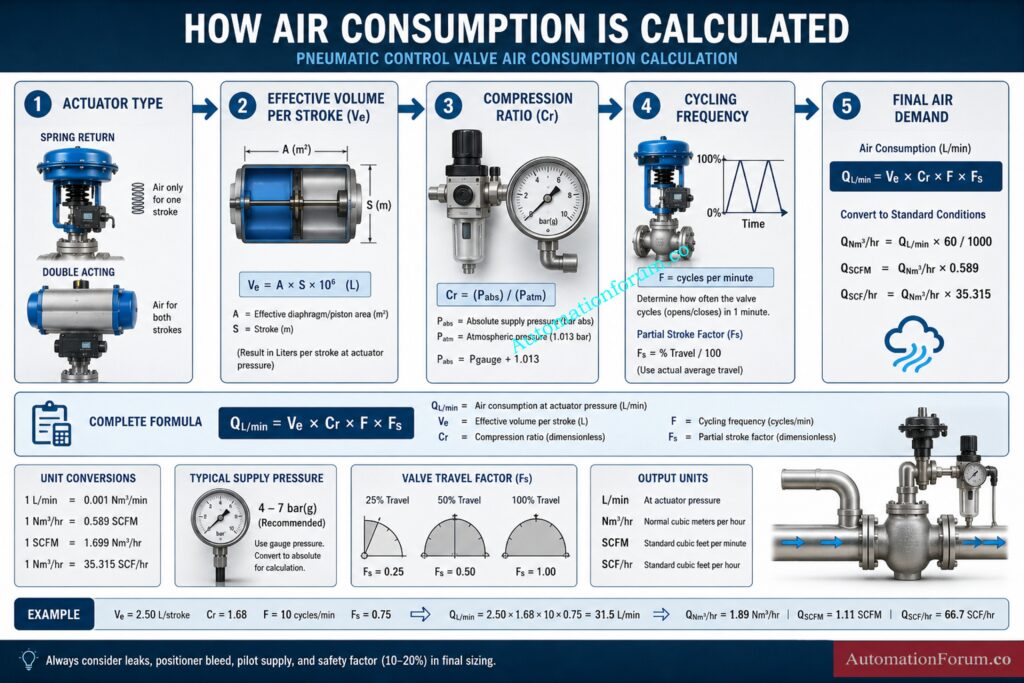

A pneumatic actuator moves a valve by filling one or more air chambers. That air has to be supplied from the instrument air network, and the consumption depends on the actuator type, chamber volume, pressure, and how often the valve strokes.
The key point is that compressed air is not normally counted only by the volume inside the actuator chamber. It must be corrected to a free air basis so the engineer can compare the demand with compressor and air system capacity.
A pneumatic actuator may have a small physical chamber volume, but the mass of air inside that chamber depends on the absolute pressure. When air is compressed, the same mass occupies a smaller volume. For design and utility calculations, engineers usually convert this to free air equivalent at reference atmospheric conditions.
That is why the calculator uses compression ratio.
Gauge pressure alone is not enough for gas volume calculations because gauge pressure does not include atmospheric pressure. Air behaves according to absolute pressure, so the correct pressure basis is:
P absolute = P gauge + P atmospheric
This is why the calculator adds atmospheric pressure to supply pressure before applying the compression ratio. That is the right engineering basis for a demand estimate.

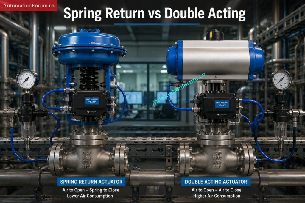

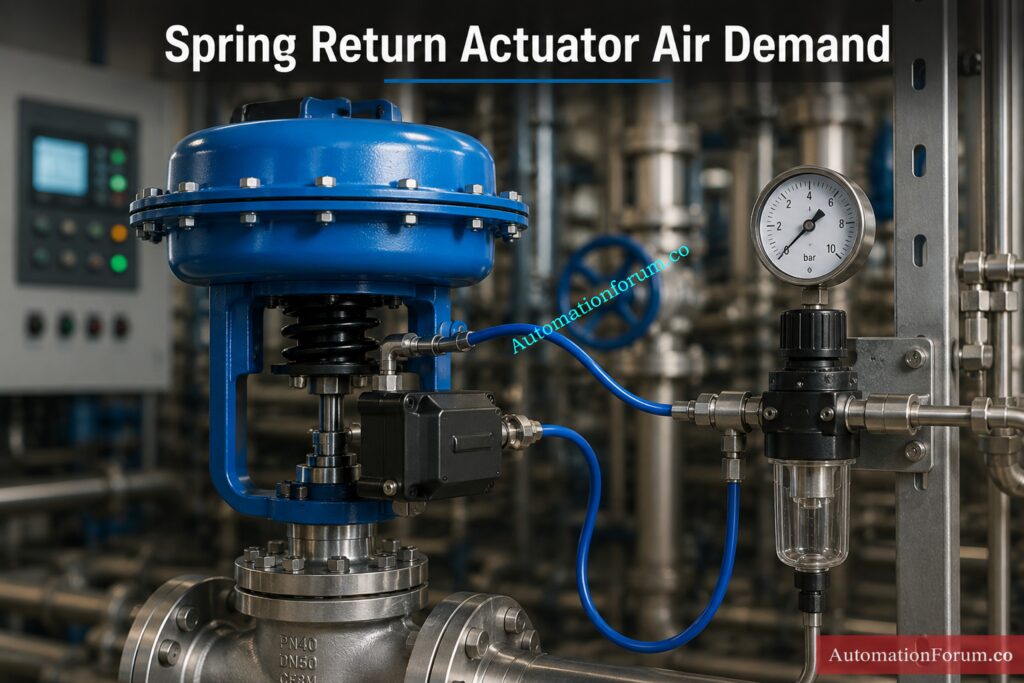

Spring Return vs Double Acting Actuator Air Consumption
A spring return actuator uses air for one stroke and a spring for the return stroke. A double acting actuator uses air on both strokes, so the air demand is approximately doubled for the same chamber volume and cycle.
That difference is fundamental, and the calculator accounts for it directly.
If a valve travels only part of its full stroke, the effective volume that must be filled is lower. Likewise, if the valve cycles more frequently, the air demand per minute rises proportionally. In real plants, these two factors often explain why an actuator that looks modest in theory still creates a meaningful air load in service.

Calculation Method for Air Consumption of Pneumatic Control Valves
The Air Consumption Calculator is an engineering approach to determine the quantity of instrument air consumed by pneumatic control valve actuators during operation on a step-by-step basis. Proper computation of air consumption is critical to correctly size instrument air headers, determine compressor capacity, choose air receivers, estimate utility loads and ensure overall pneumatic system reliability.
The first step is to determine the compression ratio (CR). When doing compressed air calculations you must use absolute pressure not gauge pressure . This means adding the ambient pressure to the supply pressure . The compression ratio is defined as compressed air to free air conditions and is utilized to convert actuator volume to comparable free air usage.
Then the calculator determines the Effective Actuator Volume (Veff). In many applications, control valves do not operate during the whole stroke in normal operation. Therefore, the effective volume of the actuator used for the movement is changed according to the valve travel percentage given by the user. This provides a more realistic estimate of air demand than assuming complete stroke action at all times.
Download the Excel Tool That Simplifies Valve Sizing: Control Valve Sizing Excel Tool Without Iteration
The calculator then calculates the Free Air Consumption per Stroke (Qstroke). Spring return actuators perform the return movement using the actuator spring, so compressed air is only used for the powered stroke. For double acting actuators compressed air is required for both the extension and retraction strokes, hence the air consumption is typically twice the amount of a comparable spring return actuator.
The volume of air required for one stroke is calculated and multiplied by the number of operational cycles in a minute to arrive at the Base Air Consumption Rate (Qmin). This is the theoretical demand for air, before taking into consideration real world working conditions.
The calculator adds a Leakage Factor and a Safety Factor to offer a practical engineering estimate. Leakage allowances provide for small losses through fittings, tubing, actuator seals, positioners and pneumatic accessories. The safety factor gives an additional engineering buffer to allow for future process modifications, operating uncertainties and transient demand variations.
The finally adapted air usage is multiplied with the entire number of actuators working under similar conditions. Calculated value is then transformed into generally used engineering units such as L/min, Nm 3 /hr, SCFM and SCF/hr. This enables engineers to compare the calculated demand directly with compressor capacities, air receiver volumes and instrument air system specifications.
Such systematic method allows a realistic estimation of the pneumatic actuator air consumption, while making the design, commissioning, maintenance and troubleshooting applications straightforward.

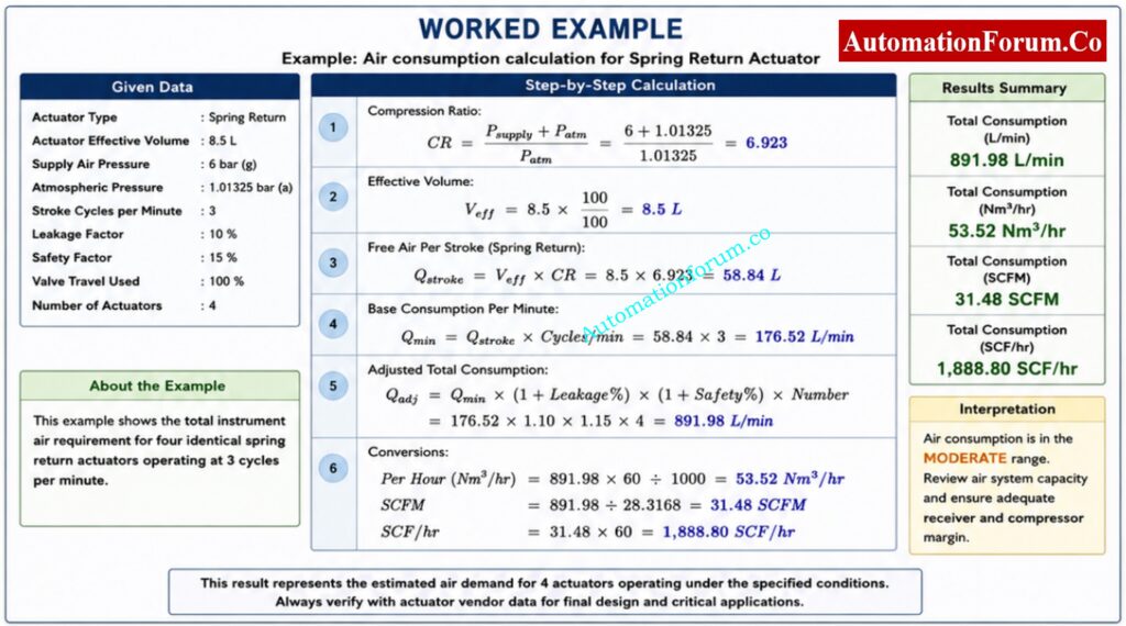

Worked Example of Pneumatic Control Valve Air Consumption
The following example shows how the Air Consumption Calculator may be used to estimate instrument air demand for a set of pneumatic control valve actuators in a process plant.
Let’s say we have a control valve controlling process flow in a chemical processing unit and a spring return pneumatic actuator is attached to it. The actuator has an effective chamber volume of 8.5 liters and operates on a 6 bar(g) instrument air supply. In typical operation it cycles about 3 times per minute. The estimate includes a 10% leakage allowance and a 15% engineering safety margin to cater for practical plant circumstances. The plant has four identical actuators, all operating under the same conditions.
Access Hundreds of Engineering Calculators for Faster Design: 100+ Online Instrumentation Calculators and Engineering Tools
ParameterValue
Actuator typeSpring return
Actuator effective volume8.5 L
Supply air pressure6 bar(g)
Atmospheric pressure1.01325 bar(a)
Stroke cycles per minute3
Leakage factor10 percent
Safety factor15 percent
Valve travel used100 percent
Number of actuators4
The compression ratio converts the compressed air volume to an equivalent free air basis.
CR = (Psupply + Patm) ÷ Patm
CR = (6 + 1.01325) ÷ 1.01325
CR = 6.923
This means the air inside the actuator is compressed approximately 6.9 times compared to atmospheric conditions.
The valve is assumed to travel through its full stroke.
Veff = Vact × (Travel% ÷ 100)
Veff = 8.5 × (100 ÷ 100)
Veff = 8.5 L
Since this is a spring return actuator, air is required only for the powered stroke.
Qstroke = Veff × CR
Qstroke = 8.5 × 6.923
Qstroke = 58.84 L
Each actuator stroke therefore consumes approximately 58.84 liters of free air.
Analyze Valve Flow Behavior Using Advanced Pressure Tools: Control Valve P1 and P2 vs. Flow Excel Designing Tool (Downloadable)
The actuator cycles three times per minute.
Qmin = Qstroke × Cycles/min
Qmin = 58.84 × 3
Qmin = 176.52 L/min
This represents the theoretical demand for one actuator before allowances are applied.
Qadj = Qmin × (1 + Leakage%) × (1 + Safety%) × Number of Actuators
Qadj = 176.52 × 1.10 × 1.15 × 4
Qadj = 891.98 L/min
The total estimated air demand for all four actuators is therefore 891.98 L/min.
Per Hour Consumption
891.98 × 60 ÷ 1000 = 53.52 Nm³/hr
SCFM
891.98 ÷ 28.3168 = 31.48 SCFM
SCF/hr
31.48 × 60 = 1,888.80 SCF/hr

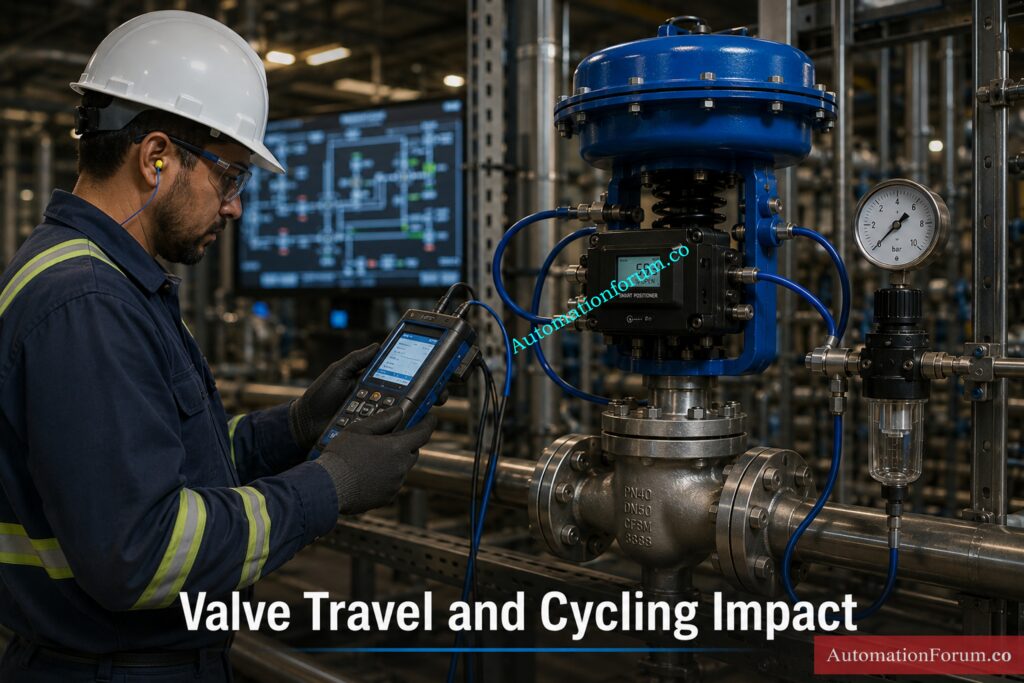

  1. Is the valve cycling too often
  2. Is the actuator oversized
  3. Is the supply pressure higher than needed
  4. Is leakage significant
  5. Are multiple valves stroking at the same time
  6. Is the actual travel much less than assumed
