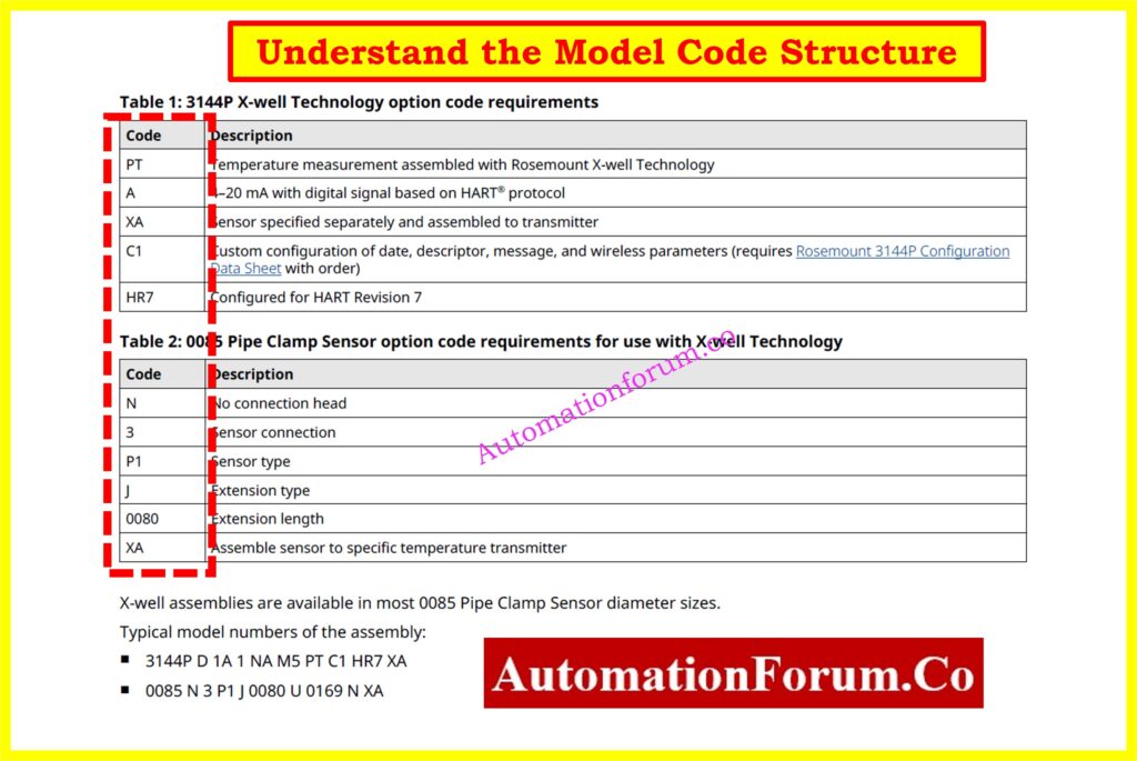

Step 3. Understand the Model Code Structure
Model codes specify exactly how the transmitter is built.
For example:
3144P D1 A 2 I5 M5 PT XA C1 HR7
Breakdown:
- 3144P: Model series
- D1: Aluminum dual-compartment housing
- A: 4-20 mA HART output
- 2: Dual sensor input
- I5: Intrinsically safe approval (USA)
- M5: LCD display
- PT: X-well Technology
- XA: Assembled with sensor
- C1: Custom configuration
- HR7: HART revision 7
When ordering, this model code ensures you receive exactly what you need.

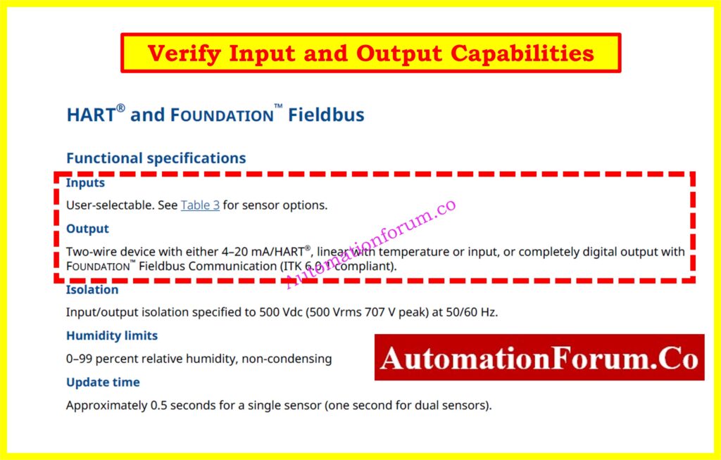

Step 4. Verify Input and Output Capabilities
Input Support:
- RTDs (Pt100, Pt1000, etc.)
- Thermocouples (types J, K, T, etc.)
- Millivolt and resistance inputs
Output Protocols:
Choose HART for compatibility with most PLCs and DCSs, or Fieldbus for smart diagnostics and digital communication in advanced systems.

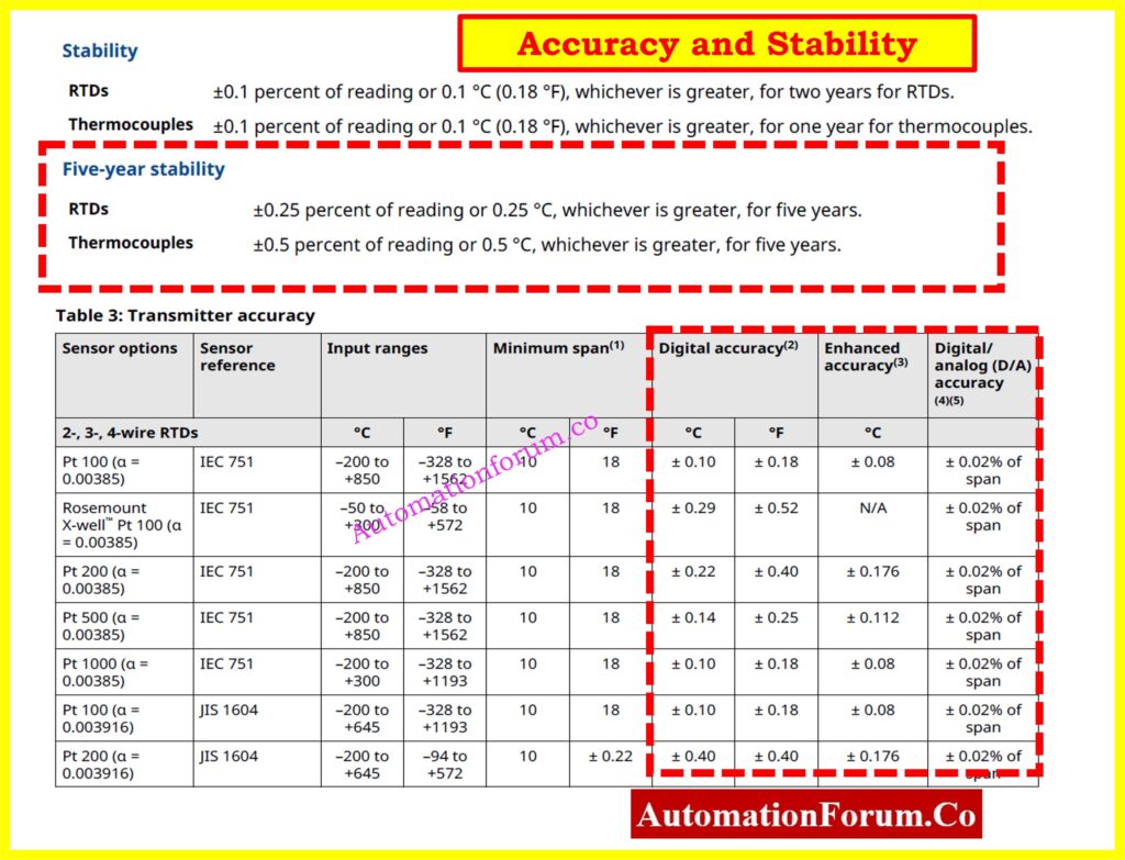

Step 5. Accuracy and Stability
For RTDs (Pt100, IEC 751):
- Standard Digital Accuracy: ±0.10 °C
- Enhanced (P8 Option): ±0.08 °C
- D/A Conversion Accuracy: ±0.02% of span
For Thermocouples:
- Accuracy ranges from ±0.25 to ±0.75 °C depending on type
Long-Term Stability:
- RTDs: ±0.1 °C over 2 years
- Enhanced option: ±0.25 °C over 5 years
Tip: Use transmitter-sensor matching (Option C2) to further improve measurement accuracy.

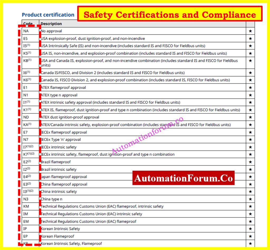

Step 6. Safety Certifications and Compliance
Depending on your site requirements, the transmitter may need to meet certain safety standards.
The 3144P supports:
- Intrinsically safe, explosion-proof, and non-incendive certifications: ATEX, IECEx, FM, CSA, EAC
- Functional Safety (SIL 2/3) compliance as per IEC 61508
- Custom NAMUR fail-safe current settings for fault conditions
Always choose the correct certification code (e.g., I5, K5, E1) based on the intended installation area.

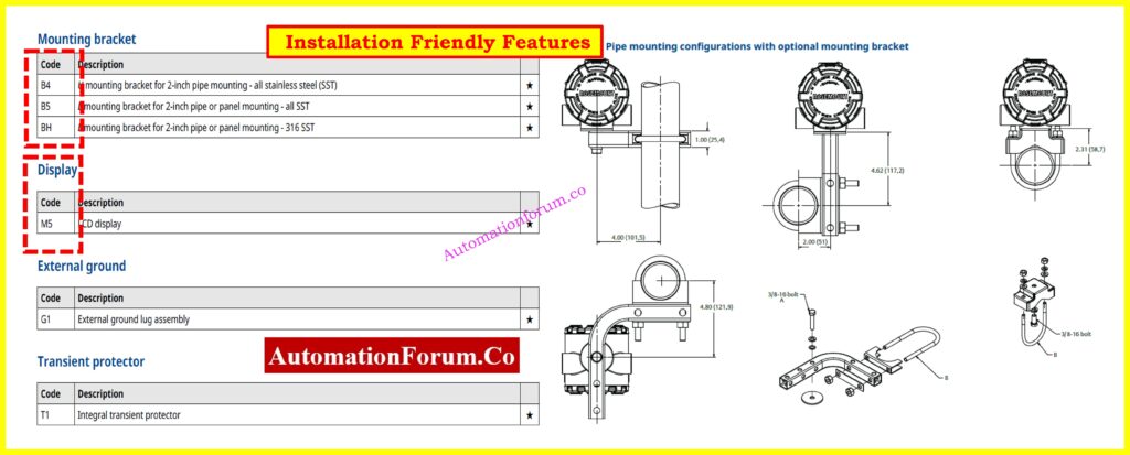

Step 7. Installation Friendly Features
The Rosemount 3144P includes several features to make field installation easier:
- Dual-compartment housing protects electronics from moisture
- Optional LCD display (M5) for local monitoring
- Multiple conduit entry types: NPT, M20, PG13.5, JIS
- Mounting kits for pipe or panel mounting
- Smart functions like Hot Backupâ„¢, Drift Alerts, and Fail-Safe Modes
When replacing an older unit, verify mounting and housing to ensure compatibility.

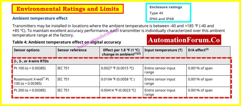

Step 9. Environmental Ratings and Limits
Know the environmental limits before installation:
- Ambient Operating Temperature: -40 to +85 °C
- Storage Temperature: -60 to +121 °C
- Ingress Protection: IP66/IP68, Type 4X
- Vibration Resistance: 3 g from 60 to 2000 Hz
Use stainless steel housing (Options D5-D8) for corrosive or offshore environments.

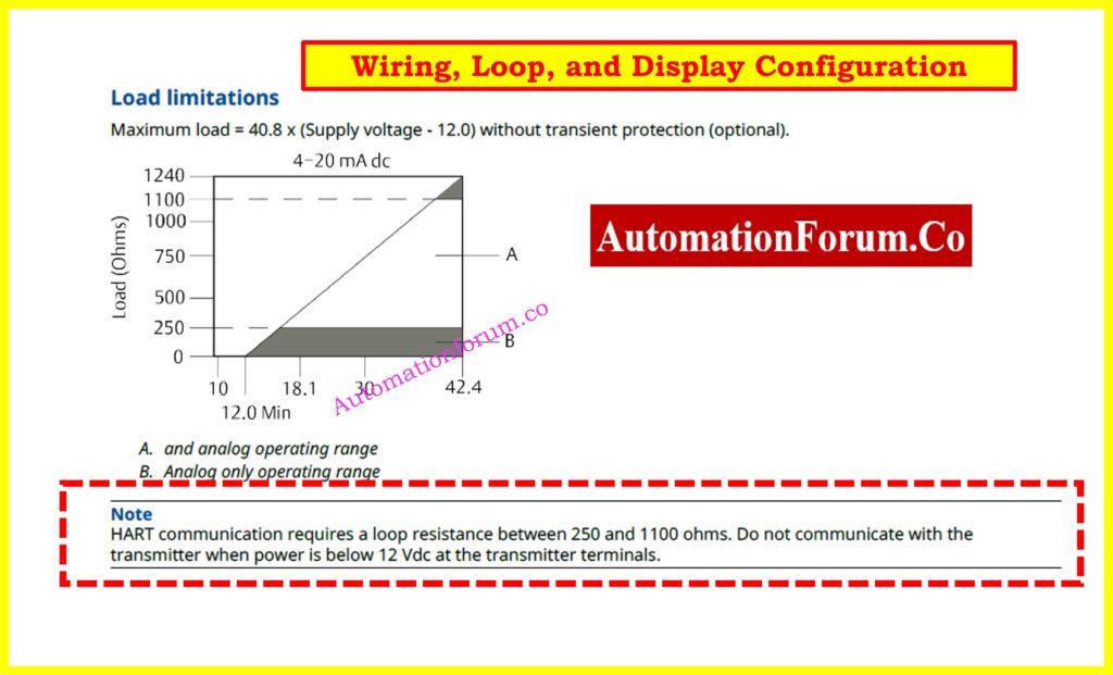

Step 10. Wiring, Loop, and Display Configuration
HART Loop Requirements:
- Loop resistance: 250-1100 ohms
- Supply voltage: 12 to 42.4 VDC
Display (M5 Option):
- Shows temperature (°C/°F), mA output, sensor values
- Configurable messages and bar graphs
Use a Field Communicator or AMS Device Manager for configuration or diagnostics.

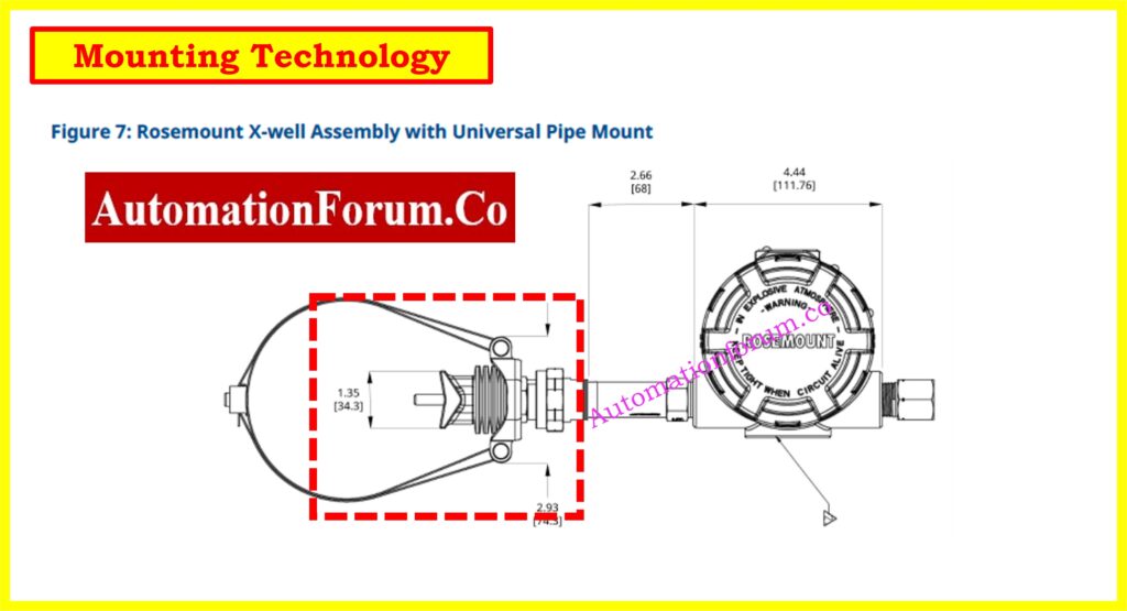

Step 11. Rosemount X-wellâ„¢ Technology
For applications where process penetration is not allowed:
- X-well Technology calculates process temperature from surface and ambient readings
- No need for a thermowell or insertion sensor
- Ideal for small pipes or corrosive/high-pressure lines
- Requires clamp-on sensor (e.g., Rosemount 0085)
X-well reduces installation time and increases safety.

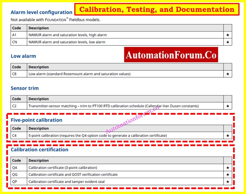

Step 12. Calibration, Testing, and Documentation Options
Common options:
- Q4: 3-point calibration certificate
- C4: 5-point calibration
- QT: Functional Safety Certification
- QG: GOST compliance and calibration cert
- QP: Tamper-evident seal
Check calibration records when replacing an instrument to ensure accuracy and consistency.

Confirm ambient and storage temperature ranges, IP ratings, and vibration specs are suitable for your installation area. - Replaces old unit directly?

- Include factory configuration (C1), calibration (Q4), or labeling (QP) in your order

What is the most critical section to look at when selecting a transmitter?
The model code structure part is the most important since it tells you everything about the transmitter’s setup, including its housing, communication type (HART or Fieldbus), sensor input type, display choice, and certifications. If anything doesn’t match up here, it could cause problems with installation or operation.

What safety certifications should I look for?
It depends on where you are going to install it. ATEX, IECEx, FM, CSA, and SIL (2 or 3) are some of the most common certifications. Always check the categorization of your location (for example, hazardous area) and pick a transmitter that fits, using the right approved option codes like I5, K5, or E1.
How do I confirm loop and power requirements for a HART transmitter?
The datasheet says that a 3144P HART device that uses 4-20 mA needs:
- Supply voltage: 12-42.4 VDC
For correct digital communication and analog signal transfer, certain parameters must be met.
