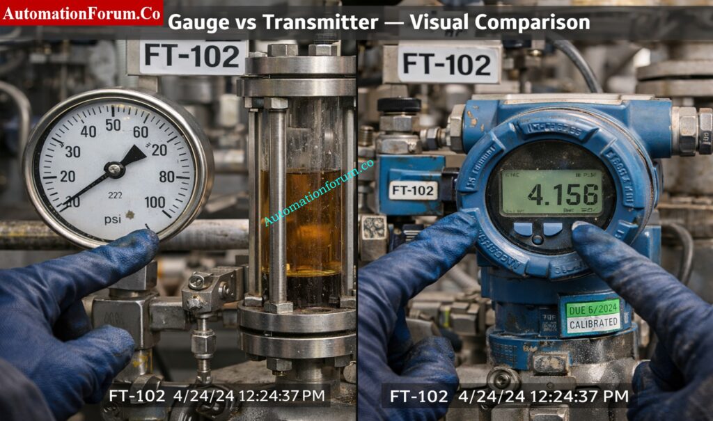

Local Gauge and Sight Glass Verification Method
When to Use Local Gauge for Pressure Level and Temperature Cross Check
Use local gauges and sight glasses for quick field checks of pressure level and temperature. They are simple to read and require no electronics.
Accuracy Limitations of Mechanical Gauges
Mechanical gauges and sight glasses are robust but coarse in accuracy typically within one to five percent. They are prone to parallax and blocked impulse tubing but are practical for rapid checks.
Practical Field Example of Gauge vs Transmitter Comparison
A differential pressure transmitter for level cross checked against a sight glass on the same vessel may show disagreement. If the sight glass shows half full but the transmitter shows full investigate impulse tubing and density compensation in the transmitter.

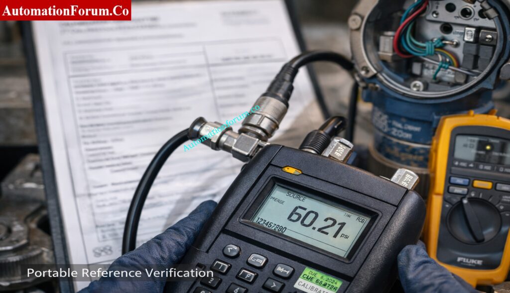

Temporary Reference Instrument Verification Using Portable Calibrator
Why Portable Calibrators Provide Traceable Verification
A portable instrument provides a calibrated reference for verification. Common tools include pressure calibrators clamp on ultrasonic meters pitot tubes and portable temperature calibrators. Use these when precise comparison is needed.
Accuracy Expectations and Calibration Certificate Requirements
Portable calibrators often have traceable accuracy better than one percent. Correct connection and stable process conditions are required. Check the calibration certificate before use.
Field Example of Transmitter Output Validation Using Reference Instrument
A portable pressure calibrator applied to the impulse port confirms or rejects the transmitter output. If the calibrated device agrees with the local gauge but not with the transmitter suspect configuration or transmitter failure.

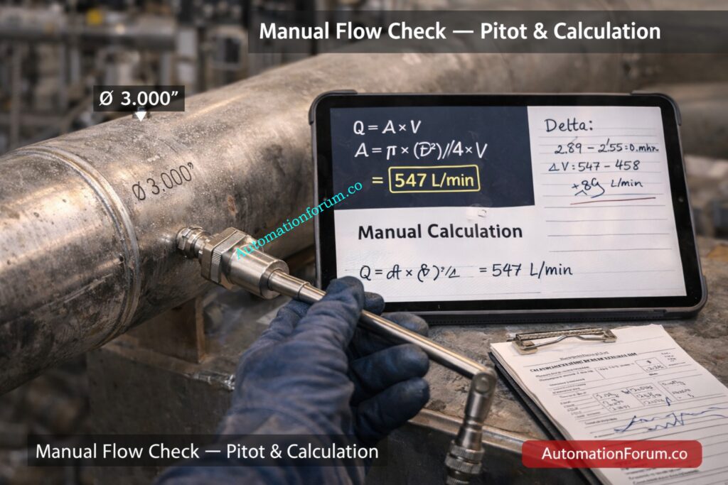

Manual Calculation Method for Flow and Level Cross Check
Purpose and when to use
Manual calculations use fundamental physical relationships to provide an independent check. Use area times velocity for flow checks and hydrostatic head for level checks when other references are not present.
Accuracy and limitations
The accuracy depends on input data quality such as pipe internal diameter velocity measurement and fluid density. Treat manual calculation as a sanity check and record assumptions.
Example
Calculate flow in a three inch pipe using measured velocity and pipe internal diameter then compare with the flow transmitter reading to identify possible span issues or two phase flow.

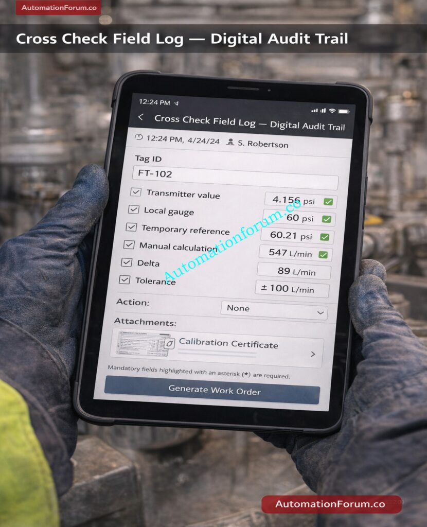

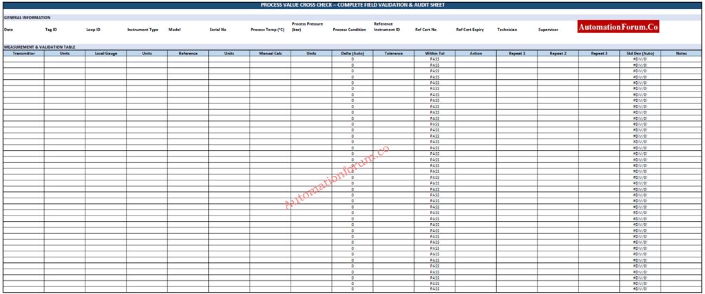

Field Log Template for Process Value Cross Check Documentation
| Timestamp | Tag | Transmitter value | Local gauge | Temporary reference | Manual calculation | Delta | Condition notes | Action |
| 10 12 | PT 101 | 3.45 bar | 3.40 bar | 3.42 bar | n a | 0.05 bar | Impulse tubing wet | Monitor |
| 10 16 | FT 205 | 547 litres per minute | n a | 552 litres per minute | 547 litres per minute | 5 litres per minute | Pipe vibration | Check flowmeter span |
How to Record Delta and Tolerance
Set site specific tolerance based on criticality. Typical examples are one to two percent for critical control loops three to five percent for monitoring loops and two to five percent for mechanical gauges. Convert percentage tolerances to engineering units at normal operating points and record them.

Case Study – Flow Transmitter Validation Using Manual Calculation and Pitot Measurement
Field Scenario Description
- Scenario FT 205 a differential pressure based flow transmitter reports five hundred and sixty litres per minute.Â
- Operations doubt the reading. A pitot temporary reference monitors the speed of a fluid in a three-inch pipe at two meters per second.
- To find volumetric flow, multiply the area by the velocity and compare the results.
Step by Step Flow Calculation
- The pipe’s diameter is three inches, which is seventy-six point two millimeters or zero point zero seven six two meters. To find Area A, multiply pi by the diameter squared and then divide by four.
- The square of the diameter is zero point zero seven six two times zero point zero seven six two, which is zero point zero zero five eight zero six four four.
- To get zero point zero one eight two four one, multiply by pi. Then, to get zero point zero zero four five six zero three seven square metres, divide by four.
- To get zero point zero zero nine one two zero seven four cubic metres per second, multiply the area by the speed of two metres per second. Convert to litres per minute multiply by one thousand then by sixty to obtain approximately five hundred and forty seven litres per minute.
Refer the below link for the Free Instruments Calibration Procedures: 60+ Step-by-Step Methods for Pressure, Temperature, Flow & Level
Delta Analysis and Acceptance Decision
- The calculated flow of approximately five hundred and forty seven litres per minute compared with the transmitter five hundred and sixty litres per minute yields a delta of thirteen litres per minute or two point four percent.Â
Recommended Corrective Actions for Marginal Results
- For a critical loop with a tolerance of one to two percent this is marginal.Â
- Actions include repeating the measurements confirming pitot calibration checking pipe internal diameter and verifying there is no two phase flow present.Â
- Log results attach calibration certificate images and schedule corrective action if required.

Digital Documentation and Mobile Data Capture for Process Value Cross Check
Benefits of Structured Digital Forms
- Using mobile forms to collect data cuts down on transcribing mistakes and makes it easier to follow the process value cross-check.
- Technicians can now enter values immediately into a structured digital form on a tablet or industrial mobile device instead of writing them down in a notebook and then entering them into a maintenance system.
Mandatory Fields for Traceability and Compliance
This method makes sure that:
- Recording timestamps automatically
- Identifying technicians through login
- Required to fill out important fields
- Directly attaching photos of calibration certificates
- Sharing right away with supervisors or reliability teams
Refer the below link for the 50+ Instrumentation and Control System Troubleshooting Procedure
Attaching Calibration Certificate Evidence
A well designed digital form should include the following fields:
- Tag ID
- Date and time
- Operator name
- Process temperature
- Process pressure
- Transmitter reading with units
- Local gauge reading with units
- Temporary reference reading with units
- Manual calculation result
- Calculated delta
- Allowed tolerance
- Within tolerance Yes or No
- Action taken
- Calibration certificate image attachment
Automatic Work Order Generation When Tolerance Is Exceeded
- Including a picture of the temporary reference instrument and its calibration certificate makes it easier to track audits and shows that the cross-check was done with a properly calibrated equipment.
- If the delta goes over the limit, the form can automatically make a work order when it is linked to a maintenance system. Stored recordings help find problems with drift or mechanics that happen over and over again.

Process Value Cross Check – Field Validation and Transmitter Verification Checklist
A Process Value Cross Check is a useful way to make sure that a transmitter accurately shows how the process is doing right now. It checks the accuracy of the measurement by comparing the transmitter reading to a nearby gauge, a portable calibrated equipment, or a manual calculation.
With automatic delta calculation, tolerance evaluation, and action logging, this checklist gives you an organized, audit-ready way to do things. It helps find drift, configuration mistakes, and mechanical or electrical problems early, which helps keep people safe, improve product quality, and keep up with maintenance schedules.
Download : Process_Value_Cross_Check_ENTERPRISE
