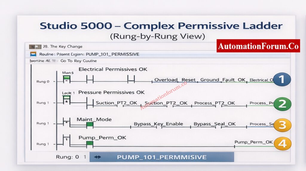

Step 3: Analyze the Permissive Ladder Logic Rung-by-Rung
A permissive ladder is usually set up with each rung being a logical series of conditions.
Permissive logic is normally divided into logical rungs, each representing a group of conditions. Analyze them sequentially.
Electrical Permissive Rung
This rung typically verifies:
- MCC health or contactor feedback
- Reset of the emergency stop circuit
- Reset the overload relay
- Ground fault fixed
If any signal is FALSE, check to see if the problem is real or if it is caused by wiring problems, broken auxiliary contacts, or PLC input module problems.
ControlLogix Security Flaw Engineers Must-Know: Critical Flaw in Rockwell ControlLogix CVE-2024-6242 – Trusted Slot Bypass Vulnerability
Process and Pressure Permissive Rung
This rung evaluates process safety conditions such as:
- Suction pressure within limits
- Discharge pressure below high limit
- Flow present
Many plants use 2-out-of-3 voting logic for critical pressures. Always evaluate the voting result, not just individual transmitter readings. A single failed transmitter may not block the start, but two failed transmitters will.
Always troubleshoot from left to right and top to bottom, exactly how the PLC scans logic. When a final output is false, trace each upstream rung to find the first rung where the logic evaluates to false.
Put the ladder into logic forcing mode and toggle the suspected inputs one by one (for example, force the suction pressure OK tag) and observe the effect on FIRST‑OUT. But remember: never force a tag without proper safety permissions and clear communication with operations.
Maintenance and Bypass Rung
This rung checks:
- Maintenance mode status
- Bypass key enable
- Temporary commissioning overrides
People often get confused when they forget or use an unauthorized shortcut. Before assuming a process error, always check the status of the bypass.

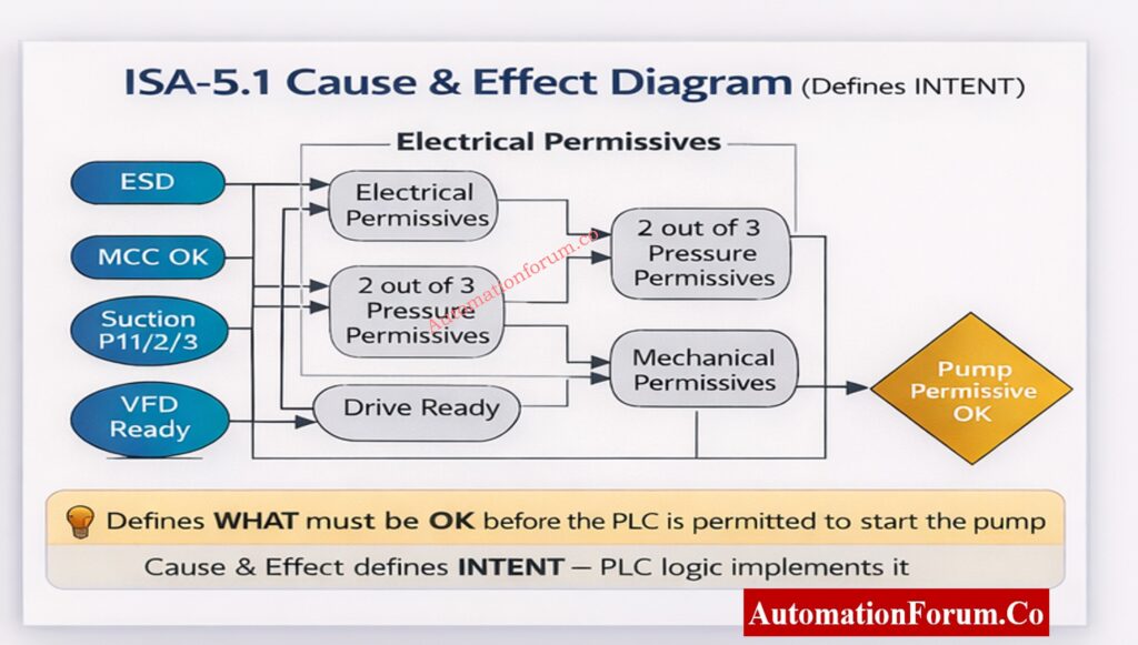

Step 4: Verify Design Intent Using Cause & Effect Diagram
The Cause & Effect (C&E) diagram, as per ISA-5.1, defines WHAT must be OK before the PLC is allowed to act. It does not describe code it describes intent.
Why Cause & Effect Important
- Serves as the contractual logic reference between process engineers and control engineers
- Links process safety to control logic and HMI behavior
- Ensures consistency across PLC, DCS, and emergency systems
Mapping C&E to PLC Logic
| Cause & Effect Element | PLC Implementation | Additional Checks |
| Electrical permissives | Ladder rung / AOI input | Verify I/O channel health |
| 2oo3 pressure logic | Voting logic block | Validate sensor calibration & drift |
| Mechanical permissives | AOI input | Check sensor mounting & mechanical condition |
| Pump permissive OK | Final output coil | Confirm interlock with motor starter |
Cause & Effect (C&E) diagrams define what conditions must be satisfied before a start is permitted. They represent the safety and operational intent of the system.
During troubleshooting:
- Confirm that every permissive in the ladder exists in the C&E diagram
- Check that the voting rationale satisfies the C&E definition.
- Find any undocumented permissions that were added during changes.
If there is a difference between C&E and PLC logic, it should be seen as a big design problem.
Always keep the C&E and ladder logic in sync. Use code comments or a mapping document that links each C&E bubble to a PLC tag and AOI parameter so field technicians can quickly find the implementation.

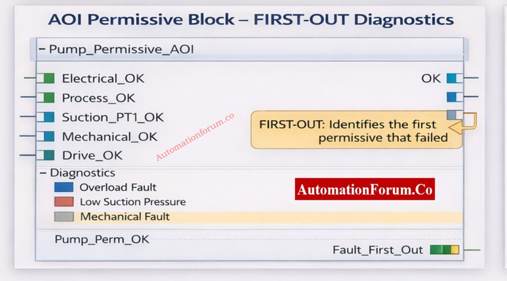

Step 5: Use AOI FIRST-OUT Diagnostics
What is an AOI?
An Add-On Instruction (AOI) is a reusable logic block that standardizes permissive logic across equipment. AOIs can contain inputs, outputs, and internal tags which makes them ideal for consistent FIRST‑OUT behavior.
FIRST-OUT Logic Explained
FIRST-OUT logic captures the first permissive that fails, even if multiple permissives fail later. The AOI sets a Fault_First_Out tag and often a code or priority bitset that the HMI can interpret.
Benefits:
- Faster troubleshooting by pointing to the root cause
- Easier operator guidance because HMI can show the likely cause
- Better trending and reliability metrics because the first fault is logged
Implementation notes
- Use timestamped fault registers in AOIs to capture when the first failure occurred.
- Include a ‘clear’ or ‘acknowledge’ mechanism that does not erase historical logs- use a separate event log for permanent records.
Modern PLC systems use Add-On Instructions (AOIs) to standardize permissive logic. A well-designed AOI includes FIRST-OUT diagnostics, which record the first permissive that failed.
- Read the FIRST-OUT diagnostic tag
- Identify the first permissive that transitioned to FALSE
- Focus troubleshooting on this permissive only
FIRST-OUT logic prevents engineers from chasing secondary or consequential faults.

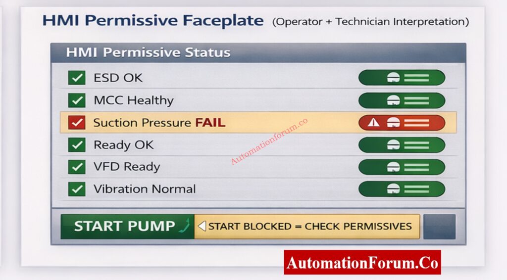

Step 8: Review HMI Permissive Faceplate
The HMI should clearly display:
- Individual permissive statuses
- FIRST-OUT condition
- Clear reason for start blockage
If the HMI only shows a generic alarm, the issue may be poor interface design rather than PLC logic.
The HMI is the bridge between PLC logic and human decision-making.
Best Practices for HMI Permissives
- Clear OK / FAIL indication with accessible color contrast for color-blind users
- Highlight FIRST-OUT condition with a distinctive icon and link to a diagnostic page
- Avoid ambiguous alarms – use plain language and recommended action
Example Interpretation
If Suction Pressure FAIL is highlighted:
- Operator sees start blocked and FIRST-OUT pointing to Suction Pressure
- Technician checks pressure trend and HART diagnostics
- Instrument engineer verifies transmitter health with a handheld calibrator and checks the impulse line for blockages
- Once fixed, AOI/PLC will clear FIRST-OUT and HMI updates to green
