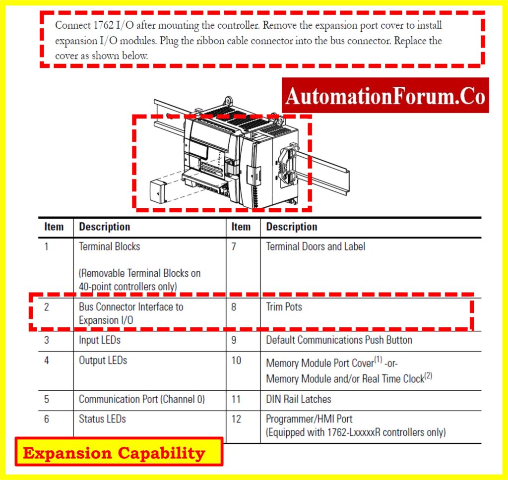

Step 8. Expansion Capability
Unlike certain small PLCs, the 1762-L24BWA permits expansion using specific I/O modules:
- Module Compatibility:Â Up to six 1762-series extension modules
- Types available include specialized modules (RTC, high-speed counter), digital and analog I/O.
Bus Current Draw (Backplane):
- Modules can receive up to 450 mA from the base unit.
Note: Keep in mind power use and mounting space even if you may increase your system by including more I/O.
