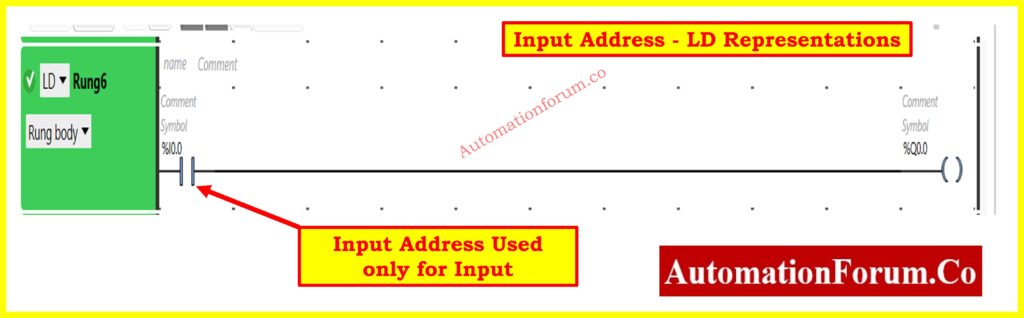

Rule 5. Input Address cannot be used as an Output Address
According to this rule, an input address (I0, I1, I2, etc.) must never be used as an output coil in the ladder logic program.
The above picture represents:
- Input I0 used as input in multiple rungs, which is correct.
- But not used as output, which would be incorrect.
You can reuse the input address in different input conditions, but never define it as an output coil.
