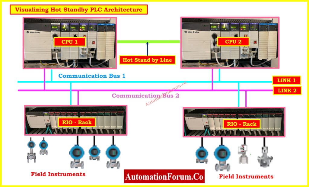

Visualizing Hot Standby Architecture
Explanation of the System Diagram
The picture above shows an Allen-Bradley PLC System in Hot Standby mode. It is a backup control system made for industrial automation that needs to be always available and able to handle faults.
CPU 1 & CPU 2 (Redundant Controllers)
These two Allen-Bradley CPUs are connected by a special Hot Standby Link (green line) that lets them sync data in real time.
- CPU 1 is the Primary PLC, actively executing control logic.
- CPU 2 is the Standby PLC, mirroring all operations and ready to take over if CPU 1 fails.
Hot Standby Link
- This special Ethernet link keeps I/O data, status information, and timestamped events between the CPUs in sync all the time.
Know SIS, PLC, and BPCS: Understanding Differences of SIS, PLC, and BPCS in Industrial Automation
Communication Bus 1 & 2 (Redundant Communication Lines)
- If one path fails, two different communication buses make sure that data keeps flowing to the Remote I/O (RIO) racks and field devices.
LINK 1 and LINK 2
- These add extra communication or network redundancy for applications that need to be very reliable.
RIO Racks (Remote I/O Modules)
- These racks are connected to both communication busses for backup and handle signals from field instruments (sensors and actuators).
- They make sure that communication in the field stays open when the CPU is switching.
Simplify Remote I/O in PLCs: Understanding Remote I/O in PLC Control Systems
Field Instruments
- RIO modules send real-time data from pressure, flow, temperature, and level transmitters to the control system.
This architecture enables complete system redundancy, ensuring seamless transition in case of a controller failure.
