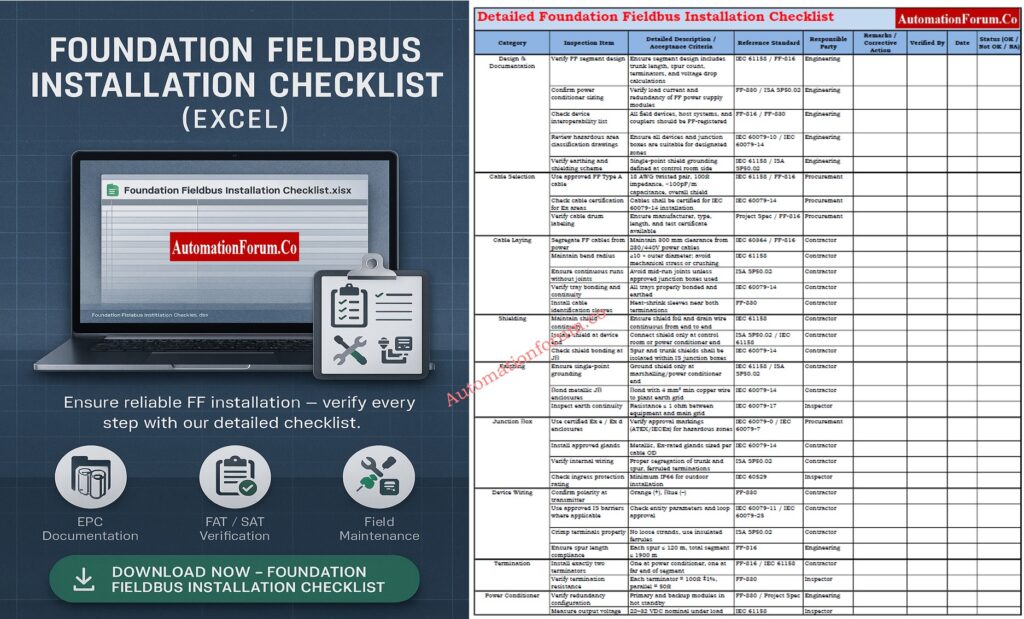

- Foundation Fieldbus Installation Checklist (Downloadable Excel)

Cable Selection Checklist for EPC Engineers
- Always use Type A Foundation Fieldbus (FF) wires for both trunk and spur wiring.
- To stop reflections, keep the impedance the same over the whole section.
- Before you install, make sure the drain wire is still connected and the shielding is still in good shape.
- Don’t use cables that are rated for high voltage (like 600V) in FF circuits because they create unneeded capacitance.

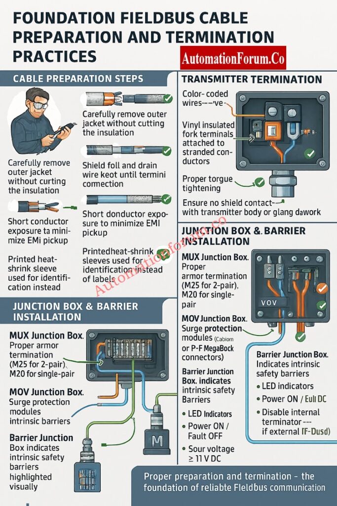

Foundation Fieldbus Cable Preparation and Termination
Preparing cables correctly makes sure that signals stay strong and EMI doesn’t get through.
Step-by-Step Cable Preparation Procedure
- Take off the outer jacket gently so that you don’t cut the inside insulation.
- Do not damage the inner insulation or mylar foil when you strip armored cable.
- Don’t cut the shield foil or drain wire until they are attached to the terminal blocks.
- To cut down on electromagnetic pickup, make the exposed conductor as short as possible.
- Use heat shrink tubing (25–40 mm) to cover cuts in the jacket and keep shields separate.
- For long-lasting identification, use printed heat-shrink sleeves instead of sticky labels.
Transmitter Termination and Polarity Verification
- Only take off the jacket length that is needed for gland insertion.
- Orange means positive, and blue is negative.
- Use fork terminals with vinyl insulation for stranded wires.
- Make sure that all terminal screws are tight.
- Make sure the shield doesn’t touch the transmitter body or the gland metalwork.
Discover the core definition and function of What is FOUNDATION Fieldbus ?
Junction Box and Barrier Installation Practices
MUX Junction Box Termination Procedure
- Used for barrier spur terminations or multiplexer transmitters.
- Use the right armor termination: M25 for 2-pair cables and M20 for single-pair cables.
- Check the accuracy of the trunk input polarity and label.
- Only keep the shield going up to the junction point.
MOV Junction Box for Surge-Protected Applications
- Used in areas that need surge protection or are dangerous.
- Do the same things to get ready as you would for barrier junction boxes.
- Make sure that the trunk and spur ends on Relcom or P+F MegaBlock connectors are right.
Barrier Junction Box (IS/Non-IS) Wiring Steps
- Houses FF boundaries that keep people safe by separating them from each other.
- Each barrier can hold up to four spurs.
- Check the polarity: Orange (+) and Blue (–).
- Check that the LED lights (Power ON, Fault OFF) are on and that the spur voltage is at least 11V DC.
- If you utilize an external TP-32 terminator, turn off the internal terminators.
Below is a thorough Foundation Fieldbus Installation Checklist (Excel) that may be used for EPC documentation, FAT/SAT verification, and field maintenance. To download, click the link below.
