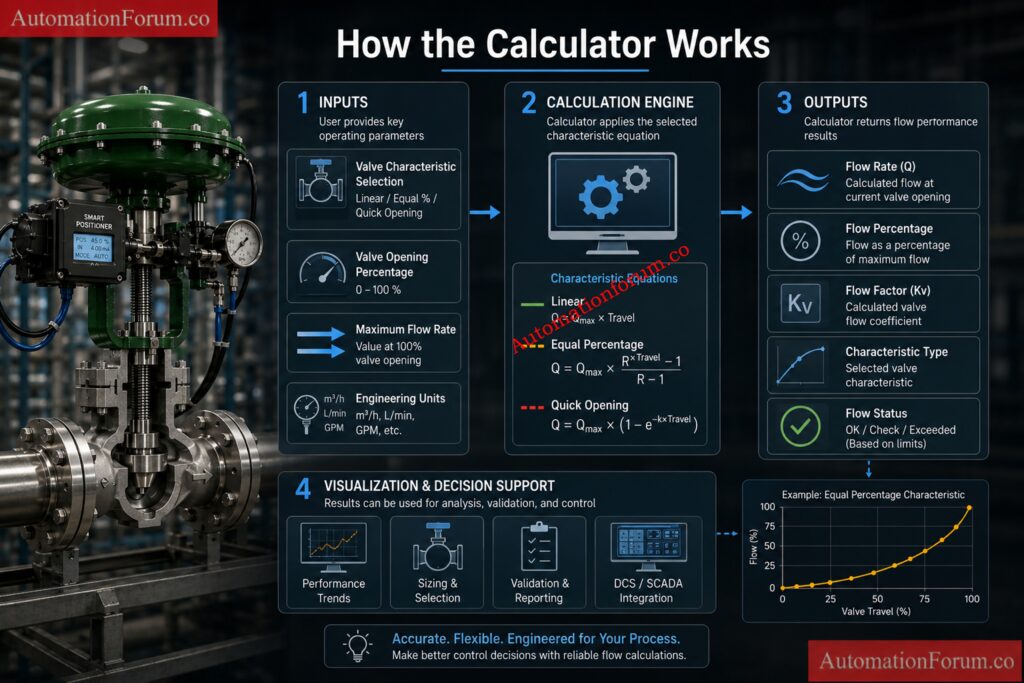

How the Control Valve Flow Characteristic Calculator Works
The calculator in the uploaded file lets the user choose a valve characteristic, enter the valve opening percentage, enter maximum flow rate, and choose engineering units such as m³/h, GPM, LPM, or Cv equivalent. It then calculates flow rate, flow percentage, factor, characteristic type, and status. The file also includes sample loading, reset, print support, application guidance, formulas, and standards references.
Control Valve Flow Characteristic Calculator Inputs Explained
| Input | Meaning |
| Valve Characteristic Selection | Chooses Linear, Equal Percentage, or Quick Opening |
| Valve Opening Percentage | Stem travel from 0 to 100 percent |
| Maximum Flow Rate | The full capacity value used for estimation |
| Engineering Units | The display unit for the calculated flow |
Control Valve Flow Characteristic Calculator Outputs
| Output | Meaning |
| Flow Rate | Estimated flow at the chosen opening |
| Flow Percentage | Flow as a percentage of maximum |
| Flow Factor | Fraction of maximum flow |
| Characteristic Type | The selected characteristic |
| Flow Status | A simple interpretation such as low, moderate, or maximum |
This makes the tool useful not only for quick control valve flow calculation, but also for training and preliminary engineering checks.

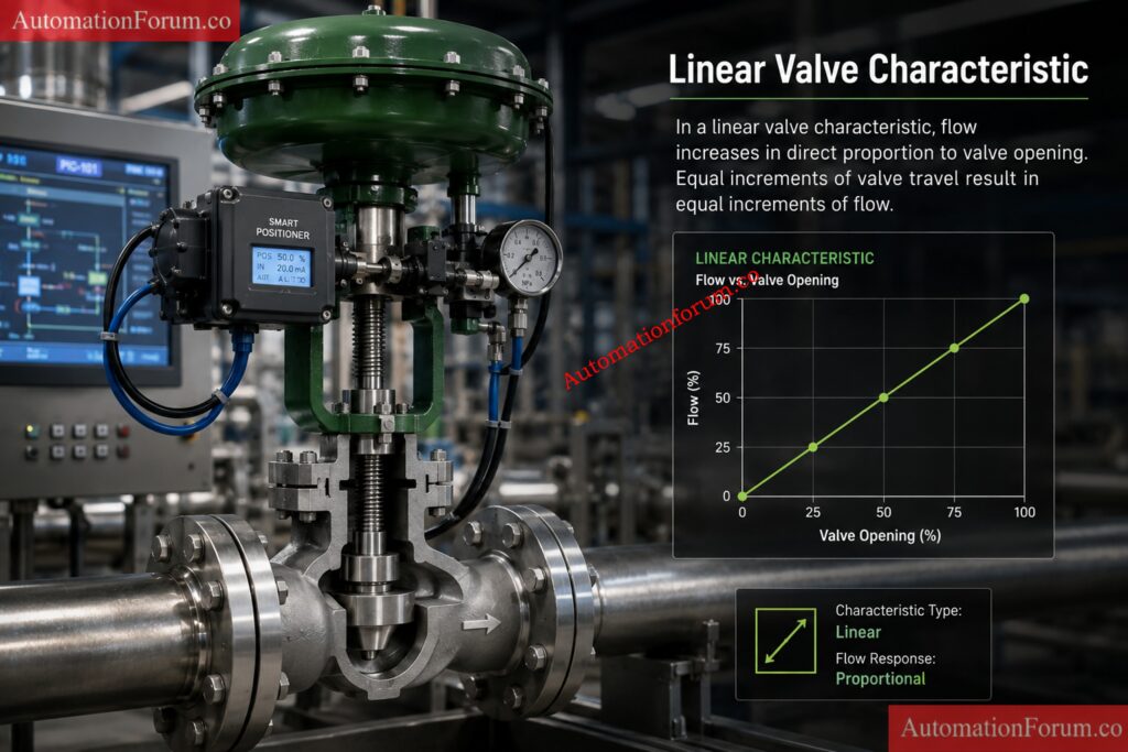

Understanding Linear Valve Characteristics
What Is a Linear Characteristic?
A linear valve characteristic means flow increases in direct proportion to valve opening. If the valve is 50 percent open , the flow will be about 50 percent of maximum , assuming a steady pressure decrease .
Linear Characteristic Formula
Q = Qmax × x
Where:
Q = actual flow
Qmax = maximum flow
x = valve opening fraction, for example 0.65 for 65 percent
Linear Flow Behavior
Linear valves have a uniform flow response over the whole trip range. Each percent of opening adds about the same amount of flow.
Advantages of Linear Control Valves
They are easy to understand, easy to calculate, and useful when process demand changes fairly uniformly.
Limitations of Linear Control Valves
They may not give the best controllability in systems where pressure drop varies widely.
Typical Industrial Applications of Linear Valves
Linear characteristics are often used in:
| Application | Why It Works |
| Flow control loops | Direct relationship between travel and flow |
| Level control systems | Stable proportional response |
| Water treatment plants | Predictable service behavior |
| Utility services | Simple operating behavior |
Practical Example
If a linear valve is rated for 250 m³/h and opened to 65 percent, the flow estimate is about 162.5 m³/h. That is easy to interpret, which is why many engineers use linear behavior as a teaching baseline.

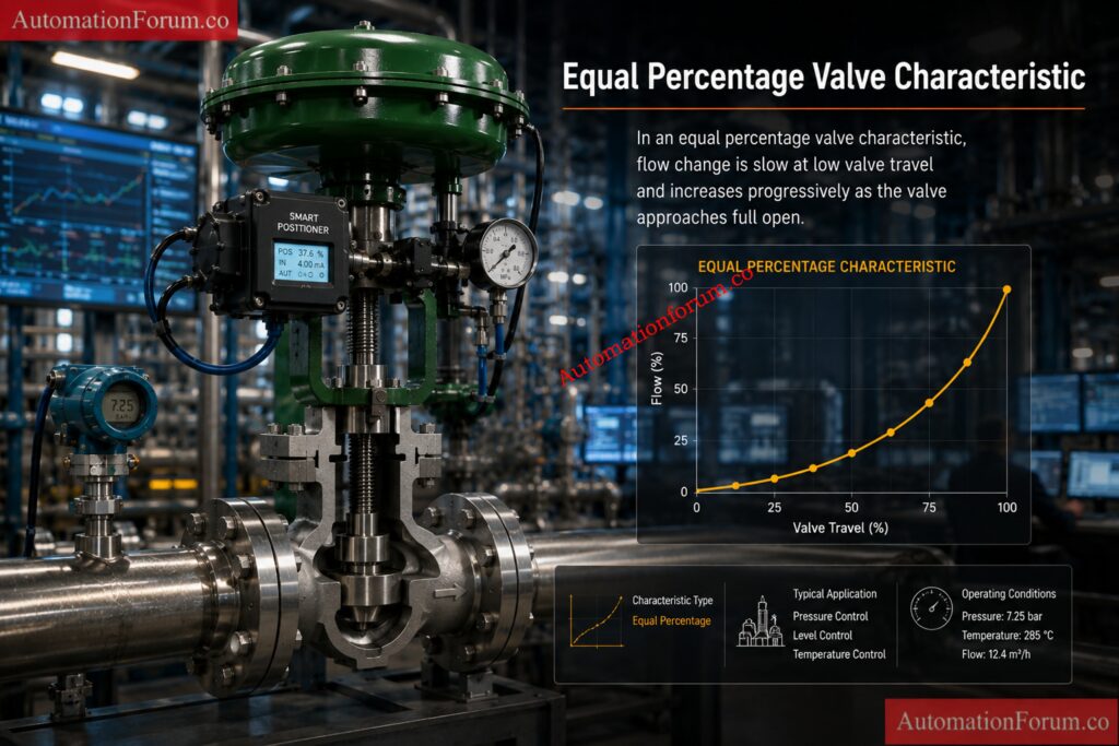

Understanding Equal Percentage Valve Characteristics
What Is an Equal Percentage Characteristic?
An equal percentage valve characteristic means each equal increment of stem travel produces an equal percentage increase in flow. The flow increase is small at low openings and much larger at higher openings.
Equal Percentage Characteristic Formula
A common simplified form used in calculators is:
Q = Qmax × ((e^(4x) - 1) / (e^4 - 1))
This is a practical approximation for learning and estimation.
How Equal Percentage Flow Changes With Valve Opening
At low openings, the valve is very gentle. At mid travel, the flow begins to rise more noticeably. At higher openings, the valve becomes much more responsive.
Why Equal Percentage Trims Are Widely Used
Equal percentage trim is often preferred because process conditions in real plants are not constant. Pressure drop changes, load changes, and supply variation are common. Equal percentage trims ensure practical control over a large working range.
Advantages of Equal Percentage Control Valves
They offer excellent rangeability, better low flow control, and strong real plant adaptability.
Limitations of Equal Percentage Control Valves
They are not always ideal for simple on off duty or for systems that need a direct one to one relationship between movement and flow.
Typical Industrial Applications of Equal Percentage Valves
| Temperature control | Smooth response across changing loads |
| Pressure control | Better handling of varying pressure drop |
| Steam control | Stable behavior under wide operating conditions |
| Heat exchangers | Useful with changing thermal demand |
| Process plants | Strong control over variable service |
Practical Example
A 65 percent open equal percentage valve may still deliver less flow than a linear valve at the same opening, but its real value appears when the system pressure drop changes. That is why equal percentage is often the preferred choice in temperature and pressure loops.

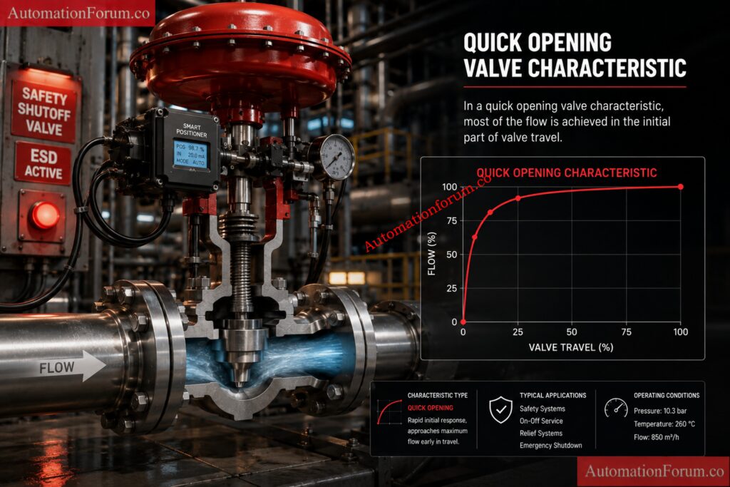

Understanding Quick Opening Valve Characteristics
What Is a Quick Opening Characteristic?
A quick opening valve characteristic gives a large flow increase at the first part of valve travel. After that, additional opening creates a smaller relative change in flow.
Quick Opening Characteristic Formula
Quick opening valves are aggressive near the closed position. They are designed to deliver high flow quickly.
Advantages of Quick Opening Valves
They provide fast response and are excellent for isolation or emergency use.
Limitations of Quick Opening Valves
They are usually too aggressive for fine control. Small travel changes can create large process changes.
Typical Industrial Applications of Quick Opening Valves
| Emergency shutdown systems | Rapid opening when needed |
| Safety functions | Fast delivery of flow |
| On off control | Clear open or closed service |
| Relief services | Immediate flow response |
Practical Example
A quick opening valve is not usually the first choice for tight process control. It is more suitable when the goal is to move a large amount of flow quickly rather than regulate it precisely.

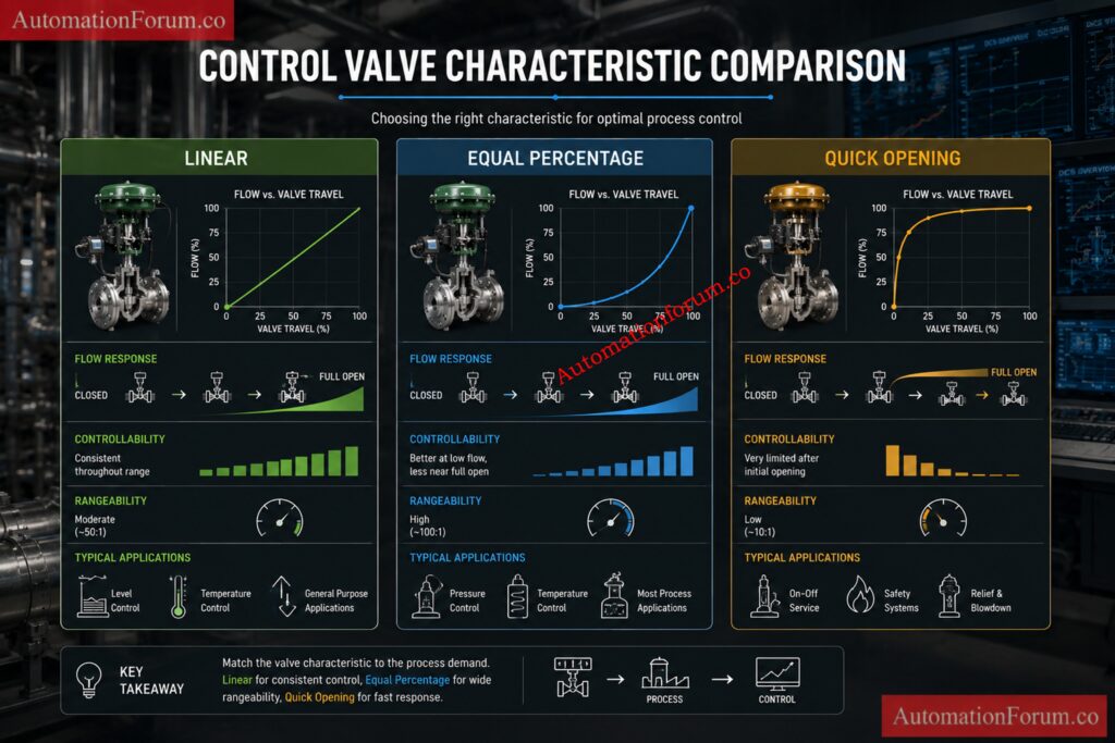

Control Valve Characteristic Comparison Table
| Characteristic | Flow Response | Controllability | Rangeability | Typical Applications | Advantages | Limitations | Recommended Services |
| Linear | Direct proportional response | Good in stable systems | Moderate | Flow loops, level loops, utilities | Easy to understand | Less flexible with changing pressure drop | Constant or nearly constant load |
| Equal Percentage | Small at low travel, large at high travel | Excellent in real plants | High | Temperature, pressure, steam, heat exchangers | Best all round process adaptability | Less intuitive | Variable pressure drop service |
| Quick Opening | Large early flow increase | Poor for fine control | Low | Shutdown, safety, on off service | Very fast response | Can be too aggressive | Non modulating duties |

The uploaded calculator includes a sample mode with:
Maximum Flow = 250 m³/h
Valve Opening = 65 percent
Characteristic = Equal Percentage.
Results
| Characteristic | Estimated Flow |
| Linear | 162.5 m³/h |
| Equal Percentage | Lower than linear at early travel, then rises strongly at higher travel |
| Quick Opening | Highest early travel response |
Engineering Significance
The comparison shows why valve characteristic selection matters. A linear valve gives a straightforward result. A quick opening valve responds very aggressively. An equal percentage valve gives more refined control in a real process where pressure drop and load are not constant.

Valve Characteristic and Service Fit
| Service | Best Characteristic | Reason |
| Flow control | Linear or equal percentage | Depends on pressure stability |
| Temperature control | Equal percentage | Handles load changes well |
| Pressure control | Equal percentage | Better across varying pressure drop |
| Level control | Linear | Straightforward response |
| On off service | Quick opening | Fast response |
| Steam service | Equal percentage | Strong controllability |
Flow Behavior at Different Openings
| Opening Percent | Linear | Equal Percentage | Quick Opening |
| 10 percent | Low and proportional | Very low | High relative early response |
| 50 percent | Mid range | Moderate | Strong response |
| 65 percent | 65 percent of max | Depends on formula and real trim | Higher than linear in early travel |
| 90 percent | Near maximum | Rapid increase | Near full capacity |

What is a Quick Opening Valve Characteristic?
A fast opening characteristic gives considerable increases in flow at small valve lifts.
It is often utilized for on-off service and emergency applications.
What is a Linear Valve Characteristic?
A linear characteristic means that the flow changes directly according to the valve movement.
The flow increases by roughly the same amount with each additional trip.
What is an Equal Percentage Valve Characteristic?
An equal percentage characteristic gives equal percentage increases in flow for equal increments of trip.
That gives a good controllability over a big operation range.
