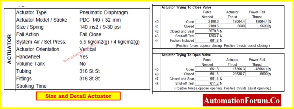

Step 7: Size and Detail Actuator
1. Choose Actuator Type: Select a type of actuator. Reliability, response time, and power availability will guide your choice from pneumatic diaphragm, piston, electro-hydraulic, or electric actuator.
2. Calculate Required Thrust/Torque: Calculate necessary thrust or torque by use of vendor data or computation tools; next, compare with actuator capabilities.
3. Define Fail-Safe Action: Choose fail-safe action fail open, fail close, or fail-in-place dependent on safety integrity level (SIL) and control narrative.
4. Specify Stroke & Timing: Indicate stroke length and define open-close cycle duration (e.g., three seconds for an emergency shutdown).
Note: A reliable actuation solution that ensures safe, responsive valve control under all process conditions.
