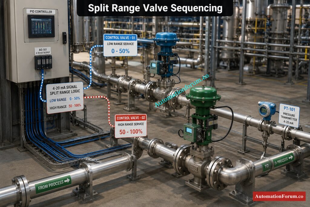

What Is Split Range Control in Industrial Automation
Split range control is a control strategy where one controller output is divided into multiple output regions to operate different valves or actuators.
Instead of sending the full output signal to one valve, the controller distributes the output across multiple valves according to predefined operating bands.
For example:
- Valve 1 may operate from 0 to 50 percent controller output
- Valve 2 may operate from 50 to 100 percent controller output

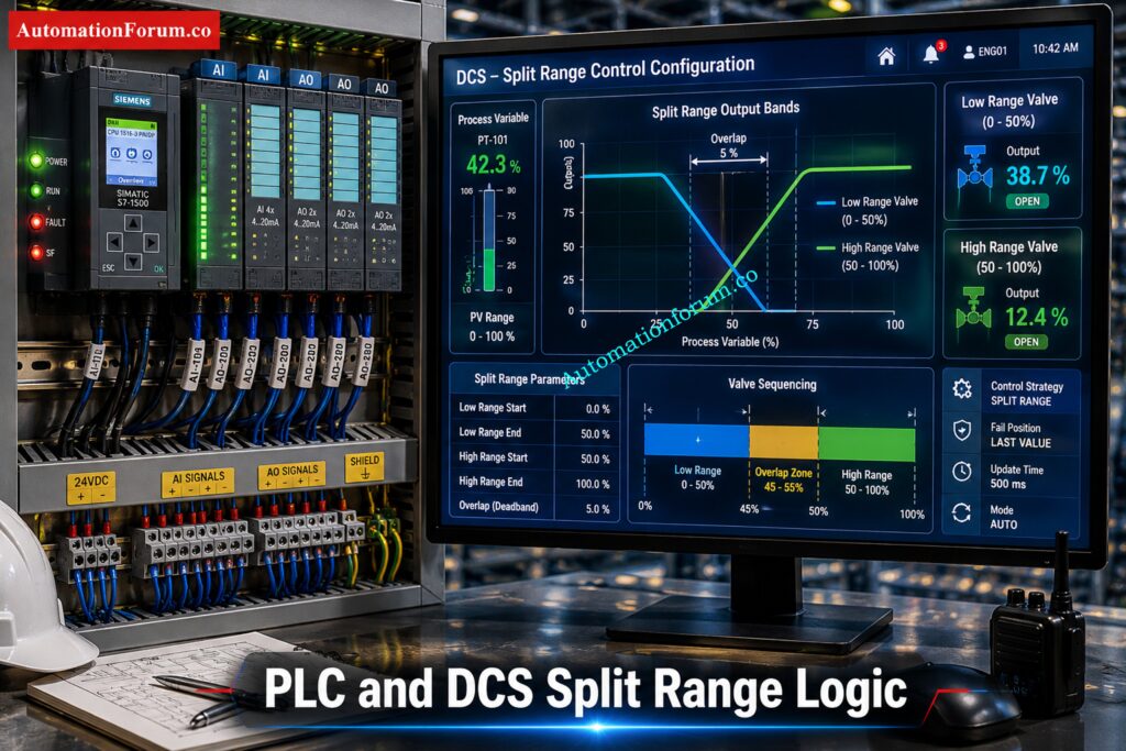

Importance of Split Range Control in PLC and DCS Systems
In some applications:
- The ranges overlap
- A dead zone or gap is intentionally created
This type of logic is very common in PLC and DCS based automation systems.

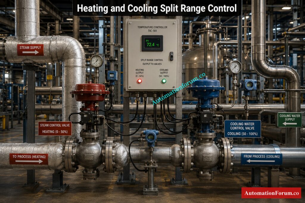

Split range control is used because many industrial processes cannot be controlled efficiently using only one valve.
Different valves may be required for:
- Low load operation
- High load operation
- Heating and cooling
- Fine and coarse control
- Makeup and venting
- Utility balancing
- Energy optimization

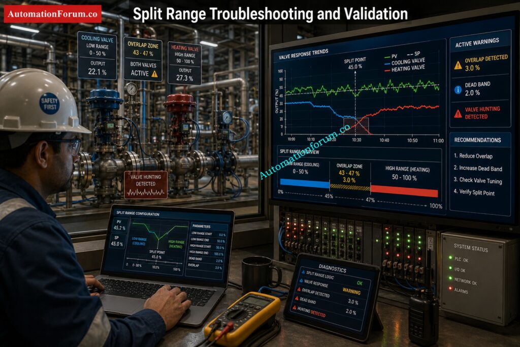

During Troubleshooting of Control Loops
Used when:
- Process instability occurs
- Valve sequencing becomes abnormal
- PID loops become unstable
- Valve overlap creates issues
- Dead zones appear

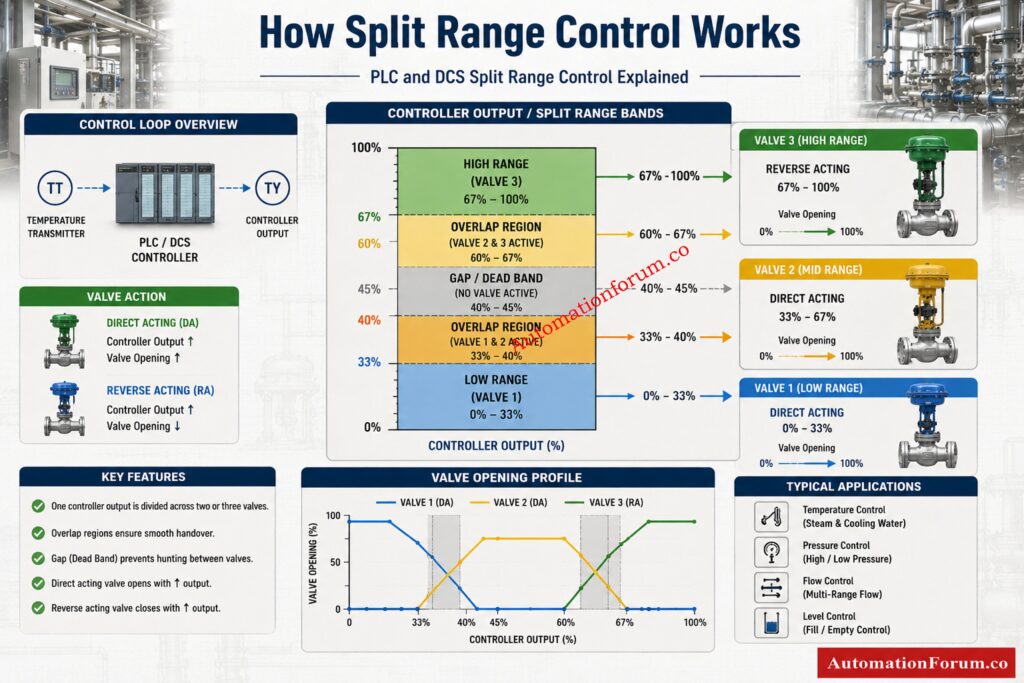

Working Principle of Split Range Control
Basic Philosophy of Split Range Valve Sequencing
The principle of operation is simple.
The controller output is separated in independent operating bands.
Each valve responds only within its assigned output range.
Understanding Controller Output Allocation
Example:
| Controller Output | Valve Action |
| 0 to 50 percent | Valve 1 active |
| 50 to 100 percent | Valve 2 active |
Understanding Valve Operating Regions
In overlap configurations:
| 45 to 55 percent | Both valves active |
In gap configurations:
| 48 to 52 percent | No valve active |
Must-Have Valve Hardware for Stable Process Performance: Essential Control Valve Accessories for Reliable Process Control
Understanding Direct Acting and Reverse Acting Valves
What Is a Direct Acting Valve
A direct acting valve opens as the controller output increases.
Example:
- 0 percent output = fully closed
- 100 percent output = fully open
What Is a Reverse Acting Valve
A reverse acting valve behaves in the opposite direction.
Example:
- 0 percent output = fully open
- 100 percent output = fully closed
The calculator supports both logic types, making it suitable for real industrial applications.
Tools Every Process Engineer Uses to Save Time: Essential Engineering Calculators for Process and Instrumentation Engineers
Understanding Overlap and Gap in Split Range Control
What Is Valve Overlap
Example:
- Valve 1 operates from 0 to 55 percent
- Valve 2 operates from 45 to 100 percent
Result:
- 45 to 55 percent becomes overlap region
Why Overlap Is Important in Valve Sequencing
Overlap helps:
- Improve handover smoothness
- Reduce process disturbance
- Avoid sudden control jumps
- Improve PID stability
What Is Dead Band or Gap Region
Gap means there is a region where no valve is active.
Example:
- Valve 1 stops at 45 percent
- Valve 2 starts at 55 percent
Result:
- 45 to 55 percent becomes dead zone
Problems Caused by Excessive Dead Band
Intentional dead band may be used to:
- Prevent both valves from operating together
- Reduce unnecessary valve movement
- Avoid interaction between utilities
However, excessive dead band can create instability.

Two Valve Split Range Mode
Useful for:
- Heating and cooling systems
- Low and high capacity control
- Basic utility control

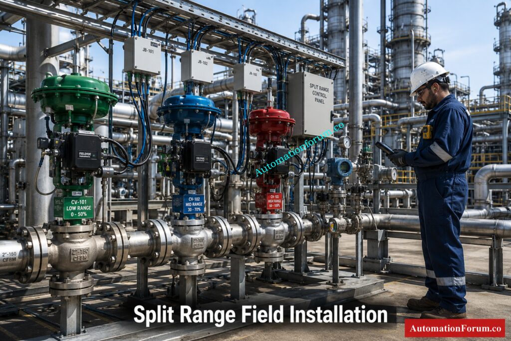

Three Valve Split Range Mode
Useful for:
- Advanced sequencing
- Multi stage utility systems
- Complex process control

Steam and Cooling Water Temperature Control
One valve controls steam for heating.
Another valve controls cooling water.
The controller decides which utility should operate based on temperature demand.

Fine and Coarse Flow Control Applications
A small valve handles precision control.
A larger valve handles bulk capacity.

Engineering Formula Explanation
Direct Acting Valve Opening Formula
Valve Opening = ((CO minus Start) divided by (Stop minus Start)) multiplied by 100
This formula determines how much the valve opens based on controller output.
Reverse Acting Valve Opening Formula
Reverse Valve Opening = ((Stop minus CO) divided by (Stop minus Start)) multiplied by 100
Used when valve response is reversed.
Overlap Calculation Formula
Overlap = Previous Stop minus Next Start
Positive value means overlap exists.
Gap Calculation Formula
Gap = Next Start minus Previous Stop
Positive value means dead zone exists.

Real Engineering Challenges in Split Range Control
- Sticky Valves: Sticky valves lead to bad handover and unstable control.
- Valve Hunting: Happens when the overlap or tune is wrong.
- Bad Valve Handover : Split point drifting may induce sudden process disruptions.
- Unstable process response may be caused by excess dead band.
- Wrong Reverse Acting Configuration: Wrong action configuration causes wrong process behavior.
- Bad PID Tuning: Even solid split range logic might fail if tuning is bad.

How Does Split Range Work in PLC Systems?
Split range logic in PLC systems separates the controller output into different operating ranges for several valves/actuators. The PLC performs scaling and sequencing logic to open the appropriate valve within its programmed range.
How Does Split Range Work in DCS Systems?
DCS systems utilize split range control blocks or output characterization functions to divide one controller output to numerous control valves. This enables seamless sequencing and automatic valve handover.
