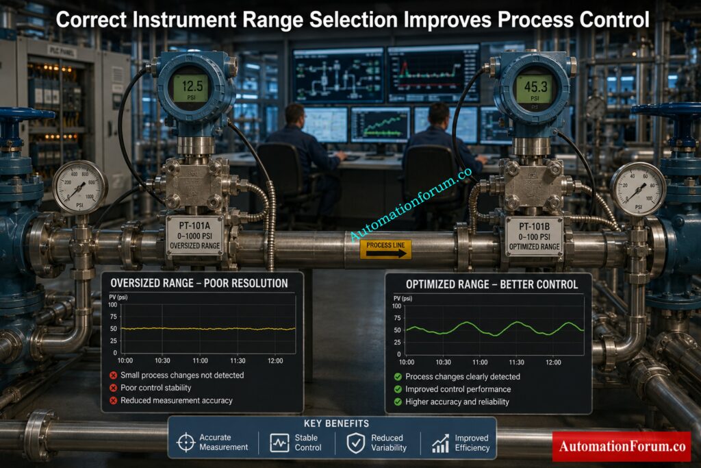

Why Correct Instrument Range Selection Is Important
Effect on Measurement Accuracy
- Proper range selection is not simply a calibration activity. It directly influences measurement quality throughout the life of the plant.
- Suppose a refinery discharge pressure normally operates between 150 psi and 200 psi.
- Using a transmitter calibrated from 0 psi to 400 psi means the process occupies only a small portion of the available measuring range. The measurement is less sensitive, i.e. small changes in pressure are less visible.
- If the same transmitter is calibrated from 140 psi to 220 pressure , the possible resolution is focused in the actual operational range . Operators get better meaningful trends. Controllers respond faster and the process is more stable.
Common Range Selection Mistakes
- Proper range selection also avoids needless transmitter saturation, lowers false alarms, and enhances overall control accuracy.
- Many commissioning problems originate from incorrect calibration values rather than defective instruments.

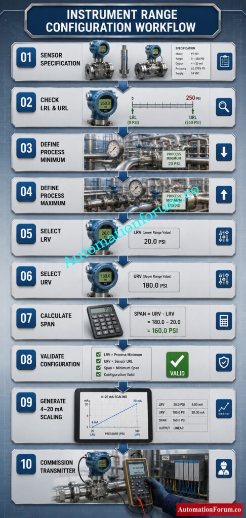

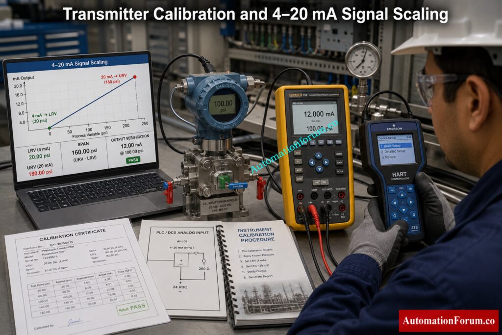

Understanding Transmitter Calibration Range
Calibration configures how the transmitter converts process values into an electrical output signal.
The calculator allows engineers to define the calibrated operating range by entering the Lower Range Value and Upper Range Value along with the minimum and maximum output signal. These parameters determine how the transmitter behaves during normal operation.
Lower Range Value (LRV)
The Lower Range Value represents the process value corresponding to the minimum output signal.
For a standard analog transmitter
4 mA = LRV
If the LRV is set to 20 psi, the transmitter outputs exactly 4 mA when the process pressure reaches 20 psi.
Eliminate Pressure Measurement Errors Using Proven Smart Transmitter Techniques: Smart Pressure Transmitter Sensor Trim Guide with Diagrams & Calibration Steps
Upper Range Value (URV)
The Upper Range Value represents the process value corresponding to the maximum output signal.
20 mA = URV
If the URV is configured as 180 psi, the transmitter produces 20 mA at that pressure.
Output Signal Scaling
The calculator supports configurable output limits, allowing engineers to work with standard industrial analog signals such as 4 to 20 mA or voltage based outputs where required. This flexibility makes the calculator suitable for pressure, flow, level, temperature, and other process measurements.

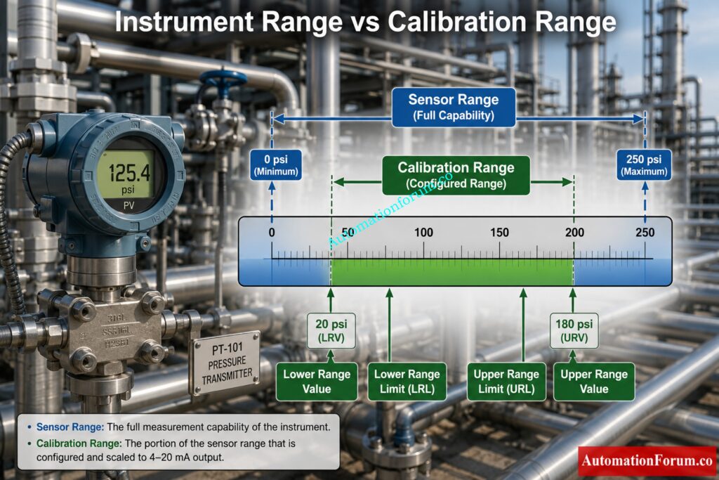

Instrument Range vs Calibration Range
Meet Compliance Requirements With This Essential Engineering Reference: ISO Standards For Instrumentation Calibration Complete Guide for Industrial Engineers
Key Differences
Understanding the difference between sensor range and calibrated range is essential for selecting and configuring transmitters correctly. These two terms are often used interchangeably, but they describe different characteristics of an instrument.
The sensor range defines the physical measuring capability of the sensing element. It is established by the manufacturer and remains unchanged throughout the life of the transmitter. The calibrated range, on the other hand, is selected by the engineer to match the actual operating conditions of the process.
Comparison Table
| Parameter | Sensor Range | Calibrated Range |
| Defined by | Manufacturer | Instrument Engineer |
| Can be changed | No | Yes |
| Purpose | Physical measuring capability | Process measurement |
| Based on | Sensor design | Process requirement |
| Example | 0 to 250 psi | 20 to 180 psi |
Unlock The Split Logic Engineers Use For Smooth Control: Understanding Complementary Split Range Control (CSRC)
Practical Engineering Example
For example, a pressure transmitter may have a sensor capable of measuring from 0 psi to 250 psi. If the actual process normally operates between 20 psi and 180 psi, configuring the transmitter within this operating window provides better measurement quality than using the entire sensor range.

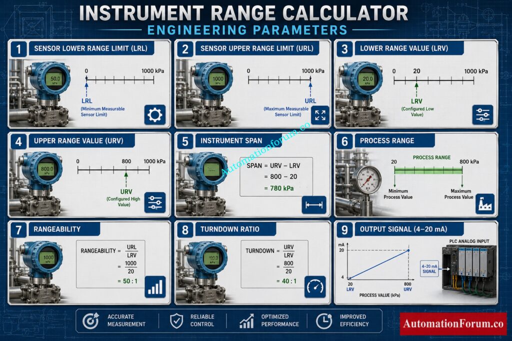

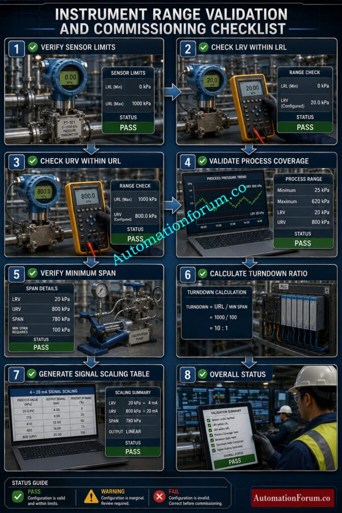

What Does This Instrument Range Calculator Calculate?
The Instrument Range Calculator brings together a number of engineering calculations into one tool which makes it simpler to configure transmitters correctly during the design, calibration, commissioning and maintenance stages.
Engineers can validate all key parameters before putting the transmitter into service without doing separate calculations using spreadsheets or hand-held calculators.
The calculator performs tasks such as
- Calculates calibrated span
- Calculates sensor range
- Calculates process range
- Determines rangeability
- Calculates transmitter turndown ratio
- Calculates ADC resolution
- Calculates hysteresis error
- Calculates accuracy error
- Verifies calibration limits
- Checks minimum allowable span
- Validates process coverage
- Generates signal scaling values
- Displays engineering visualization
- Performs calibration checks
- Displays PASS, WARNING, or FAIL status based on the entered values.

Instrument Range Calculator Input Parameters Explained
The calculator includes several input fields that represent the transmitter, sensor, and process requirements. Each field has a specific engineering purpose.
Sensor Lower Range Limit
This is the minimum value the sensor can physically measure.
Example
0 psi
The calculator checks whether the configured LRV falls within this limit.
Sensor Upper Range Limit
This is the maximum measurable value of the sensing element.
Example
250 psi
The configured URV must always remain below this value.
Process Minimum
This is the lowest process value expected during normal plant operation.
For example, if a storage tank level never falls below 2 metres, then the process minimum should be entered as 2 metres.
The calculator verifies whether this value lies inside the configured calibration span.
Process Maximum
This represents the highest operating process value.
Using realistic operating limits instead of equipment design limits helps improve measurement resolution and controller performance.
Lower Range Value
The Lower Range Value corresponds to the minimum transmitter output.
4 mA equals LRV
This value should normally be equal to or slightly lower than the expected minimum process value to provide adequate operating margin.
Upper Range Value
The Upper Range Value corresponds to the maximum transmitter output.
20 mA equals URV
Selecting a realistic URV prevents unnecessary loss of measurement resolution.

Calibrated Span
The calibrated span is the difference between the configured Upper Range Value and Lower Range Value.
Formula
Calibrated Span = URV − LRV
This value determines the operating range over which the transmitter converts the process variable into its output signal.
A span that closely matches the normal operating process generally provides better measurement resolution and improved control performance.
Sensor Range
The calculator also displays the total sensor range.
Formula
Sensor Range = URL − LRL
This value indicates the complete measuring capability of the sensor and serves as the reference for several validation checks performed by the calculator.
Process Range
Process range represents the expected operating window of the actual process.
Formula
Process Range = Process Maximum − Process Minimum
Comparing the process range with the calibrated span helps engineers determine whether sufficient operating margin has been provided.
Output Span
Output span represents the difference between the configured minimum and maximum output signals.
For a standard transmitter
Output Span = 20 mA − 4 mA
Output Span = 16 mA
Although most industrial transmitters use a 4 to 20 mA signal, the calculator also supports other analog output ranges.
Signal Per Unit
Signal per Unit indicates how much output signal changes for every engineering unit.
Formula
Signal per Unit = Output Span ÷ Calibrated Span
For example
Output Span = 16 mA
Calibrated Span = 160 psi
Signal per Unit
16 ÷ 160 = 0.1 mA per psi
This value is particularly useful during loop testing and manual calibration.
Rangeability
Rangeability describes the capability of a sensor to support different calibration ranges while maintaining acceptable performance.
Higher rangeability provides greater flexibility when configuring transmitters for different applications.
The calculator determines whether the selected calibration makes efficient use of the available sensor capability.
Turndown Ratio
Turndown ratio indicates how much the sensor range has been compressed into the configured calibration span.
Formula
Turndown Ratio = Sensor Range ÷ Calibrated Span
Example
Sensor Range
250 psi
Calibrated Span
125 psi
Turndown Ratio
250 ÷ 125 = 2 to 1
Lower turndown values generally provide better measurement performance.
Excessive turndown can reduce effective measurement accuracy and should be avoided whenever possible.
ADC Step Size
The calculator estimates the smallest measurable change based on the selected ADC resolution.
Higher resolution transmitters divide the calibrated span into a greater number of digital steps.
For example, a 16 bit transmitter provides significantly finer measurement resolution than an 8 bit transmitter.
This information helps engineers evaluate whether the selected transmitter is suitable for applications requiring precise measurement.

Calibration Validation
The calculator performs several automatic validation checks before displaying the final results.
These include
- LRV is within the sensor limits
- URV is within the sensor limits
- Process minimum lies inside the calibrated span
- Process maximum lies inside the calibrated span
- Zero adjustment is within allowable limits
- Configured span satisfies the minimum span requirement
These checks help identify configuration errors before the transmitter is commissioned.
PASS WARNING and FAIL Status
One of the most useful features of the calculator is the overall status indicator.
PASS
Displayed when every validation check is satisfied and the transmitter configuration is technically acceptable.
WARNING
Displayed when the transmitter configuration is usable but one or more parameters should be reviewed, such as excessive turndown.
FAIL
Displayed when important engineering limits have been exceeded, such as configuring the LRV or URV outside the sensor limits or selecting a span below the manufacturer’s minimum requirement.
This immediate feedback helps engineers correct configuration errors before installation.

Instrument Range Calculation Example
Pressure Transmitter Example
A pressure transmitter has the following specifications.
0 psi
250 psi
Process Minimum
20 psi
Process Maximum
180 psi
Configured Lower Range Value
20 psi
Configured Upper Range Value
180 psi
Output Signal
4 to 20 mA
Engineering Results
The calculator produces the following results.
- Sensor Range = 250 psi
- Process Range = 160 psi
- Calibrated Span = 160 psi
- Output Span = 16 mA
- Signal per Unit = 0.1 mA per psi
- Turndown Ratio = 1.56 to 1
- Calibration Status = PASS
These results demonstrate the proper configuration of the transmitter and that the calibration choice fully covers the intended operating procedure with outstanding measurement performance.

Instrument Range Visualization Explained
The calculator features a graphical range representation that offers a rapid understanding of the link between the sensor capabilities, the process operating range and the calibrated transmitter span. Engineers can see if the transmitter is setup appropriately instantly rather than having to look at a number of numerical figures.
The visualization contains four crucial elements:
Sensor Limits
The complete sensor range extends from the Lower Range Limit to the Upper Range Limit. This represents the maximum measuring capability of the transmitter.
Process Operating Range
The expected operating process is highlighted within the sensor limits. Ideally, the entire process range should remain inside the calibrated span while allowing a reasonable operating margin.
Configured Calibration Span
The configured Lower Range Value and Upper Range Value are shown separately from the sensor limits. This allows engineers to verify whether the transmitter has been calibrated correctly for the intended application.
Output Scaling Visualization
The displayed span also represents the section that is converted into the analog output signal. Every value between the configured LRV and URV corresponds proportionally to the selected output range.
During commissioning, this graphical representation helps engineers detect incorrect calibration settings much faster than reviewing numerical values alone.

Signal Scaling Table Explained
The calculator automatically generates a signal scaling table after every calculation. This table is extremely useful during transmitter calibration, loop checking, PLC commissioning, and DCS verification.
The table contains
- Process value
- Percentage of calibrated span
- Expected output current
- Output percentage
- Status indication
For example, consider a transmitter calibrated from 20 psi to 180 psi.
| Process Value | Output Current |
| 20 psi | 4.00 mA |
| 60 psi | 8.00 mA |
| 100 psi | 12.00 mA |
| 140 psi | 16.00 mA |
| 180 psi | 20.00 mA |
Maintenance engineers often use this information when injecting simulated process values during calibration. PLC and DCS engineers also use these values to verify analog input scaling and confirm that displayed process values match the actual transmitter output.

Instrument Range Selection Best Practices
Choosing the correct transmitter range is much easier when a few practical engineering guidelines are followed.
- Select a sensor that comfortably covers the highest expected process value.
- Configure the calibration span around the normal operating range instead of the maximum equipment rating.
- Leave sufficient margin above the expected maximum process value for abnormal operating conditions.
- Verify that the configured span satisfies the manufacturer’s minimum span requirement.
- Confirm that both the process minimum and process maximum remain inside the calibrated span.
- Validate the expected output signal during commissioning before placing the loop into service.
- Review the calculated turndown ratio whenever a very narrow span is selected.
Following these practices improves measurement accuracy, simplifies future maintenance, and reduces commissioning time.
