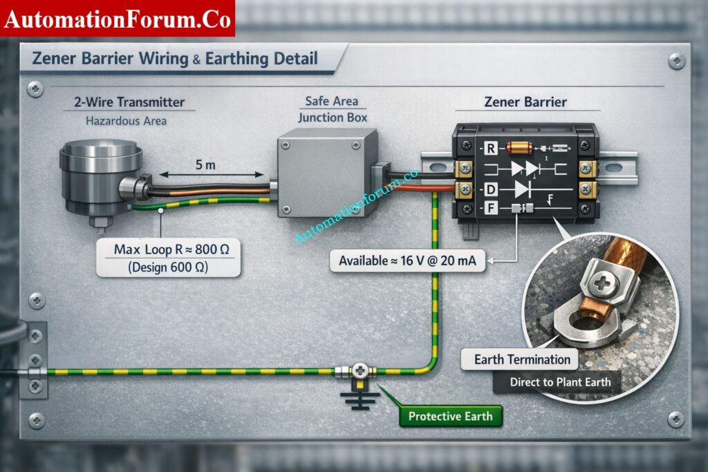

What is a Zener Barrier in Intrinsic Safety Systems
A Zener barrier is an energy limiting device installed in the safe area to prevent energy levels that could ignite a flammable atmosphere from reaching field devices in the hazardous area. The barrier limits both voltage and current using a combination of passive components and a sacrificial fuse.
Read Your Diagnostics Better: HART Transmitter Diagnostics: What Your Field Device is Telling You
How a Zener Barrier Works in 4 to 20 mA IS Loops
A standard Zener barrier consists of:
- a series resistor sized to limit current under fault conditions,
- one or more Zener diodes that clamp voltage to a defined maximum,
- a fuse that opens the feed if a sustained overcurrent occurs,
- a dedicated protective earth connection used to divert clamped energy to ground.
Under normal operation the series resistor and diode network allow the loop to operate and the transmitter to receive sufficient voltage and current. Under a fault such as a short or a power supply failure, the Zener diode clamps voltage and the resistor limits the current to safe levels. If the current remains high long enough, the fuse clears and isolates the circuit.
Zener Barrier Components Resistor Zener Diode Fuse and Earth
There are two practical barrier categories encountered in the field. The first is the low cost passive Zener barrier commonly used on single loop installations. The second is an active barrier where additional electronics reduce voltage drop and provide better defined available voltage to the field device while retaining the Zener clamp and fuse protection. Selection depends on required loop headroom, whether diagnostics and HART communication are required, and the plant earthing policy.
Zener Barrier Grounding Requirements and IS Loop Earthing Rules
The protective earth connection is mandatory for the barrier to perform correctly. If the earth connection is missing, loose, or takes a long path back to plant earth, the barrier may not divert dangerous energy properly. For that reason plant design must specify earth conductor sizing and routing and inspection during commissioning.

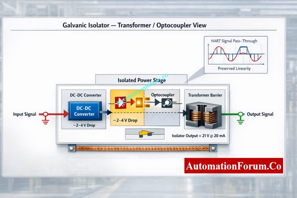

What is a Galvanic Isolator in Intrinsic Safety Applications
A galvanic isolator provides full electrical separation between the safe area circuit and the hazardous area circuit. Isolation is achieved by means of an isolating transformer, optocoupler or active electronic isolation stage. Isolators are available as loop powered two wire devices and as three port devices that separate input, output and supply.
Refer the below link for the What is SIS, SIF and SIL? An In-Depth Guide to Functional Safety in Process Industries
How Galvanic Isolation Works Using Transformer Optocoupler and Electronics
Common implementations are:
- transformer based isolator where magnetic coupling transfers the signal while blocking dc continuity,
- optocoupler based isolator where light transmits the signal across an insulating barrier,
- active electronic isolator where dedicated circuitry and dc to dc conversion provide isolation and regulated outputs.
Types of Galvanic Isolators Loop Powered and Three Port Isolators
A three port isolator separates the hazardous area loop, the safe area loop and the supply. That architecture allows a safe area earth free installation of the hazardous area side and removes the need to create a dedicated protective earth for safety reasons.
Why 4-20 mA Still Wins: Why Engineers Still Trust the 4-20 mA Signal in Automation Systems
Benefits of Galvanic Isolators for Industrial Instrumentation Systems
Galvanic isolation offers these practical benefits:
- does not require a safety earth on the hazardous area side to perform the energy separation function,
- provides higher available loop volts so long cable runs or higher loop resistance are supported,
- reduces the risk of ground potential differences causing noise or damaging signals,
- often includes built in repeat, conversion or HART passthrough capability which aids diagnostics and integration.
Limitations and Design Considerations of Galvanic Isolators
Isolators are active devices and can be more expensive per channel than a simple Zener barrier. They may require local power or specified loop powering arrangements. For safety certification they must be certified for the intrinsic safety concept in use and installed per manufacturer instructions.

Proper Earthing and Grounding Practices for Zener Barriers
- Connect a separate protected earth conductor from the Zener barrier earth terminal to the plant’s protective earth system. Copper should be used for the earth conductor, and it should be the right size and installed according to plant electrical regulations.
- Make the road to the ground as short and direct as you can. Don’t run the earth wire through panels, structures, or conduits that can create extra impedance and make it less effective.
- Check the earth continuity and make sure the resistance matches the plant’s needs, which is usually less than 1 ohm, during installation and commissioning. Write down the numbers for earth impedance and put them in the commissioning paperwork so you can look them up later.
- To avoid differences and dangerous situations, make sure that all barriers have the same reference ground point.

Zener Barrier Loop Loading Calculation with Example
- Assume a 24 volt supply and a two wire transmitter operating at 20 mA.
- Available voltage from the Zener barrier is approximately 16.0 volts at full load.
- Maximum loop resistance Rmax = 16.0 divided by 0.02 = 800 ohms, but use a practical design limit of 600 ohms to allow margin.
Galvanic Isolator Loop Loading Calculation with Example
- With a typical isolator voltage drop of 3 volts, about 21 volts is available to the transmitter.
- Maximum loop resistance Rmax = 21 divided by 0.02 = 1050 ohms.
- Use a conservative design limit of around 900 ohms for reliable operation and HART communication.

Case Study Zener Barrier for Short Distance Flame Detector Loop
A flame detector in a dusty zone is located five meters from the junction box. The instrument is two wire and requires basic HART diagnostics only occasionally. Plant earth at the control room is robust and short earth conductors can be run to the barrier location. A passive Zener barrier is selected due to low capital cost and ease of local maintenance. The installation includes labeled spare fuses in the local instrument cabinet and a simple commissioning test sheet that includes earth continuity fuse checks and loop resistance measurement. The design limits loop resistance to 500 ohms to preserve HART margin.

What is the difference between galvanic isolation and optical isolation?
Galvanic isolation blocks electrical continuity using transformers or capacitive methods.
Optical isolation is a type of galvanic isolation that uses light via optocouplers.

Do galvanic isolators support HART communication?
Most modern isolators allow HART signal passthrough without distortion.
Always confirm HART compatibility in the manufacturer datasheet.
