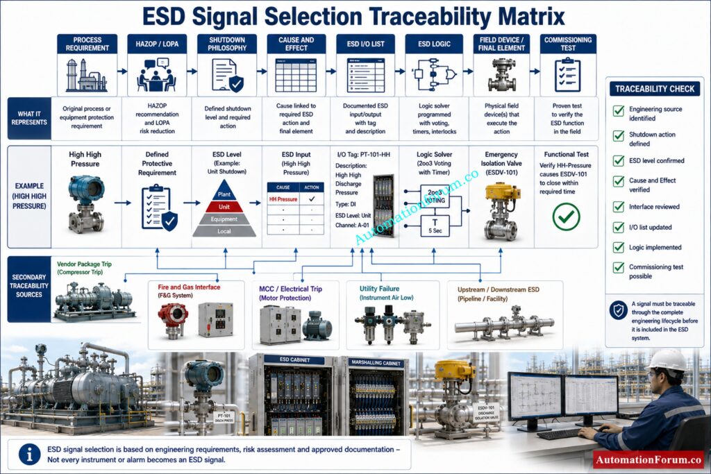

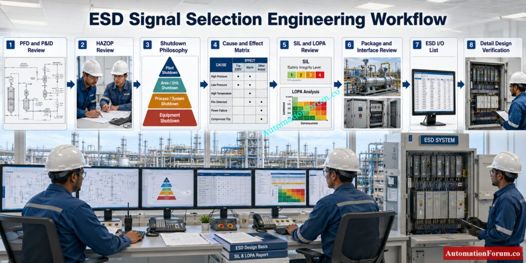

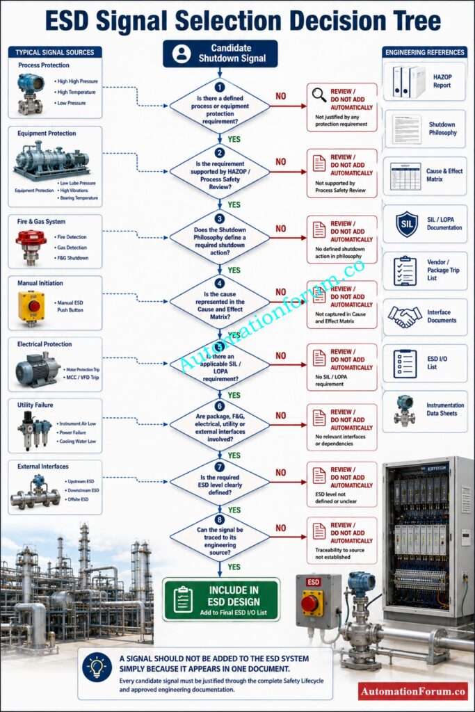

How Are ESD Signals Selected During Basic Design?
During Basic Design, the engineer develops an initial list of candidate ESD signals. At this stage, the objective is to identify possible shutdown requirements rather than immediately freeze the final ESD I O list.
Review the Process Description
The Process Description explains how the facility operates and what abnormal conditions can affect the process.
Engineers can use it to understand major equipment, process flow, operating conditions and potential consequences of abnormal operation. This provides the initial process context for identifying shutdown requirements.
Review the PFD and P and ID
The PFD and P and ID provide the physical and process representation needed for ESD engineering.
The engineer reviews equipment, process lines, valves, pressure protection devices, utilities, isolation points and important process measurements. This review helps identify where shutdown actions may be required.
Review the HAZOP Report
The HAZOP report is a major source of candidate shutdown requirements.
HAZOP recommendations may identify situations such as high pressure, low flow, high temperature, loss of cooling or other abnormal conditions where an automatic protective action may be required.
However, a HAZOP recommendation should not automatically become an ESD input. It must be evaluated against the final engineering philosophy and Cause and Effect requirements.
Prepare For SIS Interviews With Practical Engineering Questions: Safety Instrumented System(SIS) Interview Questions and Answers
Review the Cause and Effect Matrix
The Cause and Effect Matrix defines relationships between initiating causes and required actions.
It is one of the most important documents for confirming whether a candidate signal actually results in an ESD action.
Review the Shutdown Philosophy
The Shutdown Philosophy defines how shutdown levels are organized and how the plant should respond to abnormal conditions.
This document is particularly important when determining whether a signal should initiate plant shutdown, unit shutdown, equipment shutdown or a local equipment action.
Review the Fire and Gas Philosophy
The Fire and Gas Philosophy defines how fire and gas events interact with the ESD system.
It can identify shutdown commands, equipment isolation requirements and interfaces between Fire and Gas and the ESD system.
Review the Interface Philosophy
The Interface Philosophy is essential where ESD signals cross system or package boundaries.
It helps define responsibilities between the ESD system, package systems, electrical systems, HVAC systems, Fire and Gas systems and upstream or downstream facilities.
Review Package Vendor Documents
Package equipment frequently generates important trip signals. Compressors, turbines, boilers, fired equipment and rotating machinery can have dedicated protection systems.
Vendor trip lists, logic diagrams and interface documents must therefore be reviewed before finalizing the ESD I O list.
Review Client and Regulatory Requirements
Client specifications and regulatory requirements may introduce shutdown functions that are not directly identified through the SIL study.
These requirements should be reviewed early because they can influence ESD architecture, interfaces, hardwired requirements and commissioning activities.

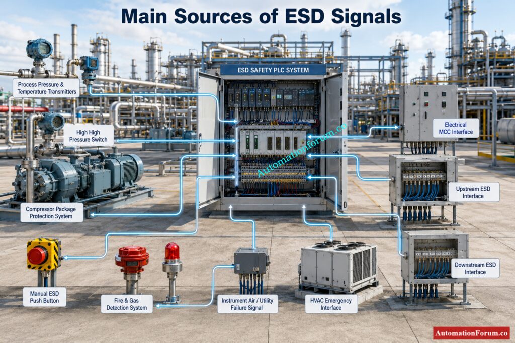

What Are the Main Sources of ESD Signals?
Potential ESD signals can originate from several engineering areas.
- Process protection may include high high pressure, high temperature or another process condition requiring shutdown.
- Equipment protection may include compressor protection, low lubrication pressure or rotating equipment trips.
- Environmental protection may involve shutdown actions intended to prevent process releases or escalation.
- Fire and Gas systems may generate shutdown commands following confirmed fire or gas conditions.
- Package systems may provide dedicated equipment trips that must be transferred to the plant ESD system.
- Utility and electrical systems may provide signals associated with loss of instrument air, power, cooling water or electrical equipment protection.
- External systems may provide upstream ESD, downstream ESD, pipeline trip or other facility interface commands.
The important point is that the source alone does not determine whether the signal belongs in the ESD system. Its required action and engineering purpose must also be established.

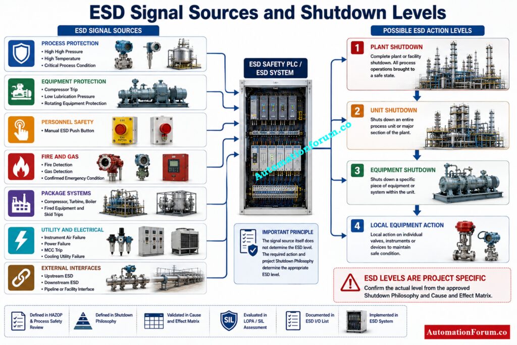

How Is the Required ESD Level Determined?
After identifying candidate signals, engineers must determine the appropriate ESD level.
- Typical project dependent levels may include plant shutdown, unit shutdown, equipment shutdown and local equipment action.
- The actual naming and numbering can vary between projects. One project may use ESD 0 for plant shutdown and another may use a different numbering convention.
- The correct level should therefore be established from the approved Shutdown Philosophy and Cause and Effect Matrix rather than assumed from generic industry terminology.
For example, high pressure on one process vessel may require equipment isolation, while a similar condition on another system may require unit shutdown because of the consequences of continued operation.

During Detail Design, every candidate signal should be challenged before it becomes part of the final ESD I O list.
- The engineer should ask whether the signal is defined in the Cause and Effect Matrix and whether there is a corresponding HAZOP recommendation. The engineer should also check whether it is identified as a SIF through the approved SIL study or LOPA.
- Package requirements must be verified against vendor documentation. Client specifications must also be checked.
- The engineer should confirm whether a hardwired trip is required, whether the signal is needed for operation or maintenance and whether it originates from an external system.
- The Interface Philosophy and vendor interface documents should be reviewed to avoid duplicate or conflicting shutdown commands.
- Finally, the engineer must determine the ESD level associated with the signal.
This verification process prevents a candidate signal from entering the ESD I O list simply because it appears in one document.

- These examples demonstrate why the ESD I O list should not be created from the SIL study alone.

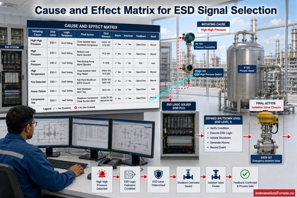

How Does the Cause and Effect Matrix Help Select ESD Signals?
- The Cause and Effect Matrix provides the engineering relationship between an initiating cause and the required final action.
- For each candidate ESD signal, the engineer should identify the cause, applicable ESD level, logic response, final action, final element, alarm, interlock, feedback and reset requirement.
- Consider a high high pressure condition. The engineer must determine whether the condition should generate an alarm only, initiate equipment shutdown, isolate a process section or initiate a larger shutdown.
- This is where the Cause and Effect Matrix becomes more useful than a simple signal list. It explains what the signal is expected to do.
- The ESD I O list should therefore remain consistent with the Cause and Effect Matrix throughout design development.

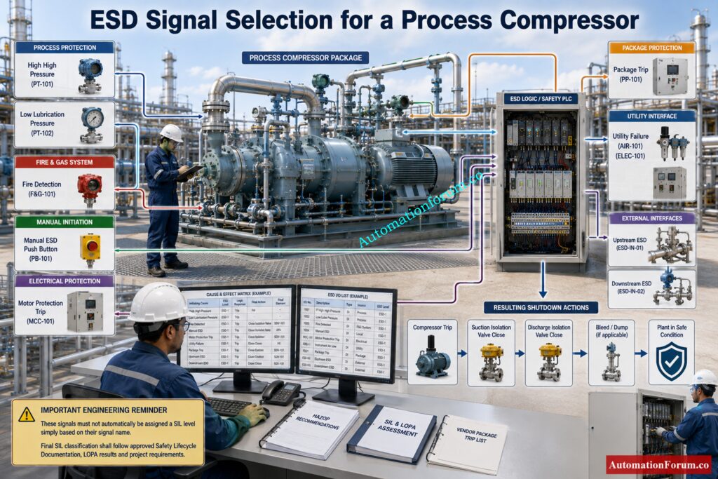

How Are Package Vendor Trips Connected to the ESD System?
- Package systems are a frequent source of ESD interface complexity.
- Compressors, turbines, boilers, fired equipment, rotating machinery and packaged skids may have their own protection logic.
- Electrical systems, MCCs, HVAC systems and Fire and Gas systems also create interfaces.
- Before adding a vendor trip to the ESD system, the engineer should review the vendor logic diagram, trip list, interface document and shutdown requirements.
- The same principle applies to upstream and downstream facilities. A shutdown command crossing a battery limit must have a clearly defined source, destination, action and reset philosophy.

- Poor traceability between HAZOP, Cause and Effect and the ESD I O list makes commissioning difficult because engineers cannot easily establish why a signal exists.

What Is the Practical ESD Signal Selection Workflow?
A practical workflow starts with PFD and P and ID review, followed by HAZOP review and Shutdown Philosophy review.
The engineering team then determines the required ESD level and develops or updates the Cause and Effect Matrix.
SIL and LOPA results are reviewed to identify applicable SIF requirements. Package and external interfaces are then coordinated.
The candidate signals are converted into the ESD I O list and verified during Detail Design.
The process is iterative. A change to the Cause and Effect Matrix, package documentation or interface philosophy can require changes to the ESD I O list and logic.

Consider a process compressor with several potential shutdown signals.
- A high pressure signal may be associated with a process protection function. A high high pressure condition may require a defined shutdown action established through the Cause and Effect Matrix and safety assessment.
- Low lubrication pressure may primarily represent equipment protection and may originate from the compressor package.
- Fire detection may generate a shutdown command through the Fire and Gas interface.
- A motor protection trip may originate from the electrical system or MCC.
- Utility failure may require compressor shutdown because continued operation is not acceptable.
- A package trip may be required to protect the compressor based on vendor requirements.
- Upstream and downstream ESD signals may coordinate shutdown between connected facilities.
- None of these signals should be assigned a SIL level simply from the signal name. The final determination must come from the approved safety lifecycle documentation and project requirements.

- Most importantly, maintain traceability from the HAZOP recommendation to the Cause and Effect Matrix, ESD I O list, implemented logic and commissioning test documentation.
This approach gives the engineering team confidence that every important shutdown function has a clear basis and every selected signal has a defined purpose.

The ESD I O list should not be generated from the SIL study alone. It should be developed by integrating process safety studies, Shutdown Philosophy, Cause and Effect Matrix, SIL and LOPA results, interface engineering, vendor documentation, client requirements, regulatory requirements and practical engineering judgment.
A well designed ESD system is the result of connecting these engineering inputs into one traceable design process. The strongest ESD engineering practice is therefore not to select every possible shutdown signal, but to select the right signal, for the right action, at the right ESD level, with a clearly documented engineering reason. This integrated approach is also consistent with the engineering workflow represented in the supplied reference, from Basic Design through Detail Design and iterative review.

What is ESD 1 and ESD 2?
ESD 1 and ESD 2 are project specific shutdown levels, commonly representing different scopes such as unit shutdown and equipment shutdown.
Their exact meaning must be confirmed from the project Shutdown Philosophy because numbering varies between projects.

Is every ESD signal a SIL rated SIF?
No. An ESD system can contain operational, equipment protection, package, utility and interface signals that are not necessarily assigned a SIL level.
Only functions identified through the applicable safety lifecycle should be treated as SIL rated SIFs.

The Cause and Effect Matrix establishes the relationship between the initiating signal, ESD level, logic and required final action.
It allows engineers to verify that each selected ESD signal has a clearly defined shutdown purpose.
