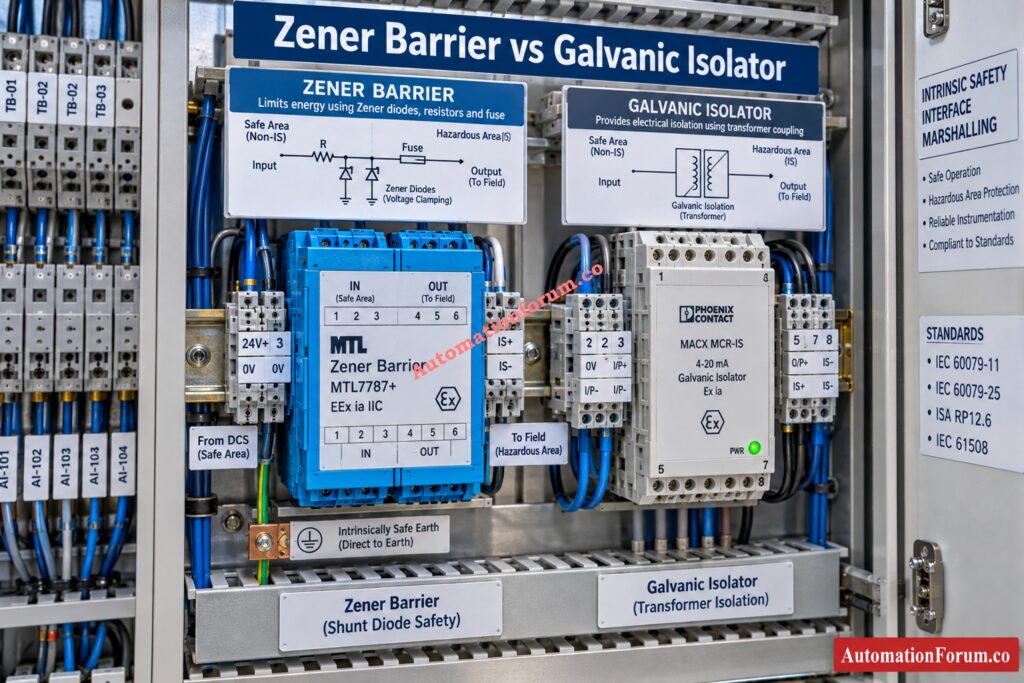

Types of Intrinsic Safety Barriers
A zener barrier normally uses zener diodes, resistors and a fuse to limit voltage and current. Excess energy is diverted through the grounding arrangement.
Because the circuit contains resistance, a voltage drop must be considered during loop design. A zener barrier also requires the grounding arrangement specified by its certification and installation documentation.
Compare IS And Explosion Proof Protection Before Equipment Selection: Difference Between Intrinsically Safe and Explosion-Proof
A galvanic isolator provides electrical isolation between the safe side and hazardous side while also providing the required energy limitation.
Many galvanic isolators require an external power supply and can also provide signal conditioning. Their isolation can simplify grounding arrangements, but the specific product certification and installation requirements must still be checked.

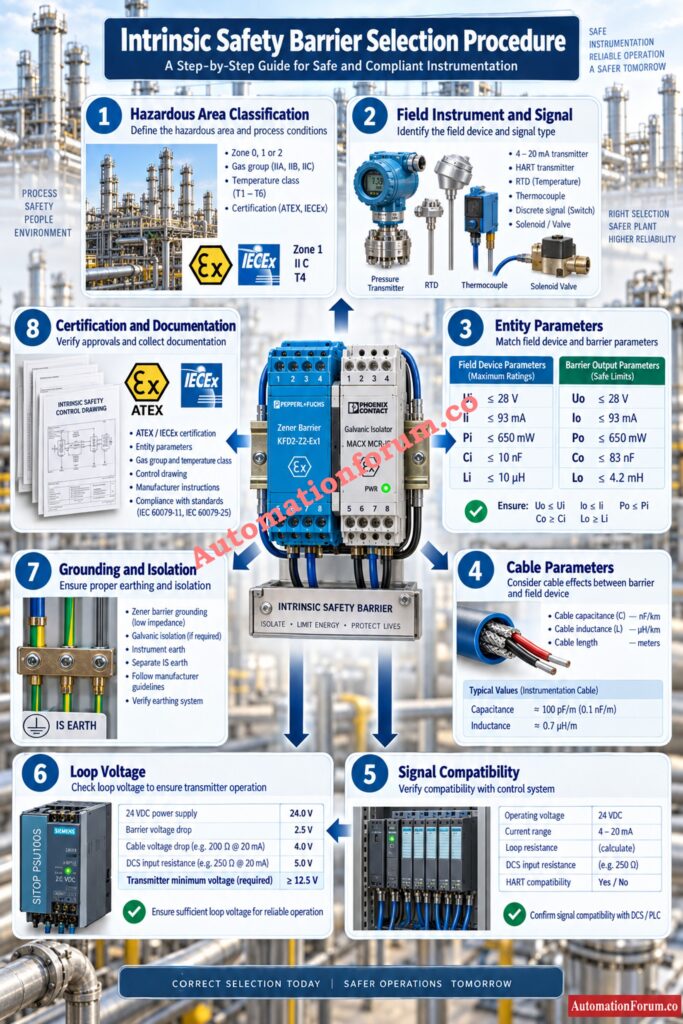

Intrinsic Safety Barrier Selection Procedure
  • Start with the hazardous area classification and project requirements.
  • Check the applicable zone, gas or dust classification, gas group, temperature class, equipment protection requirements and required certification.
  • The field instrument and associated apparatus must have compatible certification for the intended installation. Never select a barrier only from a general zone description.
Check Every IS Installation Detail Before Energizing Instruments: Installation Checklist for Intrinsically Safe Instrument (Apparatus)
Determine exactly what signal the barrier must handle.
Typical applications include:
  1. 4 to 20 mA transmitter
  2. Two wire transmitter
  3. HART transmitter
  4. Discrete input
  5. Discrete output
  6. Solenoid valve
  7. RTD
  8. Thermocouple
  9. Pulse signal
  10. Frequency signal
A barrier designed for one signal function should not automatically be assumed suitable for another signal function.

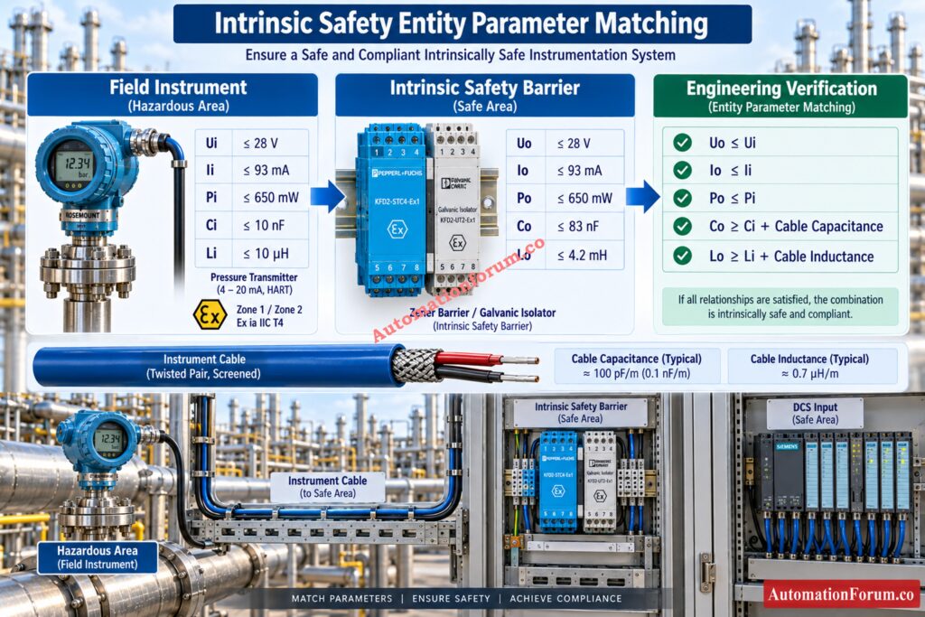

Entity parameters are among the most important checks in IS barrier selection.
For the field instrument, verify:
  • Ui
  • Ii
  • Pi
  • Ci
  • Li
For the barrier, verify:
  • Uo
  • Io
  • Po
  • Co
  • Lo
The basic engineering comparison is:
  • Uo must be less than or equal to Ui
  • Io must be less than or equal to Ii
  • Po must be less than or equal to Pi
  • The available barrier capacitance must accommodate the instrument and cable capacitance.
  • Co must be greater than or equal to Ci plus cable capacitance
  • The available barrier inductance must accommodate the instrument and cable inductance.
  • Lo must be greater than or equal to Li plus cable inductance
These relationships are commonly used for entity concept verification, but the final acceptance must always follow the certified equipment documentation and applicable installation requirements.
Cable characteristics can affect the intrinsic safety assessment, particularly on long instrumentation runs.
For example, consider a 500 metre cable with:
  • Cable capacitance = 80 pF per metre
  • Cable inductance = 0.8 microhenry per metre
Cable capacitance is:
500 × 80 pF = 40 nF
Cable inductance is:
500 × 0.8 microhenry = 400 microhenry
If the transmitter has Ci of 5 nF and Li of 100 microhenry, the barrier must provide sufficient Co and Lo for the combined values.
Required capacitance:
5 nF + 40 nF = 45 nF
Required inductance:
100 microhenry + 400 microhenry = 500 microhenry
This demonstrates why cable data should be checked before final barrier selection.

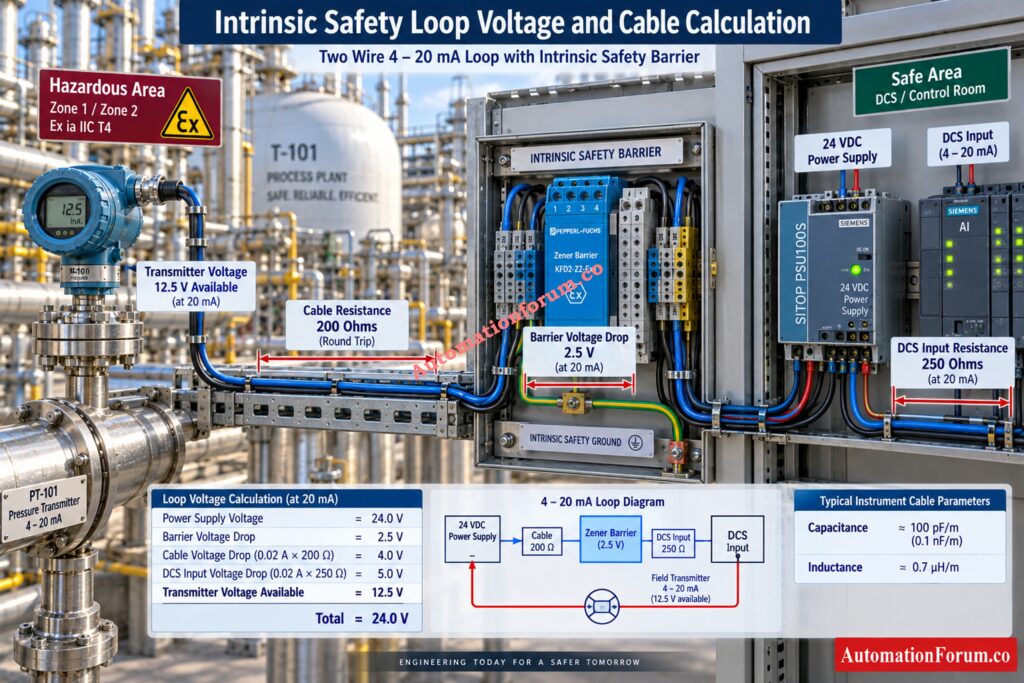

Calculate Intrinsic Safety Loop Voltage
For a two wire transmitter, verify that sufficient voltage remains at the transmitter under maximum loop current.
Consider a simple illustrative circuit:
  • Power supply = 24 VDC
  • Barrier voltage drop = 2.5 V
  • Cable resistance = 200 ohms
  • DCS input resistance = 250 ohms
  • Maximum current = 20 mA
Cable voltage drop:
0.020 × 200 = 4 V
DCS input voltage drop:
0.020 × 250 = 5 V
Voltage remaining for the transmitter:
24 minus 2.5 minus 4 minus 5 = 12.5 V
The calculated 12.5 V gives a tiny operational margin for a transmitter that needs minimum 12 V at 20 mA.
The actual transmitter requirement must come from its manufacturer documentation. This calculation should be performed during engineering rather than discovered during commissioning.

  • Grounding is an important distinction between barrier architectures.
  • A zener barrier uses a grounding path as part of its energy limiting arrangement. The required grounding system must therefore meet the barrier certification and installation requirements.
  • A galvanic isolator uses electrical isolation between circuits and generally does not depend on a dedicated IS grounding path in the same way as a grounded zener barrier.
  • Instrument earth, IS earth and safety earth should not be treated as interchangeable terms. The project grounding philosophy and manufacturer installation instructions must be followed.

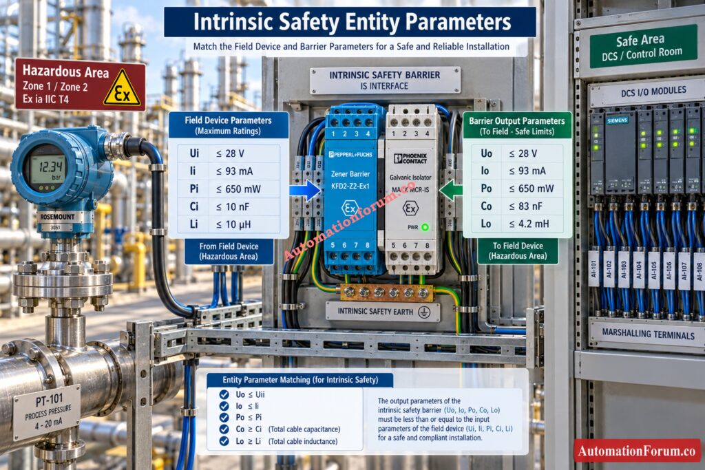

Intrinsic Safety Entity Parameters for Barrier Selection
Consider a two wire 4 to 20 mA pressure transmitter installed in a hazardous area and connected to a DCS in a safe area.
Illustrative transmitter parameters:
Ui = 30 V
Ii = 100 mA
Pi = 0.70 W
Ci = 5 nF
Li = 100 microhenry
Illustrative barrier parameters:
Uo = 28 V
Io = 93 mA
Po = 0.65 W
Co = 83 nF
Lo = 2 mH
Cable parameters:
Cable capacitance = 40 nF
Cable inductance = 400 microhenry
The entity checks are:
28 V is less than 30 V
93 mA is less than 100 mA
0.65 W is less than 0.70 W
Understand Explosion Proof Protection Before Choosing Hazardous Area Equipment: Exploring Explosion-Proof: Safety in Hazardous Environment
Intrinsic Safety Entity Parameter Calculation Example
Available capacitance after transmitter capacitance:
83 nF minus 5 nF = 78 nF
The cable requires 40 nF, so the capacitance requirement is satisfied in this illustrative example.
Available inductance after transmitter inductance:
2 mH minus 0.1 mH = 1.9 mH
The cable requires 0.4 mH, so the inductance requirement is also satisfied.

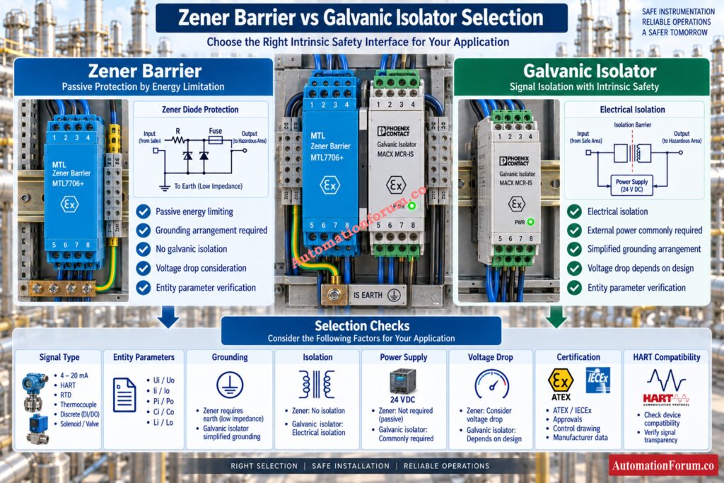

Zener Barrier and Galvanic Isolator Comparison
ParameterZener barrierGalvanic isolator
Basic arrangementPassive energy limiting circuitIsolated active interface
IsolationNo galvanic isolationProvides galvanic isolation
GroundingGrounding arrangement is essentialDedicated IS earth generally not required
PowerNormally passiveCommonly requires external power
Voltage dropMust be consideredDepends on the specific module
Signal handlingDepends on barrier designDepends on isolator design
MaintenanceFuse and grounding checks may applyPower and module health checks may apply
Selection focusEntity values and groundingEntity values, isolation and power
GlobalSpec identifies zener barriers as passive devices and galvanic isolators as isolated interfaces, with both available for intrinsic safety applications.

Before approving an IS barrier selection, verify:
  1. Hazardous area classification
  2. Applicable certification
  3. Signal type
  4. Ui and Uo
  5. Ii and Io
  6. Pi and Po
  7. Ci and Co
  8. Li and Lo
  9. Cable capacitance
  10. Cable inductance
  11. Loop resistance
  12. Voltage drop
  13. Transmitter minimum voltage
  14. Grounding requirements
  15. Isolation requirements
  16. HART compatibility
  17. Gas group
  18. Temperature class
  19. Manufacturer instructions
  20. Complete loop verification

Select an IS Barrier by evaluating the hazardous area, kind of signal, certification, entity specifications and cable characteristics.
Also check voltage loss, grounding, HART compatibility and the whole instrument loop.

Zener barriers use components like zener diodes to limit the amount of electrical energy and require the grounding configuration specified.
A galvanic isolator offers electrical isolation between the safe area circuits and the hazardous area circuits.
Ui, Ii, and Pi define the maximum voltage, current, and power accepted by the field instrument.
Uo, Io, and Po define the maximum voltage, current, and power supplied by the associated apparatus.

Common types are zener barriers and galvanic isolators for certain intrinsically safe instrumentation applications.
Selection is based on the type of signal, isolation, grounding, parameters of the entity, certification and project requirements.

Intrinsic safety barrier selection is a complete engineering verification rather than a simple component selection exercise. The correct barrier must satisfy hazardous area requirements, certification, entity parameters, cable characteristics, voltage requirements, signal compatibility, grounding requirements and control system interfaces.
For instrumentation engineers, the most important practice is to verify the complete loop from the DCS or PLC through the barrier and cable to the hazardous area instrument. This approach reduces commissioning problems and provides a clear technical basis for hazardous area instrumentation design.
