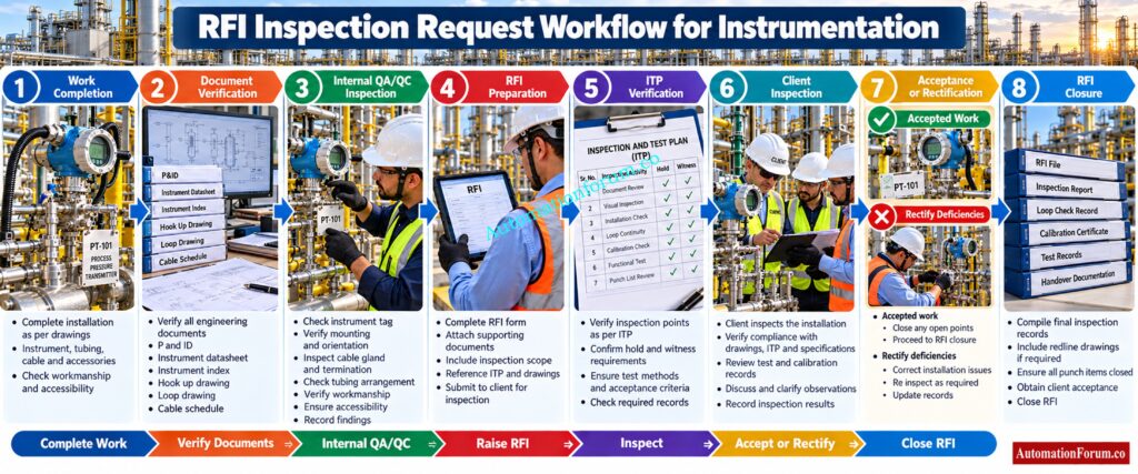

RFI Inspection Request Procedure and Workflow
A practical RFI workflow normally follows this sequence:
Work completion → Document verification → Internal QA/QC inspection → RFI preparation → ITP inspection point verification → Client inspection → Acceptance or rectification → RFI closure → QA/QC dossier update
The important point is that the RFI should come after technical readiness, not before it.

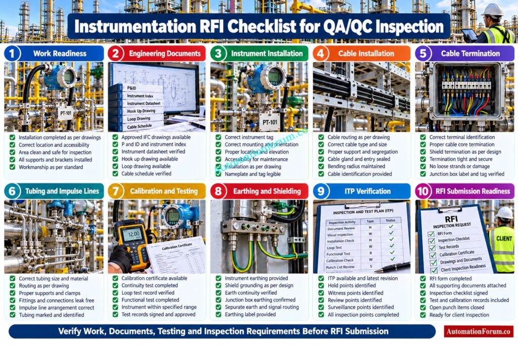

RFI Checklist for Instrumentation and E&I QA/QC
Before submitting an RFI, the QA/QC inspector should verify the complete physical installation, engineering documentation, testing status, inspection requirements and supporting records. The following detailed checklist can be used as a practical pre inspection readiness check.
| Inspection Category | Detailed Verification Point | What the QA/QC Inspector Should Check | Typical Evidence or Reference | Status |
| Work Readiness | Work completely installed | Confirm that the defined instrumentation or E&I scope is physically complete and no major installation activity remains outstanding. | Approved drawing, construction completion record | Confirm |
| Work Readiness | Installation ready for inspection | Ensure the equipment is physically accessible and can be inspected without additional construction work. | Site inspection | Confirm |
| Work Readiness | Previous activities completed | Verify that all prerequisite construction, mechanical or electrical activities required before the inspection are complete. | Approved ITP and work sequence | Confirm |
| Engineering Documents | Latest approved drawing | Confirm that the installation has been executed using the latest approved drawing revision. | IFC drawing | Confirm |
| Engineering Documents | Drawing revision | Check that the drawing revision mentioned in the RFI matches the current approved revision. | Document control system | Confirm |
| Engineering Documents | Instrument index | Verify the instrument tag, service and location against the approved instrument index. | Instrument index | Confirm |
| Engineering Documents | Instrument datasheet | Confirm instrument type, range, process connection and other applicable details. | Instrument datasheet | Confirm |
| Engineering Documents | P and ID | Verify the instrument identification and process connection against the approved P and ID. | Approved P and ID | Confirm |
| Engineering Documents | Hook up drawing | Verify mounting, tubing, manifold, fittings and installation arrangement. | Approved hook up drawing | Confirm |
| Engineering Documents | Loop drawing | Confirm signal wiring, terminals and loop connections where applicable. | Approved loop drawing | Confirm |
| Engineering Documents | Cable schedule | Verify cable number, source, destination and applicable cable information. | Approved cable schedule | Confirm |
| Engineering Documents | Termination drawing | Confirm that field and panel terminations match the approved termination details. | Termination drawing | Confirm |
| Engineering Documents | Junction box drawing | Verify junction box identification, terminals, cable entries and connections. | Junction box drawing | Confirm |
| Material Verification | Instrument model | Confirm that the installed instrument matches the approved equipment specification. | Datasheet and material record | Confirm |
| Material Verification | Material identification | Verify equipment identification and applicable material requirements. | Material documentation | Confirm |
| Material Verification | Nameplate | Check instrument nameplate details against the approved datasheet and tag. | Physical inspection | Confirm |
| Material Verification | Certificates | Verify applicable material, conformity or manufacturer documentation where required. | Approved certificates | Confirm |
| Instrument Installation | Instrument tag | Confirm that the physical tag matches the approved instrument index and drawings. | Instrument index and field inspection | Confirm |
| Instrument Installation | Installation location | Verify that the instrument is installed at the correct location shown in the approved engineering documents. | Layout drawing and field inspection | Confirm |
| Instrument Installation | Mounting arrangement | Check mounting supports, brackets, bolts and mechanical stability. | Hook up drawing and site inspection | Confirm |
| Instrument Installation | Orientation | Verify that the instrument orientation is suitable for the application and matches the approved installation arrangement. | Hook up drawing and manufacturer information | Confirm |
| Instrument Installation | Accessibility | Confirm that the instrument can be safely accessed for operation, calibration and maintenance. | Site inspection | Confirm |
| Instrument Installation | Environmental protection | Check that the installation provides the required protection from the surrounding process environment. | Project specification and site inspection | Confirm |
| Cable Installation | Cable identification | Verify cable number and identification against the cable schedule. | Cable schedule | Confirm |
| Cable Installation | Cable routing | Check that cable routing follows the approved route and applicable installation requirements. | Cable routing drawing and site inspection | Confirm |
| Cable Installation | Cable support | Verify that cables are properly supported and mechanically protected. | Installation specification | Confirm |
| Cable Installation | Cable gland | Confirm correct gland type, size, installation and tightening. | Cable schedule and installation specification | Confirm |
| Cable Installation | Cable entry | Verify that cable entry into the instrument or junction box is correct and properly sealed. | Site inspection | Confirm |
| Cable Termination | Terminal identification | Confirm field terminals match the approved termination drawing. | Termination drawing | Confirm |
| Cable Termination | Core identification | Verify individual cable cores and wire numbers. | Wiring and termination drawing | Confirm |
| Cable Termination | Termination quality | Check that terminals are secure, correctly terminated and free from visible workmanship defects. | Visual inspection | Confirm |
| Cable Termination | Shield connection | Verify shield termination according to the approved project philosophy. | Wiring diagram and project specification | Confirm |
| Tubing Installation | Tubing size | Confirm tubing size and material against the approved hook up drawing and specification. | Hook up drawing | Confirm |
| Tubing Installation | Tubing routing | Check tubing routing, support and protection from mechanical damage. | Site inspection | Confirm |
| Tubing Installation | Tube support | Verify adequate support and acceptable installation arrangement. | Installation specification | Confirm |
| Tubing Installation | Fittings | Check tube fittings, connections and mechanical integrity. | Hook up drawing and visual inspection | Confirm |
| Impulse Tubing | Impulse line arrangement | Verify impulse tubing arrangement against the approved hook up drawing. | Hook up drawing | Confirm |
| Impulse Tubing | Slope | Where applicable, verify that impulse lines have the required slope for the measurement service. | Project specification and hook up drawing | Confirm |
| Impulse Tubing | Connection integrity | Check all connections for correct assembly and visible leakage or workmanship concerns. | Visual inspection and applicable test record | Confirm |
| Control Valve | Valve identification | Verify valve tag, size and specification against approved documents. | Valve datasheet and P and ID | Confirm |
| Control Valve | Actuator installation | Verify actuator mounting, orientation and mechanical arrangement. | Approved drawing and manufacturer information | Confirm |
| Control Valve | Positioner | Confirm positioner installation, tubing and signal connection. | Hook up and loop drawings | Confirm |
| Control Valve | Accessories | Verify solenoid valves, air filter regulator and other applicable accessories. | Valve datasheet and hook up drawing | Confirm |
| Calibration | Calibration status | Confirm that required instruments have been calibrated before inspection where applicable. | Calibration certificate | Confirm |
| Calibration | Calibration range | Verify that the calibration range corresponds with the approved instrument requirements. | Datasheet and calibration certificate | Confirm |
| Calibration | Calibration result | Check that recorded calibration results satisfy the applicable project acceptance requirements. | Calibration certificate | Confirm |
| Calibration | Certificate traceability | Verify instrument tag, serial number and calibration identification. | Calibration certificate | Confirm |
| Testing | Continuity test | Confirm required continuity testing has been completed where applicable. | Continuity test record | Confirm |
| Testing | Insulation testing | Verify applicable insulation testing has been completed and recorded according to project requirements. | Test record | Confirm |
| Testing | Loop testing | Confirm required loop testing has been completed where the inspection stage requires it. | Loop test record | Confirm |
| Testing | Functional testing | Verify required functional tests have been completed. | Functional test record | Confirm |
| Testing | Instrument response | Confirm instrument response is satisfactory where functional verification is applicable. | Test record | Confirm |
| Earthing | Instrument earthing | Verify required instrument earthing connections. | Earthing drawing and site inspection | Confirm |
| Earthing | Cable shield grounding | Confirm shield grounding arrangement according to the approved project philosophy. | Wiring diagram | Confirm |
| Earthing | Panel or junction box earthing | Verify applicable protective earthing connections. | Electrical drawing and site inspection | Confirm |
| ITP Verification | Applicable ITP | Confirm that the correct approved ITP applies to the activity. | Approved ITP | Confirm |
| ITP Verification | Inspection point | Identify whether the activity is subject to Hold Point, Witness Point, Review Point or Surveillance Point requirements. | Approved ITP | Confirm |
| ITP Verification | Acceptance criteria | Verify that the inspection will be performed against the applicable acceptance requirements. | ITP and specification | Confirm |
| Inspection Checklist | Checklist availability | Confirm that the correct approved inspection checklist is available. | Approved checklist | Confirm |
| Inspection Checklist | Checklist completion | Complete all applicable inspection points before requesting client inspection. | Inspection checklist | Confirm |
| Inspection Checklist | Inspector verification | Ensure required internal inspection signatures or approvals are completed according to project procedure. | QA/QC inspection record | Confirm |
| Supporting Documents | Calibration certificates | Attach required calibration certificates. | Calibration records | Confirm |
| Supporting Documents | Test records | Attach applicable test and verification records. | Test documentation | Confirm |
| Supporting Documents | Material records | Provide applicable material or equipment documentation where required. | Material documentation | Confirm |
| Supporting Documents | Previous inspection records | Verify relevant previous inspection or prerequisite records where applicable. | QA/QC records | Confirm |
| RFI Details | Project information | Confirm project name, area and system information. | RFI form | Confirm |
| RFI Details | Instrument tag | Verify the exact field tag number. | RFI and instrument index | Confirm |
| RFI Details | Location | Confirm the physical location matches the RFI description. | RFI and site inspection | Confirm |
| RFI Details | Activity description | Clearly describe the specific work being offered for inspection. | RFI form | Confirm |
| RFI Details | Drawing reference | Enter the correct approved drawing number and revision. | RFI and document register | Confirm |
| RFI Details | ITP reference | Enter the applicable ITP reference and inspection point. | Approved ITP | Confirm |
| Site Condition | Accessibility | Ensure the client inspector can safely access the equipment. | Site inspection | Confirm |
| Site Condition | Housekeeping | Confirm that the inspection area is clean and free from unnecessary materials or obstruction. | Site inspection | Confirm |
| Site Condition | Identification | Ensure instrument and equipment identification is clearly visible. | Field inspection | Confirm |
| Site Condition | Safety readiness | Confirm that the inspection can be conducted under the applicable site safety requirements. | Project safety procedure | Confirm |
| Internal QA/QC | Internal inspection completed | Confirm that the contractor QA/QC inspector has already inspected the work. | Internal inspection record | Confirm |
| Internal QA/QC | Deficiencies corrected | Verify that identified construction deficiencies have been corrected before RFI submission. | Punch or observation record | Confirm |
| Internal QA/QC | Documentation reconciled | Confirm physical installation and engineering documentation are consistent. | Drawings, index and field inspection | Confirm |
| Final RFI Readiness | Client inspection readiness | Confirm that the complete inspection package is ready before inviting the client or consultant. | RFI package | Confirm |
| Final RFI Readiness | No open critical issues | Verify that no unresolved issue can reasonably prevent acceptance. | Punch and observation records | Confirm |
| Final RFI Readiness | RFI submitted correctly | Confirm all required RFI fields and attachments are complete before submission. | Completed RFI | Confirm |

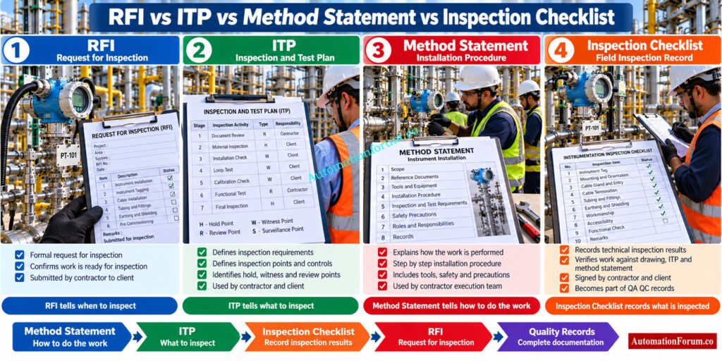

RFI vs ITP vs Method Statement vs Inspection Checklist
| Document | Primary purpose |
| Method Statement | Explains how the work will be performed |
| ITP | Defines what is inspected, when it is inspected and applicable inspection controls |
| RFI | Formally notifies the designated party that defined work is ready for inspection |
| Inspection Checklist | Records the checks performed and their results |
These documents work together. One does not replace another.
