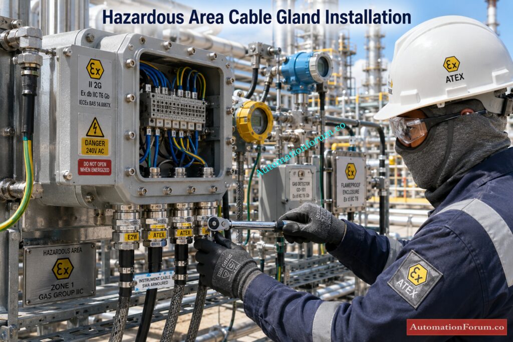

Hazardous Area Cable Gland Selection
Hazardous area selection is not just about the gland body. It is about the full system: zone classification, cable type, enclosure, installation method, and compliance with the area protection standard.
A safe area does not require explosive atmosphere certification, but quality sealing and retention are still important.
Zone 2 means an explosive atmosphere is not likely in normal operation and, if it occurs, it lasts only a short time. Cable glands must still be suitable for the equipment and enclosure.
Zone 1 is higher risk. Equipment and accessories must be selected with stricter control and proper certification.
Zone 0 is the highest gas-risk area, where explosive atmosphere is present continuously or for long periods. Selection and installation become highly restrictive.
Zone 22 is a dust hazardous area with lower frequency and duration of explosive dust atmosphere.
Zone 21 has a higher dust risk and requires stronger attention to sealing and certification.
The calculator’s hazardous-area selection of E2W ATEX reflects this kind of special requirement.
