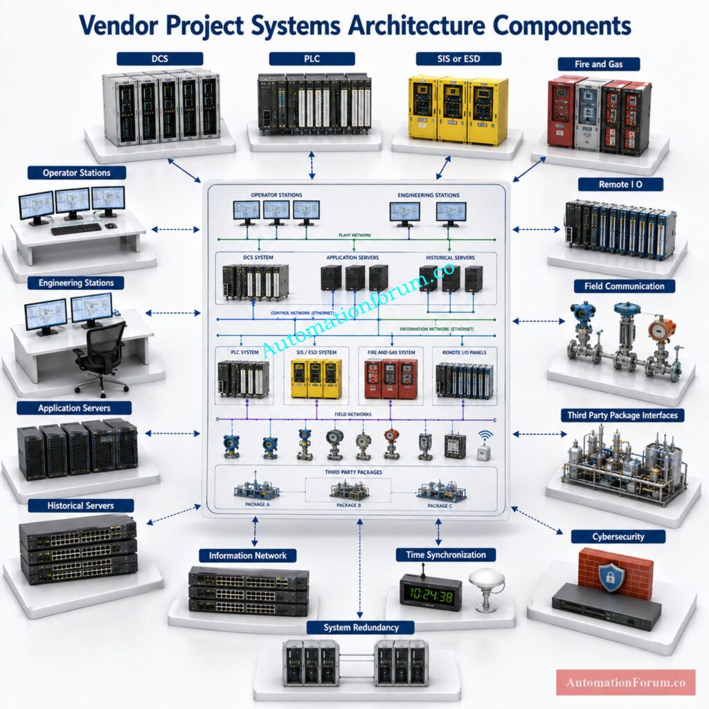

What Should Be Included in a Vendor Project Systems Architecture Document?
The exact content depends on the project and system package, but a typical vendor system architecture document may identify the following:
DCS, PLC, SIS and ESD Control System Platform
The architecture should show the selected DCS, PLC, SIS or ESD platform and the major controllers associated with each system.
Servers and Operator Workstations
Operator stations, engineering stations, application servers, historical servers and other important system computers should be identified where applicable.
Know The Essential I&C Standards Behind Reliable Engineering: Key Instrumentation & Control (I&C) Standards Every Engineer Should Know
Control Network and Information Network
The document should clearly show control networks, information networks, network switches and important communication paths.
Network redundancy should be visible where it is required by the project.
Remote I O and Field Communication
Remote I O arrangements, field communication networks, serial interfaces and industrial Ethernet connections should be identified where applicable.
Third Party Package Interfaces
Interfaces with package PLCs, analyzers, Fire and Gas systems, electrical systems and other third party systems should be clearly represented.
Avoid Commissioning Failures With Proper Loop Testing: Loop Check vs Functional Test in Instrumentation Commissioning
Time Synchronization and Network Services
The architecture should indicate how important systems receive time synchronization when required.
Cybersecurity and Network Segregation
Where cybersecurity requirements apply, the architecture should provide sufficient information about network segregation, access arrangements and system boundaries.
System Redundancy and Spare Capacity
Important redundancy arrangements for controllers, networks, servers and other critical components should be clearly identified.
The architecture should always be read together with the relevant specifications, material requisition, bill of material and interface documents rather than being treated as a standalone document.
