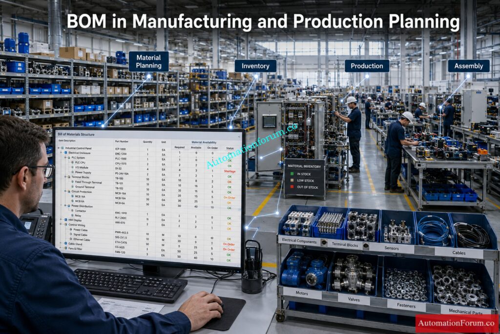

How BOM Supports Manufacturing and Production Planning
Almost all the major production activities are supported by a well kept BOM.
It helps production planners determine what materials are needed and it helps purchasing teams work out what they need to order. BOM data is used by inventory teams to understand material use and by production teams to develop and execute manufacturing orders.
BOM data can be used for production scheduling, assembly, costing, quality control, engineering changes and maintenance.
The connection between BOM and MRP is especially crucial. MRP also uses production needs and inventory information to determine what materials must be acquired or manufactured . This is based on the product structure and needed quantities from the BOM .
