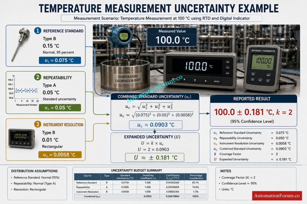

For example, if two independent contributors have standard uncertainties of 0.05 °C and 0.03 °C, respectively, and the sensitivity coefficients are 1.
The combined standard uncertainty is
uc = √(0.05² + 0.03²)
uc = 0.0583 °C approximately

If the combined standard uncertainty is 0.0583 °C and k is 2:
U = 2 × 0.0583
U = 0.1166 °C
The result can therefore be expressed approximately as:
100.0 ± 0.117 °C, k = 2
