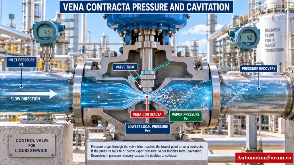

What Is Vena Contracta Pressure in a Control Valve?
How Vena Contracta Pressure Develops
The vena contracta is the region where the flowing liquid reaches a highly restricted flow area and the local pressure can reach a minimum.
The calculator estimates vena contracta pressure using:
Pvc ≈ P1 − ΔP / FL²
Here, Pvc is the estimated vena contracta pressure.
Vena Contracta Pressure Compared With Vapor Pressure
If calculated Pvc remains above vapor pressure, the entered condition indicates comparatively lower cavitation risk.
If Pvc falls below vapor pressure, vapor formation becomes possible. The calculator then checks the downstream pressure to distinguish between cavitation risk and flashing risk.
This is useful during commissioning because the downstream pressure alone may look acceptable while the pressure near the valve trim is already low enough to produce vapor.

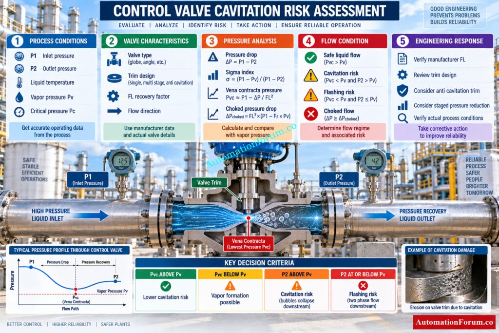

Control Valve Cavitation Calculator Inputs
| Parameter | Meaning | Engineering significance | Typical source |
| P1 | Absolute inlet pressure | Defines upstream pressure available to the valve | Process data sheet or operating data |
| P2 | Absolute outlet pressure | Determines valve pressure drop | Process design or operating data |
| Pv | Liquid vapor pressure | Determines when vapor formation can begin | Fluid property data at actual temperature |
| Pc | Critical pressure | Used to calculate the critical pressure factor FF | Fluid property data |
| FL | Liquid pressure recovery factor | Influences vena contracta pressure and choked pressure drop | Valve manufacturer data |
Why Absolute Pressure Is Required for Cavitation Calculation
The calculator requires absolute pressure for P1, P2, Pv and Pc. Gauge pressure should not be entered directly into these equations because vapor pressure and critical pressure are absolute pressure quantities.
Why Vapor Pressure Must Match Operating Temperature
Vapor pressure must also correspond to the actual liquid temperature. Using vapor pressure from a different temperature can change the cavitation assessment significantly.
The calculator provides screening FL values for globe valve, high recovery globe, ball valve and butterfly valve service. These values are intended for preliminary assessment. Certified manufacturer data should be used for final sizing and valve selection.

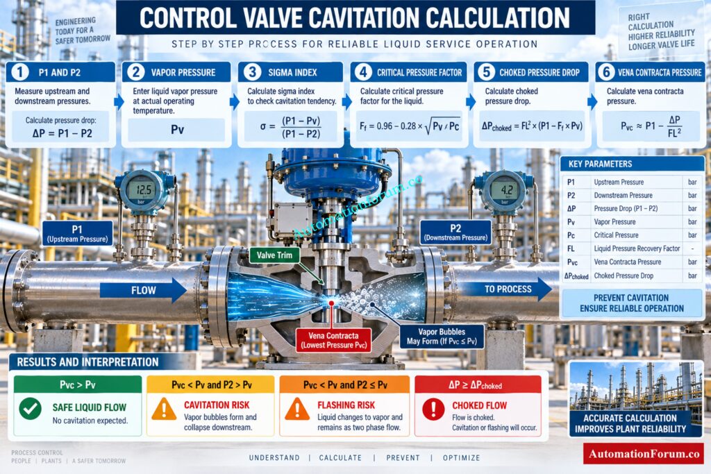

How to Calculate Control Valve Cavitation
The calculator follows a defined sequence.
First, pressure drop is calculated:
ΔP = P1 − P2
This represents the total pressure difference across the valve.
The sigma index is then calculated:
σ = (P1 − Pv) / (P1 − P2)
The critical pressure factor is calculated using:
Ff = 0.96 − 0.28 × √(Pv / Pc)
The choked pressure drop is then determined:
ΔPchoked = FL² × (P1 − Ff × Pv)
Finally, the calculator estimates the vena contracta pressure:
Pvc ≈ P1 − ΔP / FL²
The calculator then compares these computed values with the process conditions entered to determine the expected flow condition.

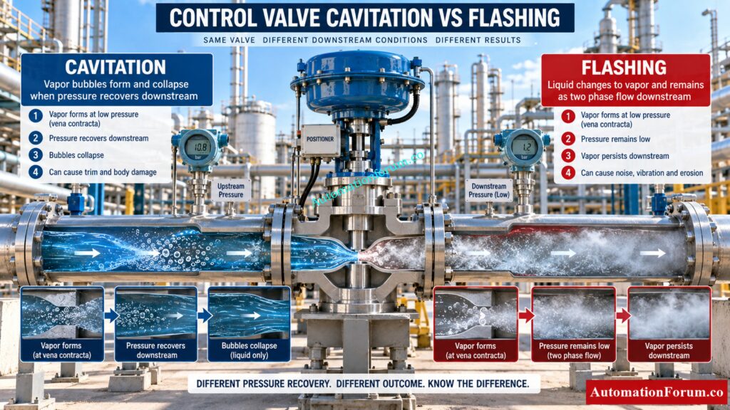

Control Valve Cavitation vs Flashing
| Condition | Pressure behavior | Vapor behavior | Typical concern | Engineering response |
| Safe liquid flow | Pvc remains above Pv | No vapor formation predicted by the screening calculation | Lower cavitation risk | Verify detailed valve sizing |
| Cavitation risk | Pvc falls below Pv and P2 is above Pv | Bubbles form and can collapse after pressure recovery | Noise, vibration and erosion | Review trim and valve design |
| Flashing risk | Pvc falls below Pv and P2 remains at or below Pv | Vapor can persist downstream | Two phase erosion and flow problems | Review valve and downstream design |
| Choked flow | Actual ΔP reaches or exceeds calculated choked ΔP | Flow becomes pressure limited | Limited additional flow response | Review sizing and trim |
How Vena Contracta Pressure Identifies Cavitation or Flashing
Cavitation and flashing should not be treated as the same condition.
Cavitation occurs when pressure falls below vapor pressure and subsequently recovers above it. Flashing occurs when the pressure remains at or below vapor pressure downstream, allowing vapor to persist.

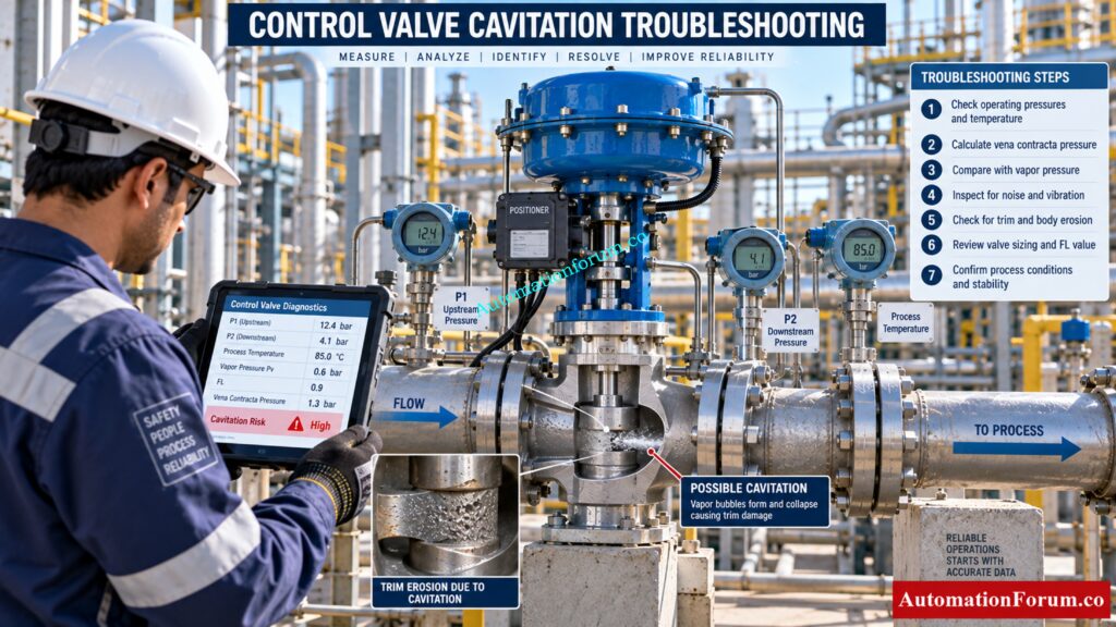

Control Valve Cavitation Troubleshooting
When unexpected valve noise appears, check actual inlet and outlet pressure first. Compare the measured values with the design case rather than assuming that the valve has suddenly developed a mechanical fault.
For vibration, inspect valve trim condition, valve supports, downstream piping and operating stability. Cavitation can create vibration, but loose supports or other hydraulic problems can produce similar symptoms.
If there is trim erosion, compare the position of the damage to the projected pressure recovery region. Check the actual process temperature and pressure.
If erosion is present in downstream piping, check if flashing or two phase flow is continuing after the valve.
For unstable flow, verify process pressure, temperature and valve operating position. A valve operating significantly away from its design condition can behave differently from the original sizing case.
Incorrect vapor pressure is another common source of misleading analysis. Confirm the liquid composition and actual operating temperature.
Finally, verify FL. An approximate value can be useful for screening, but final troubleshooting and valve selection should use the actual manufacturer’s coefficient.

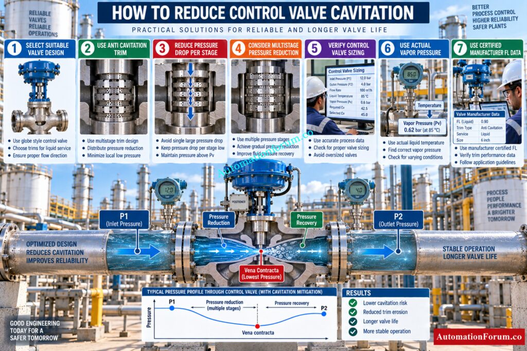

How to Reduce Control Valve Cavitation
The appropriate solution depends on the pressure drop, liquid properties, flow rate and valve construction.
Possible engineering approaches include selecting suitable valve geometry, using anti cavitation trim, distributing pressure reduction across multiple stages and changing the valve sizing where appropriate.
Increasing downstream pressure may also reduce the severity of the pressure condition when the process design permits it.
For severe service, review the manufacturer’s cavitation data rather than relying only on a basic pressure calculation.

What is the cavitation formula?
Control valve cavitation analysis commonly uses pressure drop, vapor pressure, recovery factor FL and vena contracta pressure.
In this calculator, the key screening relationship is Pvc ≈ P1 − ΔP / FL².
What is cavitation in a control valve?
Control valve cavitation occurs when local liquid pressure falls below vapor pressure and vapor bubbles form near the valve trim.
When pressure recovers downstream, these bubbles can collapse and cause noise, vibration and erosion.
How to calculate control valve?
Control valve analysis starts with inlet pressure, outlet pressure, vapor pressure, critical pressure and recovery factor FL.
The calculator uses these values to determine pressure drop, sigma index, vena contracta pressure and choked pressure drop.

What is vena contracta pressure?
The vena contracta pressure is the lowest local pressure that the liquid develops in the vicinity of the limited flow region of a control valve.
The computed Pvc can be compared with the vapor pressure to indicate the locations of cavitation or flashing.

What is the difference between cavitation and flashing?
Cavitation occurs when vapor forms at low pressure and then collapses when pressure recovers above vapor pressure.
Flashing occurs when downstream pressure remains at or below vapor pressure, allowing vapor to continue through the downstream piping.

How should control valve cavitation be troubleshot?
Check actual inlet pressure, outlet pressure, process temperature and liquid properties before comparing the condition with the original valve sizing data.
Then inspect the valve trim and downstream piping for noise, vibration, erosion or other evidence of cavitation and flashing.
How is control valve cavitation risk calculated?
Cavitation risk can be screened by calculating pressure drop, sigma index and vena contracta pressure and comparing Pvc with liquid vapor pressure.
The final assessment should also consider valve geometry, certified FL data, operating conditions and manufacturer recommendations.
How can control valve cavitation be reduced?
Cavitation can sometimes be reduced by selecting suitable valve geometry, anti cavitation trim or staged pressure reduction.
The correct solution depends on pressure drop, liquid properties, temperature, flow rate and the selected valve design.
