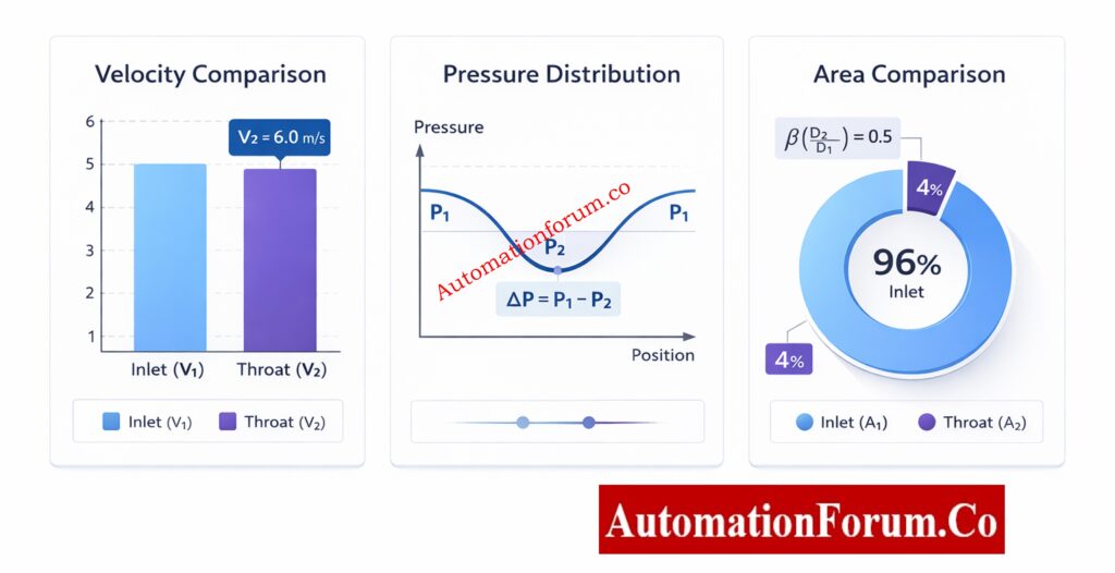

Visual Interpretation of Venturi Tube Flow Diagram
Venturi Geometry Diagram
- Shows inlet, throat, and outlet
- Visualizes pressure recovery
- Confirms dimensional inputs
Velocity Profile Chart
- Compares V₁ and V₂
- Highlights acceleration effects
Pressure Distribution Plot
- Shows pressure dip at the throat
- Useful for cavitation analysis
Area Comparison Chart
- Reinforces continuity principle
- Excellent for teaching and design reviews
