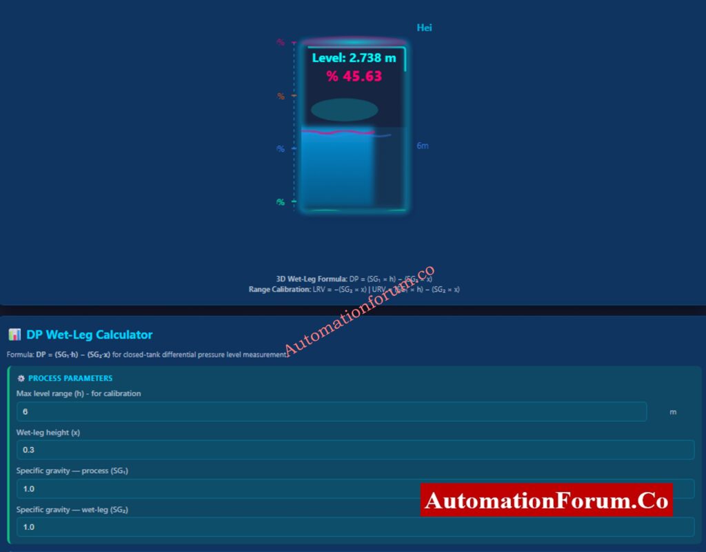

📊 DP Wet-Leg Calculator
Formula: DP = (SG₁·h) − (SG₂·x) for closed-tank differential pressure level measurement.

DP Formula Used for Wet-Leg Level Calculation
The standard closed-tank wet-leg formula is used by our calculator:
DP=(SG1⋅h)−(SG2⋅x)
Where:
- SG₁ = Specific gravity of process fluid
- SG₂ = Specific gravity of wet-leg fluid
- h = Liquid height inside tank
- x = Wet-leg height
Interpretation:
- The high-pressure (HP) side senses hydrostatic pressure of the liquid column → SG₁ × h
- The low-pressure (LP) side senses pressure created by the wet-leg → SG₂ × x
- The difference between these two pressures is measured by the transmitter.
At every tank level, this formula guarantees precise DP values. The calculator in the document uses the same reasoning.
Open Tank Level Transmitter Calculator – EPC Engineer’s Full Design Guide: Open Tank Level Transmitter Calculator – Complete Guide for EPC Instrumentation Engineers
How to Calculate LRV and URV for DP Transmitters
In order to properly configure a transmitter, we need to compute:
- LRV = Differential pressure at 0% level (empty tank)
- URV = Differential pressure at 100% level (full tank)
LRV (Empty Tank)
LRV=-(SG2⋅x)
This is normally negative, because only the wet-leg acts on the LP side when the tank is empty.
URV (Full Tank)
URV=(SG1⋅H)−(SG2⋅x)
The entire measurement span is represented by this.
In order to prevent conversion errors and guarantee precise calibration during commissioning, our calculator automatically calculates LRV and URV in a variety of pressure units (kPa, mbar, mmWC, bar, psi, and inH2O).

Step-by-Step Example: Wet-Leg Level Calculation
Let’s examine a different real-world engineering scenario to gain a clear understanding of how differential pressure behaves in a closed-tank wet-leg configuration. This example shows how the LRV and URV values of the DP transmitter are affected by tank height, process fluid density, and wet-leg fluid density.
Given Process Conditions
| Parameter | Value |
| Process fluid specific gravity (SG₁) | 0.85 |
| Wet-leg fluid specific gravity (SG₂) | 1.10 |
| Tank height (H) | 8 meters |
| Wet-leg height (x) | 0.5 meters |
These numbers show a typical hydrocarbon storage tank with a heavier sealing liquid in the wet-leg and a lighter process fluid than water.
Step 1 – Calculate LRV (Transmitter Output at 0% Level)
LRV occurs when the tank is empty, meaning h = 0.
The standard wet-leg formula:
LRV=−(SG2⋅x)
Substituting values:
LRV=−(1.10×0.5)
LRV=−0.55(meters of water equivalent)
Interpretation:
Because the wet-leg is exerting downward pressure on the LP side, the transmitter will always display a negative differential pressure at zero level.
Step 2 – Calculate URV (Transmitter Output at 100% Level)
URV occurs when the tank is full, meaning:
h=H=8m
Apply the wet-leg DP formula:
URV=(SG1⋅H)−(SG2⋅x)
Substitute values:
URV=(0.85×8)−(1.10×0.5)
URV = 6.8 – 0.55
URV = 6.25meters of water equivalent
Interpretation:
The transmitter detects wet-leg pressure on the LP side and hydrocarbon head pressure on the HP side when the tank is full. The measurement span that can be used is the difference.
Step 3 – Determine Total Transmitter Span
Span = URV – LRV
Span = 6.25 – (-0.55)
Span = 6.80 mWC
This is the range over which the transmitter maps 4-20 mA output.
Step 4 – Example DP Value at 50% Tank Level
Let the tank level be:
h = 0.5H = 4m
Use the formula:
DP50%=(SG1⋅h)−(SG2⋅x)
Substitute values:
DP50%=(0.85×4)−(1.10×0.5)
DP50%=3.4−0.55
DP50%=2.85mWC
Meaning:
The transmitter should produce a DP of 2.85 mWC at half tank level (4 m), which, after scaling, should equal about 12 mA.
Summary for This Example
| Condition | DP (mWC) | mA Output |
| 0% level (empty) | –0.55 | 4.00 mA |
| 50% level | 2.85 | 12.00 mA |
| 100% level (full) | 6.25 | 20.00 mA |
This example shows how transmitter calibration and DP behavior are affected by varying specific gravities and tank heights. Additionally, it clarifies the importance of wet-leg design in maintaining closed-tank level measurements.
