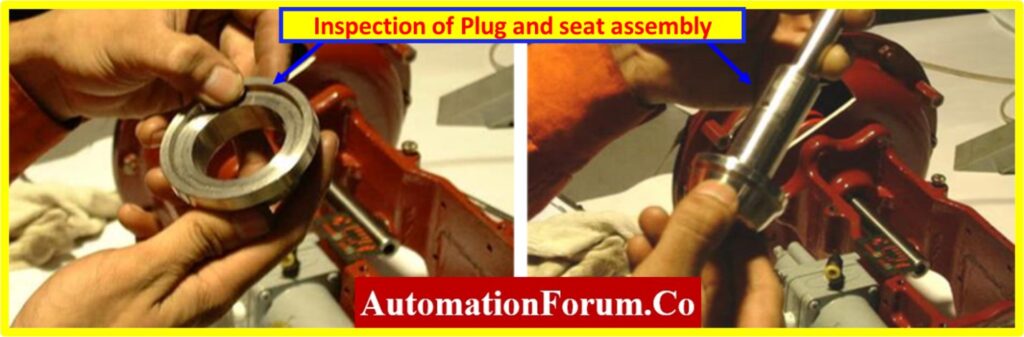

Inspection of control valve body seat and trim assembly
- Look for wear, scratches, erosion, or other deterioration on the seat. Check the valve for any cracks or deformations that might compromise its ability to seal.
- To make sure the seat is firmly secured in place, check its tightness. Leaks or improper valve closure may result from loose seats.
- Examine the internal discs, plugs, cages, and other portions of the valve trim for wear, damage, or corrosion. Check for any alignment issues or overly large clearances.
- Make that the trim parts are assembled correctly and are in good shape. Make sure that all of the fasteners are secure and that no components are missing or loose.
- Verify the trim materials’ suitability for the operating environment and process fluid. According to the requirements of the individual use, make sure the trim materials are corrosion and erosion resistant.
- Check the trim components’ clearances and alignment to make sure they are in the right positions for appropriate sealing and flow management. Leakage or reduced performance may be the result of incorrect clearances or misalignment.
